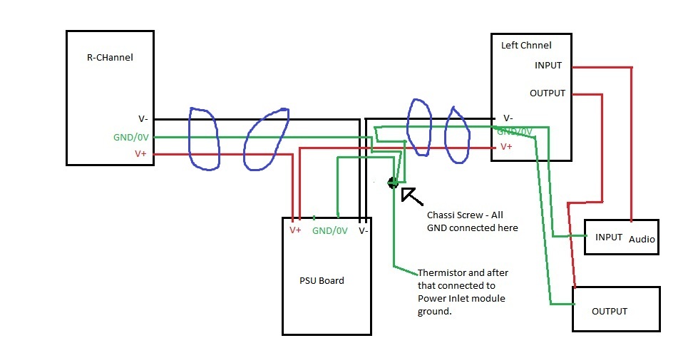

But you must NOT insert any resistance into the PE connection !!!!!!!!!
Connect the PE wire direct to the Chassis/enclosure permanently.The Protective Earth (PE) wire goes direct to Chassis - PERMANENTLY !
