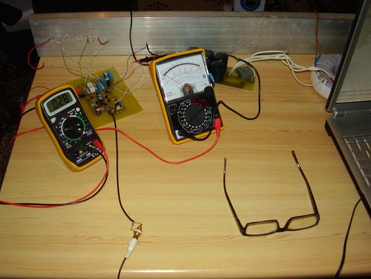

Progress report:
WOW! this amp sounds wonderful!
It wasn't easy to adjust the bias because of the 5k pot, but I managed to set it by gently tapping on the screwdriver clockwise rather then turning it.
I only listened to it at a very low volume (approx 1-2V AC on the output), It's to late now to drive it any louder. Can't wait for tomorrow morning to listen to it properly.
Thanks Karl!
I'll have more info, on how the amp sounds, tomorrow.
Well done, that's excellent news.
Try and get a fixed resistor installed for the pot. If you can measure the pots value as you have it set ( say it's 200 ohm ) try adding a 270 ohm across the pot and then readjust.
It will make it much less critical. The actual value of current you set is not at all critical but 100 ma is about right. The value will alter slightly as the outputs warm but with them being lateral FET's you won't get any runaway -- the bias will tend too fall rather than rise.

I've attached the a PIC of the amp, the FETs were already warmed up so the quiescent current has dropped to about 92 mA.

That looks a nice chunk of metal for the heatsink. Keep those leads short and direct to the FET's don't twist them together.

Yesterday I connected the amp to a high efficiency Monitor Audio speaker and although with the previous speaker I couldn't hear any background noise I can clearly hear a radio station if I put my ear to the tweeter.
Any ideas where I could be picking up RF?
Thanks.
Tibi.
Hi Tibi,
We wondered where you had got too
Picking up a radio station, that sounds an old fashioned fault. Are you near any powerful AM transmitters ?
Have to put my thinking cap on for that.
Just off the top of my head, it's most likely being picked up on any input wiring. Is it there if you just connect say a 10K across the input and nothing else. Strange though, that 150 pf cap should stop that anyway. But try it !!
Is it possible it could enter via the speaker leads ? In the end didn't we say that we would try it without the output inductor. Maybe try a an output coil ??
It's really going back to basics with this, to be honest it's the last problem I would have suspected. Trying to think back, the cause is that the AM radio signal gets demodulated usually by the B-E junction of the input stage. Try as I say disconnecting the inputs totally and soldering a 10k or so across the inputs pads on the PCB.

Well the new speaker is definitely connected with a longer cable then the previous one so that could act as an antennae.
And yes I'm about 500m away from a local radio station's emitter.
I'll try adding an output coil.
I'll also try removing the input cable and add an R.
OK I will have a think. It's certainly ( hopefully ? ) not a major problem.
There is the faint possibility with you being so near that the component legs themselves are picking up the signal.
The base lead of the input transistor is the main suspect if that were the case. Some amps used to have a tiny ferrite bead slipped onto the leg.
Just a thought, that's the last thing to try though at the moment, let's see if we can pin down how it's being picked up.

Output coils --- must be air spaced, not very critical, say try 20 turns of enamelled copper wire ( I am useless with wire gauges -- lets say quite thick ) wound in a single layer tightly coupled.
Fit it as close to the amp outut terminal as poss.
If the problem is pickup by components etc this may all disappear if a metal case is used.
