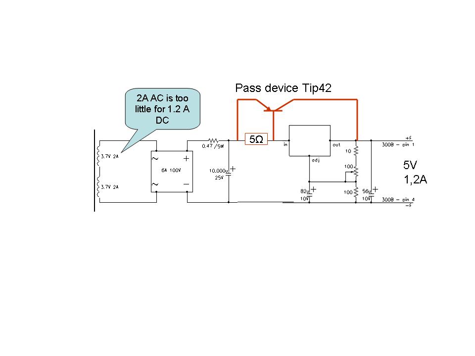

Kevin, the running away can be solved with an extra transistor and a resistor.
This works OK and the voltage still can be regulated. I have used this even for class-A output stages.
Remark: The 2A AC secondary to me is too week for a 1,2 A DC current.
Success.

Hello Triode_Al,
Thanks for the response. Actualy secondary on my trafo is rated at 3A AC. I can see from your drowing that the transistor is PNP. What kind transistor is this (power, etc.)? This is interesting aproach. To update you on what I did last I lower the voltage on input of the regulator to 8V and regulator is runing cool as a cucumber. No problem at all. I don't think I'll need to parallel the regulator with anything. Although the resistor is runing hot but that is to be expected. Thanks.

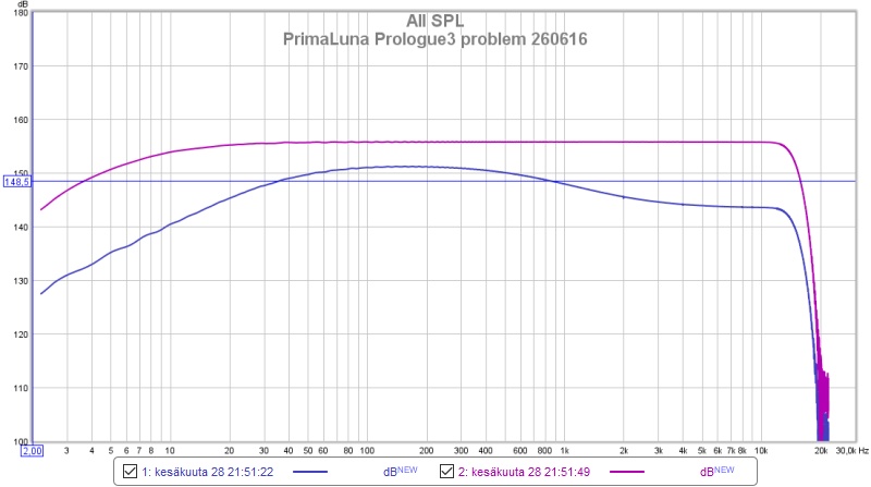

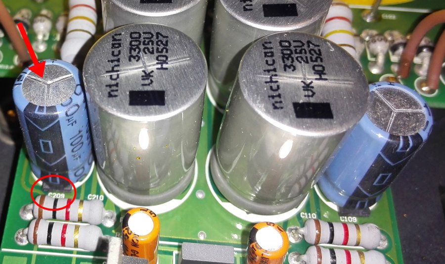

Problem with PrimaLuna prologue 3 preamplifier
I have measured a problem with left channel output - strange response and more distortion. Switching tubes does not change anything. one cap near line out seem to be blown...
What could cause this kind of response change?

Problem solved! My friend changed those C209 and also C109 electrolytes an the amp measured well. At home -same problem. After trying different inputs, measuring my dad output, changing cables etc. I took off the RCA-cable from Line Out2 R channel - it goes to subwoofer amplifier Hypex DS2.0 and it was just that! These line-outs are parallel (impedance 2,8 kOhm) and the input impedance of Hypex is 10 kOhm. http://www.hypex.nl/docs/DS20_manual.pdf
