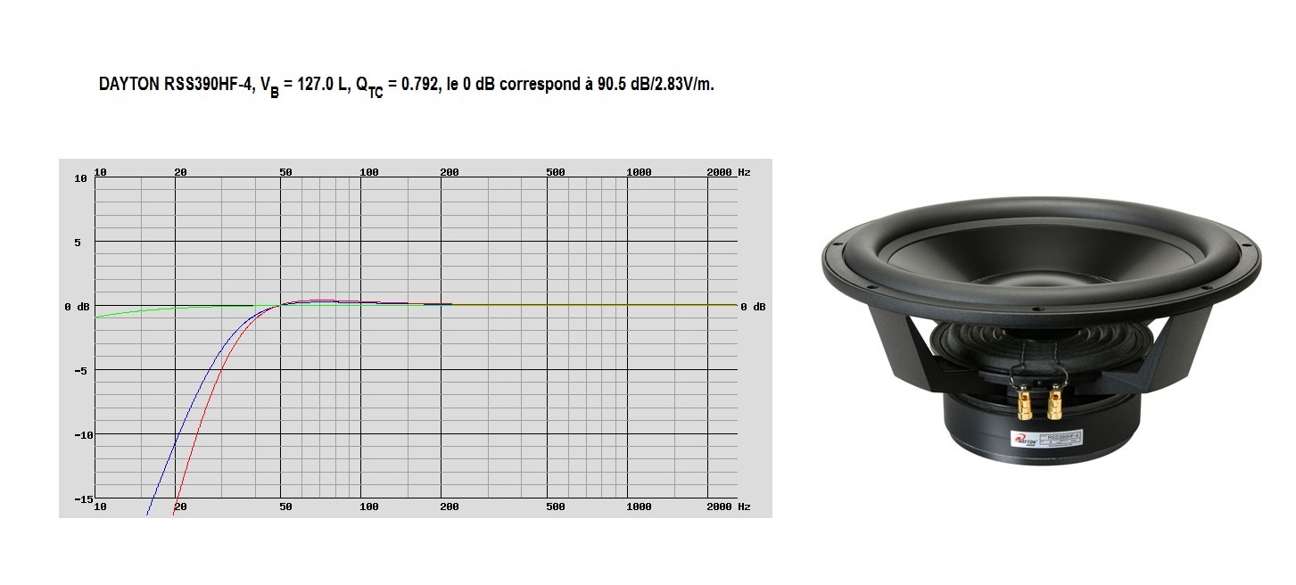

Looks like the the 390Hf can take about 300W with no HPF before excursion issues. I know the BR will take more. I figured it's good to have extra and not push the amp to distortion rather than buying an amp that will just reach xmax at full power. NU1000 wouldn't even reach xmax at full power into 4ohms. Plus, I think with the extra power, the NU3000 is more suited to adding any boost that the 210W NU1000.

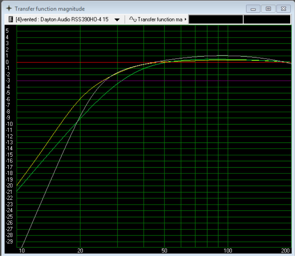

Here's the transfer function of the 15HO ported (gray), 15HF sealed (green) and 15HF sealed with boost at 21 (yellow). Of course this doesn't tell the whole story; the eq'd HF is xmax limited to 110db, no eq HF to about 112db and HO will just get crazy loud- north of 116db. It does show more output down low for equal watts though. This doesn't show HPF on the ported HO. With that in it drops off well below the HF's.

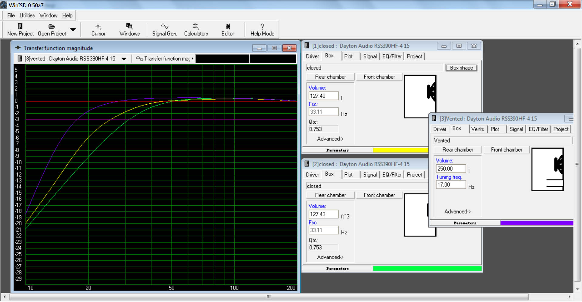

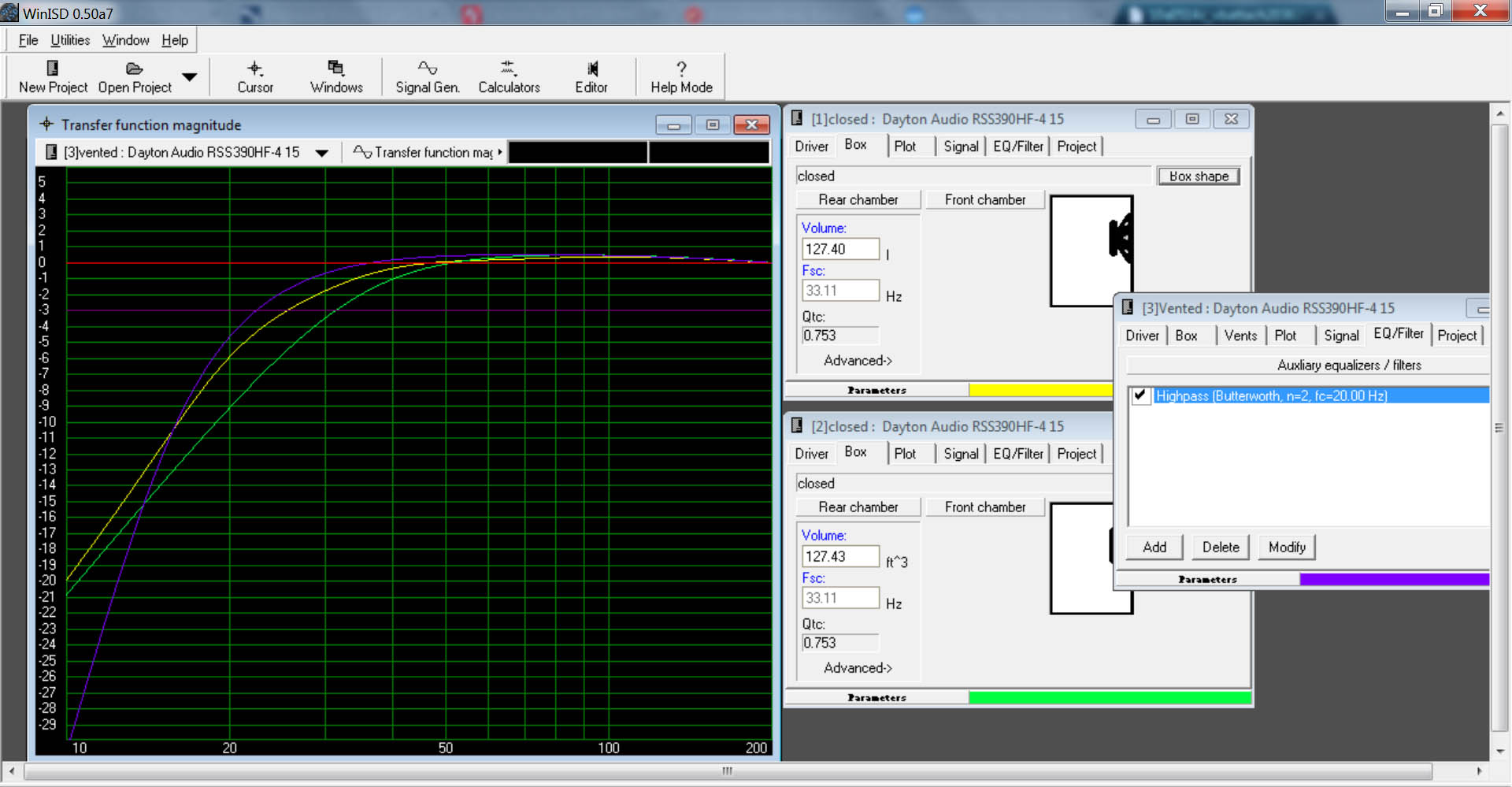

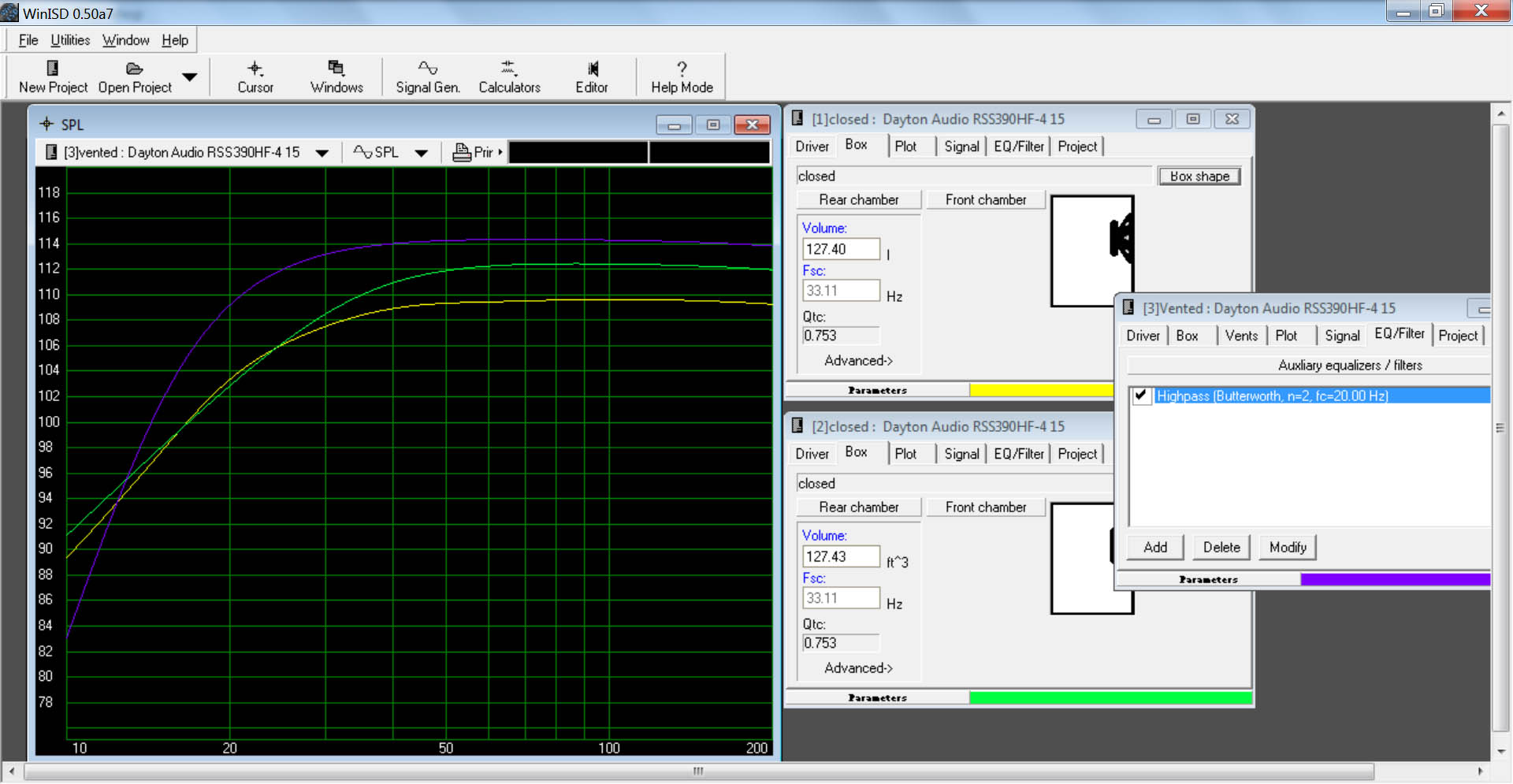

Here are the plots of the HF in ported (250L), sealed (125L) and sealed (125L) with eq applied (3.25db at 20Hz). All modeled with a single driver
Without a highpass filter the ported HF has amazing extension, but no protection and has the same output (xmax + about 10% limited) as the sealed version. With the HPF in place at 20Hz, which is what the NU3000dsp can do, the output is a good few db higher, but the response is pretty close to that of a the sealed HF with eq.
So the decision seems to be between:
HF vented-HPF @20Hz. More output with the same extension as sealed, Large box and I may not be able to add a second one due to size constraints.
HF vented-no HPF. More extension, but same output as sealed. Large box and no protection on the woofer.
HF sealed no eq. Smaller box, multiple subs possible. About the same output, but with much less extension than vented with no HPF
HF sealed with EQ. About the same extension, but less output than the ported box with the HPF. Smaller box.
