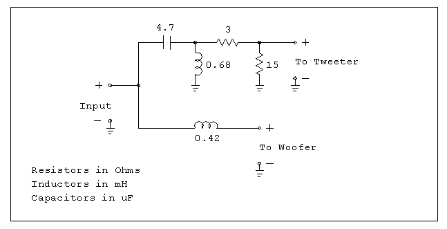

It's easier than you think. You can convert a straight two way to an MTM by wiring the basses in series, and doubling inductance and resistance on the bass filter, and halving capacitance. Double the box volume and ports too. Simple as that! :cool:
The polycone Vifa P17 and D25AG are one of those famous old combinations that works with little effort.
Our own John Kreskovsky designed a complex filter for it years ago. The build link is broken AFAIK, but I saved the details. Marshall Leach did a simpler one: Vifa 2-Way Loudspeaker System

Thanks for the above info :)
The marshall leach crossover is pretty simple, and as mentioned I could add another bass driver. I think in this case, running them in parallel to maximise amp power and then halving the lowpass inductor as well as dropping a few db off the l-pad to bring the tweeter up a bit to suit(maybe ditching the L-pad all together as it is only 3db) I could prototype a crossover and try it on one of my existing JV60 speakers as it's already in the 'shape' of a d'appolito.
Hopefully that should give good sensitivity and it looks as though there's no real BSC in the design which suits me perfectly(the crossover relies on the natural P17 rolloff). Worth a try for the small outlay for one x-over at least :)
I have searched for the John K crossover for ages! Thanks for posting that up too :D I believe it's a much lower x-over point which may work as an MTM a little better due to driver spacing etc. Although it looks a little harder to get the level of the tweeter to be right as it's not a 'simple' l-pad.
