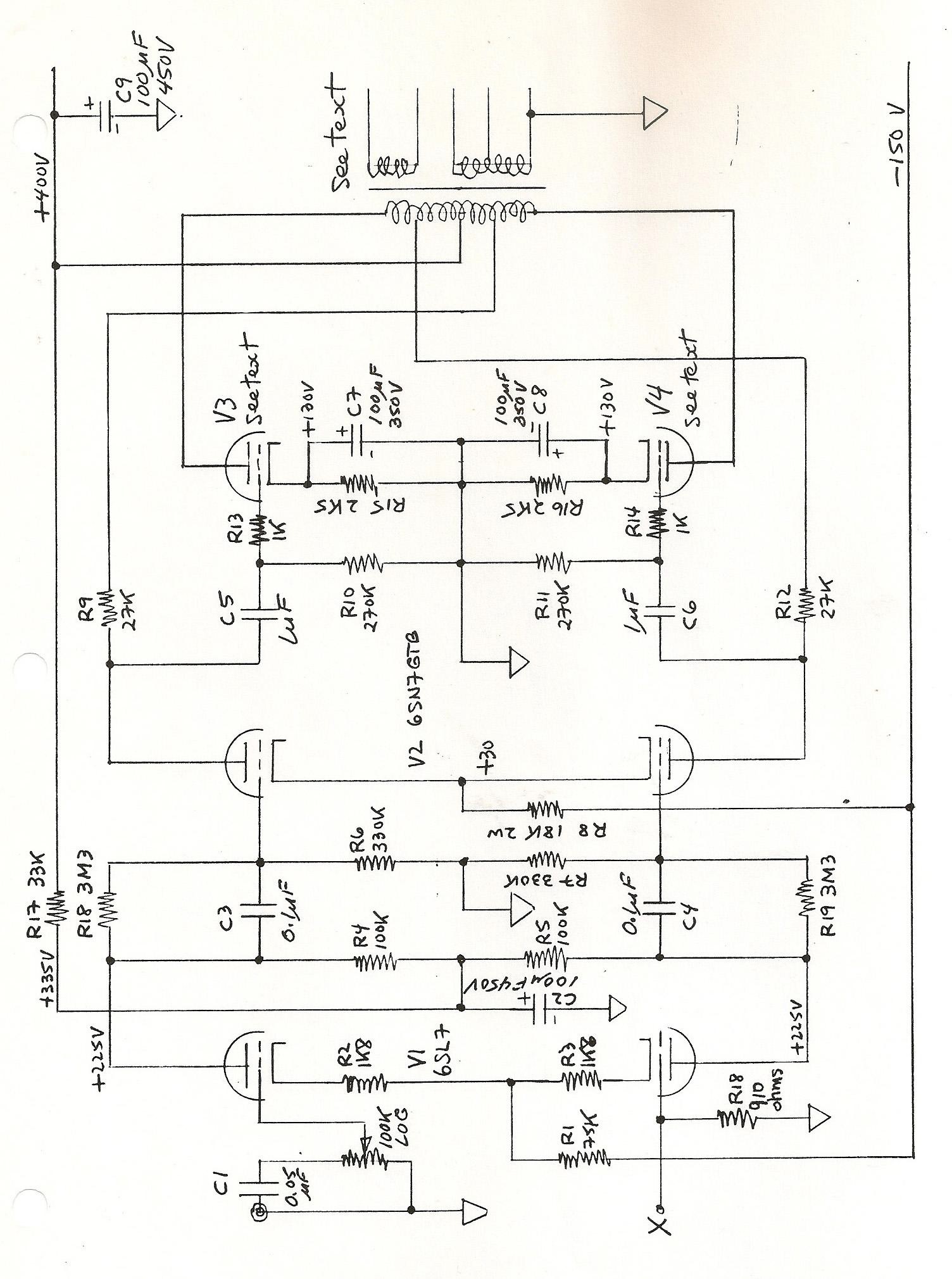

Driving the 6080/6AS7 Made Easy
Hi mus,
This is a kind of bootstrap who was suggested long time ago by John Stewart (another canadian guy IIRW).
The effect is to artifically increase the plate supply of the driver tube excatly like in McIntosh.
Yves.

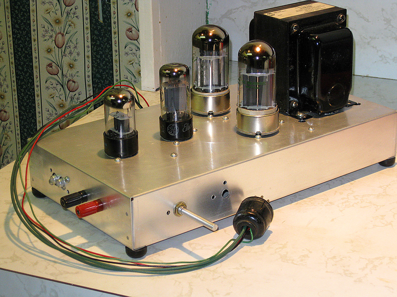

Trying bootstrapping with both 20% & 43% UL OPT's, indicated low mu tubes could be easily driven. I tried the cct with a single 6080 on the bench. The trial looked promising. The final amp using two 6080's is in the attached. It was a proof of concept experiment. I did not complete an entire amp.
As is on a 400V supply two 6080's manage an easy 25W. The OPT is a Hammond 1650N, wound for one half the regular OPT, so 2150 Ohms. Part number is H300429. The DF without NFB measured 3. With 13 db NFB the DF was 15.
An article covering this amp was published in Glass Audio, Volume 11, Number 2, May 1999.

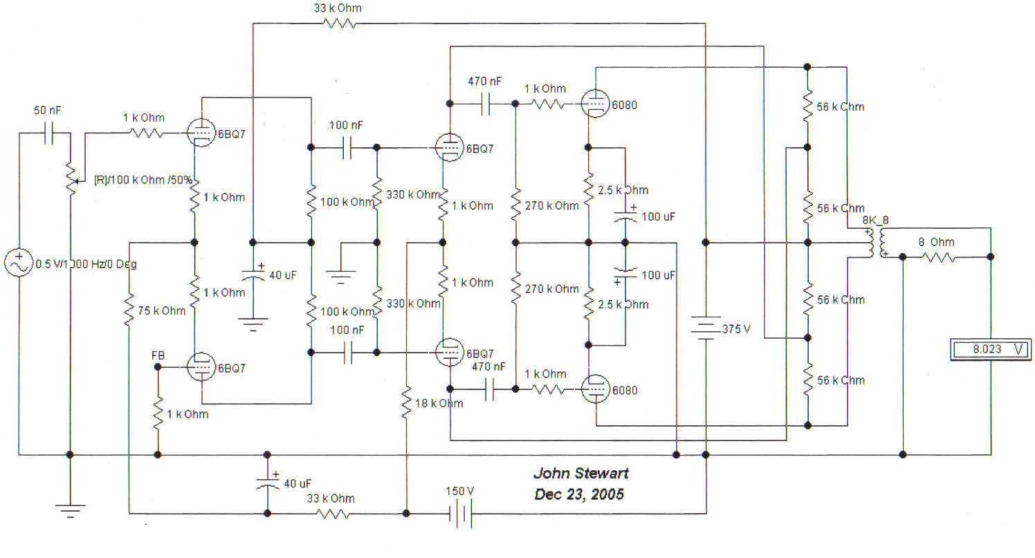

Boot Strapping Without the UL OPT
While working on the bootstrapped drive for the 6080 I realized it was possible without the UL taps. Here it is using an ordinary OPT. This was bench tested & simulated with good results. The bootstrap is 1/2 the 6080 plate signal, the 6SN7 load looks like 28K, bootstrapped.

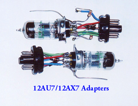

In other trials I'd found the 6BQ7 delivered results near as good as the very expensive 6SL7s & 6SN7s. I had built adapters for the trials. And made the wiring changes to try the 6BQ7s.:)

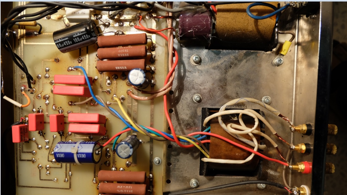

Another look at this thread today I see reference to the circuit I proposed in 1999. But the schematic actually has the gain control hooked up backwards. And as always, no mention of the origin of the bootstrapping.
A few years ago I was contacted by someone who bought an amp based on the bootstrapped idea. The amp had failed, the builder went cheap on the 6AS7 cathode resisters. The amp smoked a bit & almost caught fire. Built in Bankok.
The idea has now been in circulation for more than 20 years, one would think more amateurs would have used it. But people still persist in building complicated brute force drivers in spite of the far better boot strapping system. Some refer to it as positive FB, a circuit they want to avoid. But their reasons are not well documented. I'll add something to this later.:)
