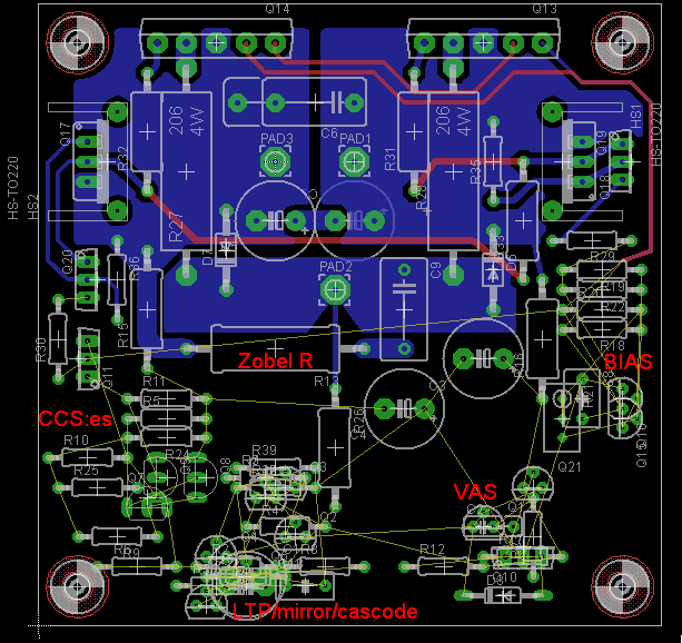

Please comment this PCB layout
Any ideas on the power part of the circuit before I move on to the small signal stuff?
The board is going to be double sided but not plated through so capactiors and similar can only be directly connected to the lower layer, that's the reason there's so little stuff on the upper layer yet.
The output transistors are NJL1302/NJL3281 driven by CFP-connected drivers/predrivers.
It isn't finished as you might see :D
