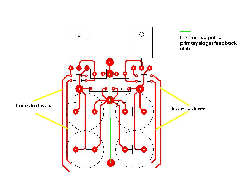

dear eva ....
i actually lost my sleep over this .....
this is what i come up with
------as we said my pcb has to be symmetric( my ""thingy ''')
------ then pcb has to be usefull ( no special heat sink should be required)
------ amp like that should easily fit in a 2U sassi ( use of a 3U sassi is out of the question )
------ there is another must, that psu caps have to be located on board
------and finally pcb has to be kinda versatile so its a drop in replacement to destroyed amps ( mean comapct and easy to work with )
then we have some of your rules
-----one side includes power section caps and power and output terminals, decoupling next to eachother and power transistors ,and then on the other side has to be the small stuff
------mean while star ground is to be preserved
------ and ground traces have to be as small is possible ...
the only thing that i could come up with is this basic schematic BUT !!!!
---------as you can see there is onegreen link that will develop the output to the small stuff area for feedback zobel and so on
---------and also the 2 traces marked with yellow will be used to send signal from the drivers to output section
question is : if you agree with the traces of the drivers runing like this next to power supply then i will proceed with the rest of the pcb

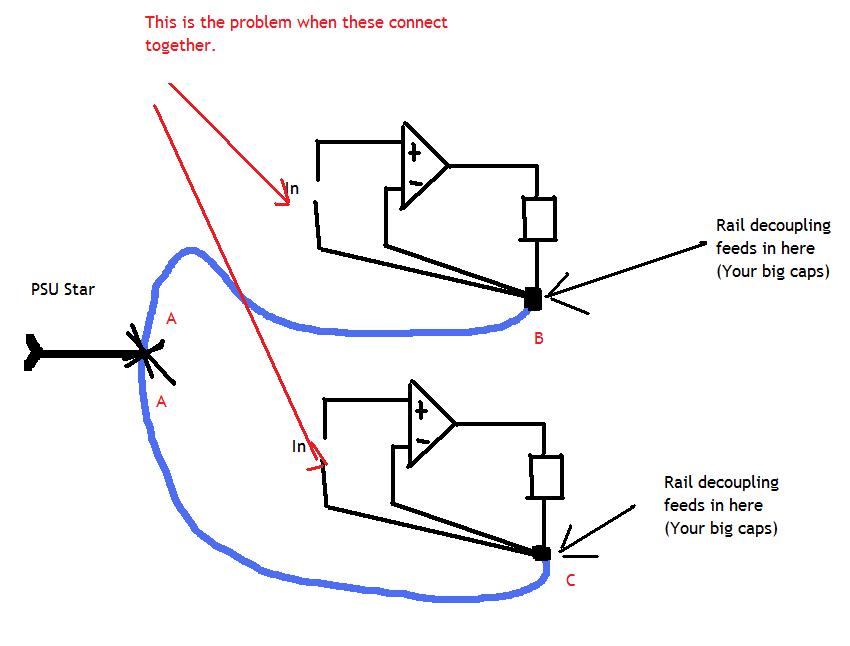

Me again
Two perfect amplifiers. Each on it's own behaves perfectly. Imagine the top one is pushing 5 amps through the load. That develops a volt drop along "A" and "B". Not a problem in itself. If it's music the volt drop will have all the "capacitor current" disturbance feeding into this line. Still not a problem.
The problem is this. The two input grounds of the top and bottom amp are not at the same potential. And these have to connect together at some point.
Do you see what I mean You have no one true reference point. Returning the speaker off PCB is a must. So to is the ground return of the large caps you have on the PCB. The input ground which carries no significant current also has to be refered back to the main star point.

Hi Sakis
Long driver traces are usually better than long power traces, althouth splitting a CFP that way is not a good idea, it's better to split between the VAS and the FCP. But why are you maing the power supply secion so tall? You could make it wider and less tall by laying out the capacitors horizontally to shorten driver traces.
Also, why are you not using the space above the power transistors? Placing them in one of the borders of the PCB is not the optimum solution, why not placing them in the middle and bolting them to the heatsink through the PCB (sandwitching)? These same screws will hold the PCB to the heatsink too, and in case of TO-220 or TO-218 devices electrical isolation of the screws will come for free. I do most of my power layouts that way, which sandwitched power devices spread all over the PCB.
Another important idea: Why don't you use a vertical daughter board for the small signal circuits? this really saves space, makes the layout easier and helps when you have to pack several amplifier channels, preamplifier, housekeeping, etc.. in a single PCB.
For example, see my little 2x120W class-D full range car amplifier (with built in +/-35V power supply). Notice the holes for screws for each pair of TO-220. It measures 17cm x 10cm x 4cm. The design is modular using daughter boards. :
Well, actually you would require heavier clamping of the power devices since your amplifier is class AB and produces far more heat (this little amplifier plays full volume with no heatsink and you can still keep your finger on the transistors without burning yourself). This may be achieved with the help of metal rails or large washers to avoid the PCB bending too much. However, note that I'm using this same mounting scheme for 2400W sinewave inverters and class D where transistor dissipation is not so low and it's working fine too.
Edit: Oh, concerning the grounds, keeping separate signal and power grounds is a must for multichannel applications, otherwise cross-talk and humm and buzz would be severely degraded.

three connections from each amplifier to Audio Ground.Mooly said:The problem is this. The two input grounds of the top and bottom amp are not at the same potential. And these have to connect together at some point.
You have no one true reference point. Returning the speaker off PCB is a must. So to is the ground return of the large caps you have on the PCB. The input ground which carries no significant current also has to be referred back to the main star point.
1.) Signal Ground.
2.) Power Ground.
3.) Speaker return.
Keeping the PCB Signal Ground and the PCB Power Ground separate gives you the best chance to wire up your multi-channel amp correctly.
The feedback line/trace can come from the Speaker Out pad and between each of the cap pins all the way to the other end of the PCB.
I would try to get the route from output device to small decoupling cap to other small decoupling cap to output device even shorter than your present layout.
Disconnect the output collector feed from the V+ and V- pads. Instead connect the collectors to the nearer of the main smoothing caps. The charging pulses coming into the V+ & V- pads to the smoothing caps should be kept separate from the feed to any parts of the circuit.

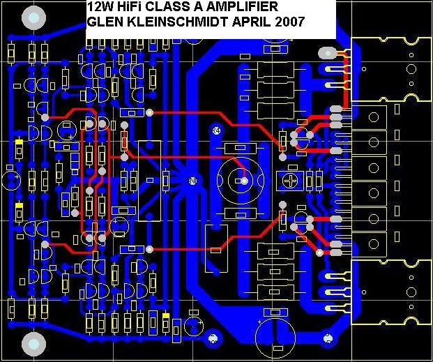

MJL21193 said:The V- and input only appear to be close and the wires that leave the board from these two positions do not / would not run parallel.
The THD figure was a bit higher than the figure you quoted but certainly well below the threshold of audibility. I'll take it.
Practical mechanical layouts in high power audio amplifiers will always limit one to less than theoretically ideal PCB layouts.
But that not always matters too much or is the end of the world.
The not-so-serious design attached below measures ~0.001% THD-20; not so far removed from Edmond Stuart Microcap sim of ~0.0008%, eh?
The transistors are laid out in a line to mount on the moulded mounting tab of the Conrad heatsinks used.
The layout is split between the VAS and the triple EF output. Due to the fact that the transitional miller compensation used is tapped from the VAS collector the collector impedance at HF is at the ohm level. So, the layout is split at a low impedance point – an important consideration.
The output stage supply leads run from the filter capacitors are twisted and run underneath the heatsink mounting tab, but enter the PCB at (Shock! Horror!) opposite sides of the PCB. What really matters is that the small-signal stuff is well away and the power and small signal grounds are not messed/mixed up.

Virtually identical layout here (four output devices this time in a row, +/- supply wires connecting to opposites sides of the board, etc) :

Supply rails are connected and laid out together through the center of the board, and decoupling capacitors are also placed together on the center.
This is a good layout, it more or less follows my guidelines. No wonder THD is low

Note the quasi-ground-plane arrangement: The supply rail traces are on the top side while the speaker output and return traces are under them on the bottom side following the same path to reduce inductance and coupling to small signal circuits.
Edit:
