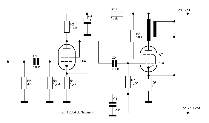

Please comment my F2a SE schematic

The soundcard in a laptop is normally not good enough for hifi. Still if you want to use it, why not build a simple buffer amp with a ECC40?
You can then build a twostage SE with your beutiful F2a to be used with sources having "normal" output levels. Go for something like 6C45, trioded E280F or some of the other good tubes recommended above. You can even get away with the nice 6DJ8/E88CC. But stay away from the, for some unknown reason hyped, 12AT7...... [/B]
I have thought about that, too. I'm just wondering what is the 'normal' line level and what devices use it. :) Is it the 2Vpp of CD players or the 0.9Vpp said in wikipedia or what.
But I'm wondering if it could be possible to build the amp so that you could turn the buffer amp on with a switch, and you could bypass it when you don't need it without making it a separate device..

Ok.. then I could easily drive it with a single ECC40 or E88CC, even without a cathode follower.. which brings one question to my mind: Would it be a bad idea to one half of a ECC40 (or E88CC) for one channel, and other half for the other channel?

Hello Joku,
Btw, wouln't it be a bad idea to use a pentode in a tetrode amplifier? I mean, pentodes have more distortion and all..
Why? You´re running your F2a in triode mode. So pentode drives triode. Take a look at this one.
Also Pete Millet is very fond of pentode drivers. You can find this amp on his page in which he uses a D3a in pentode mode to drive a KT88.
Kind regards,
Martin

Sorry for answering to this old thread, but I have been busy (ie. exchange studying) and I'm now returning to this project.
Anyways, that Neuman's schematic uses F2a as a pentode and I don't have access to the EF804 in quantity. So, that is the reason I would like to use the ECC40 as a driver. I decided to design the amp around a 2Vpp input, so I'll plan to use the first section of the ECC40 as a normal voltage gain amp (gain around 25) and the second section as a cathode follower to drive the F2a. This is my revised schematic:
Opinions? :)
