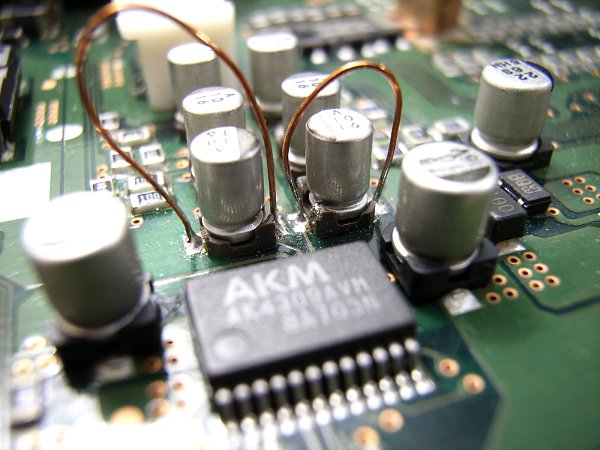

Difficult, yes. But not impossible.
Just to give you a scale: The diameter of the wire is 0.3mm, the diameter of the caps is 3mm.

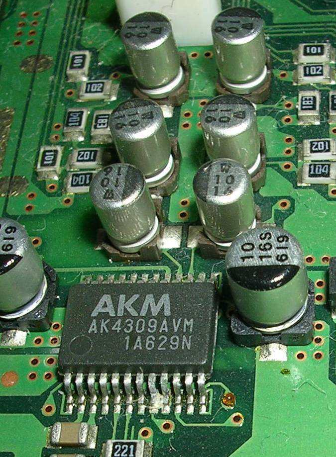

I look at your pics and the 4 pins on the right of the chip are unused.
Since AVM is compatible with B, it would mean that pins 1-10 are the good ones on the datasheet and that 11-20 are 15-24.
They also state that the pin 4 has a function with the AVM but not the B.
So here should be the pinout if I'm right:
1. TST1
2. DVDD
3. DVSS
4. /PB
5. /RST
6. MCLK
7. CKS
8. BICK
9. SDATA
10. LRCK
11. NC
12. NC
13. NC
14. NC
15. AOUTR
16. AOUTL
17. VCOM
18. AVDD
19. AVSS
20. NC
21. NC
22. VREFH
23. VREFL
24. DZF

WOW Mick. So apart from Photography, you build nanobots by hand as well ? As my dad used to say " it takes a steady hand to split the atom".
So .... is it worth it? Was there much improvement ? My experience with an old CD104 philips player was that these caps did make a big difference to the sound.

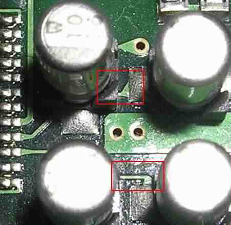

But now that I look at it, there are connections to pins 11-14...
I also found a soldering joint between pins 8-9. :scratch:
What's strange is that in the scheme part here:
http://www.diyaudio.com/forums/showthread.php?postid=774749#post774749
There is no connection to a lot of them. So I guess my pinout is OK. Maybe the NC pins are grounded?

The solder joint between the two pins are I2S signals...
It works even if both are connected together. But maybe that's why I have to restart the PSX a couple of times to get sound. :scratch2:

It was not that much work. I used a small solder tip and the whole job took about 15 minutes. It is fully reversible also.
I did this on a spare board (the one that I fried). I do not intend to run it like this, as I dont have input caps on my amp.

i just finished bypassing the caps.
there is big improvement do your best guys.
it sounds more detailed and more musical
a lot more.
and check out one thing.
my ps1 is the scph 5502.
i may be just lucky but i bypassed them under the pcb.
only the akm is surface mounted on my not the caps.
it was hard to find the points under the pcb but i did.
look carefully and triple check with the multimeter.
maybe it`s because of the model but give it a try.

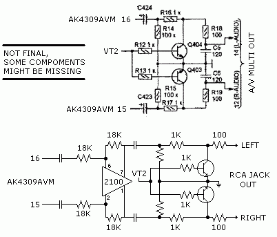

OK so here's the output stage scheme of the 1001.
VT2 is what controls the muting transistors.
The only difference with the RCA jack compared to the A/V MULTI OUT is that there is an opamp. The schematic after the opamp's output is an exact copy of the a/v out scheme. I'm just not sure about the small caps directly @ the output connecting to ground.
Anyone here with a model without RCA jacks, is there only one pair of caps after the DAC? There is no opamp also. Am I right?

Maybe your fried board just has a dead transistor or opamp. Have you tried the AV out?
With a stock board, I think that the A/V OUT is the best : The signal passes thru only one cap while the RCA jacks pass thru a chapo opamp and two caps. The traces are as tiny for both. The only advantage with the RCA jacks for now is the interconnects. The AV wire made by Sony seems pretty thin, but it's one of the best console A/V wire I know.(It didn't break, I broke two Nintendo cables in the same peroid of time)

mick f `s sheme is correct for mine (5502) but it`s not the same for all models the 75xx 95xx and ps one don`t have opamps at all.
Mine or the one Mick posted which comes from here:
http://www.methe-family.de/cd.htm
i guess opamps are good because the german guys say the older the better sounding.
Well that's what everybody tell but an ordinary JRC opamp is not the greatest I think.
