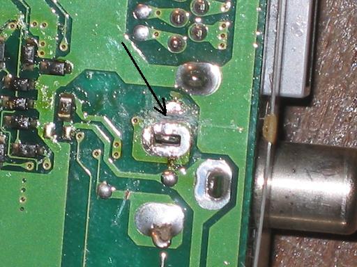

Hi Mick,
i looked on your HP and i think there is a failure. If you disconnect the conducting paths like you've done there is a connection between the red RCA and the little component which suums the signal to mono. It not helps to disolver the caps upside.
I think it's better to disconnect the line shown on the picture below because we don't know what this little think makes with the Signal
BR Dommi
BR Dommi

Dommi said:Hi Mick,
BR Dommi
Dommi, I have taken account of that. Instead of scratching the trace on the bottom, I found it easier to remove the little cap on the top of the board (see pictures 4.3 and 4.4
on my site . If you remove that cap, the RCA is completely disconnected from the circuit.
Mick
