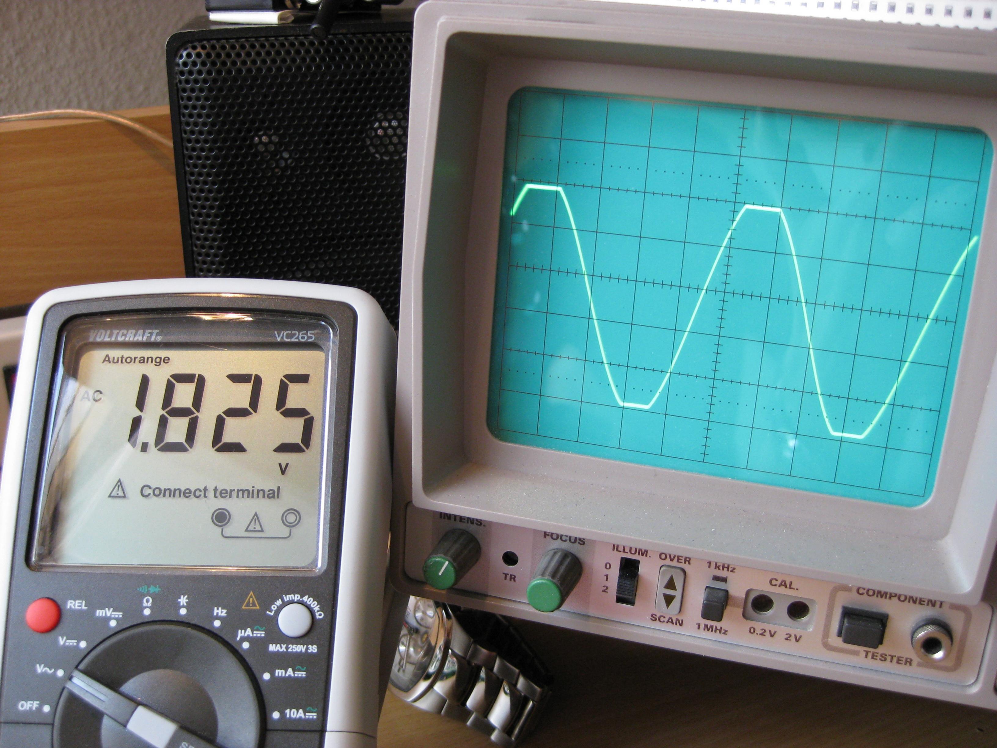

where is the relationship between the distortions that Kovas describes and the shown output filter?

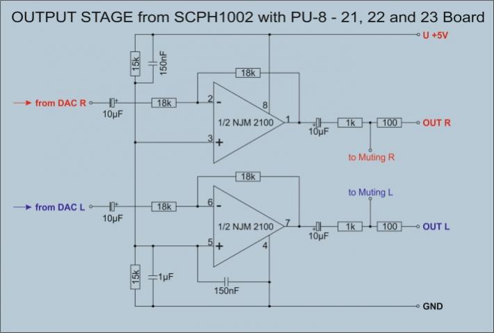

Hello @Pg2005,
I can not find the exact plan for @Koveras modification.
I made the first experiments in 2006 over 2,0 Vrms.
I also had this problem first.
The output filter takes some power, definitely.
So I wanted to direct from cap (from opamp) to the RCA.
But the OpAmp oscillated with about 100 kHz, with filter but not.
The Oscilloscope showed the 100 kHz at the 1000 Hz measurement is not at the same time.
I had it then measured with a frequency meter.
For other performance I have other filters.
The choice of resistors for the OpAmp is crucial.
Large resistors disturb more.
I build smaller resistors than the original.
In 22er board with one OpAmp I take up selected 18 k up maximal 18,2 k.
And for the bottom 11,5 k minimal 11,4 k at 2,0 Vrms.
And I have good experiences with this.
(Step Up Converter before the output stage? - I do not.)
I prefer a different approach.
Greeting Cochise

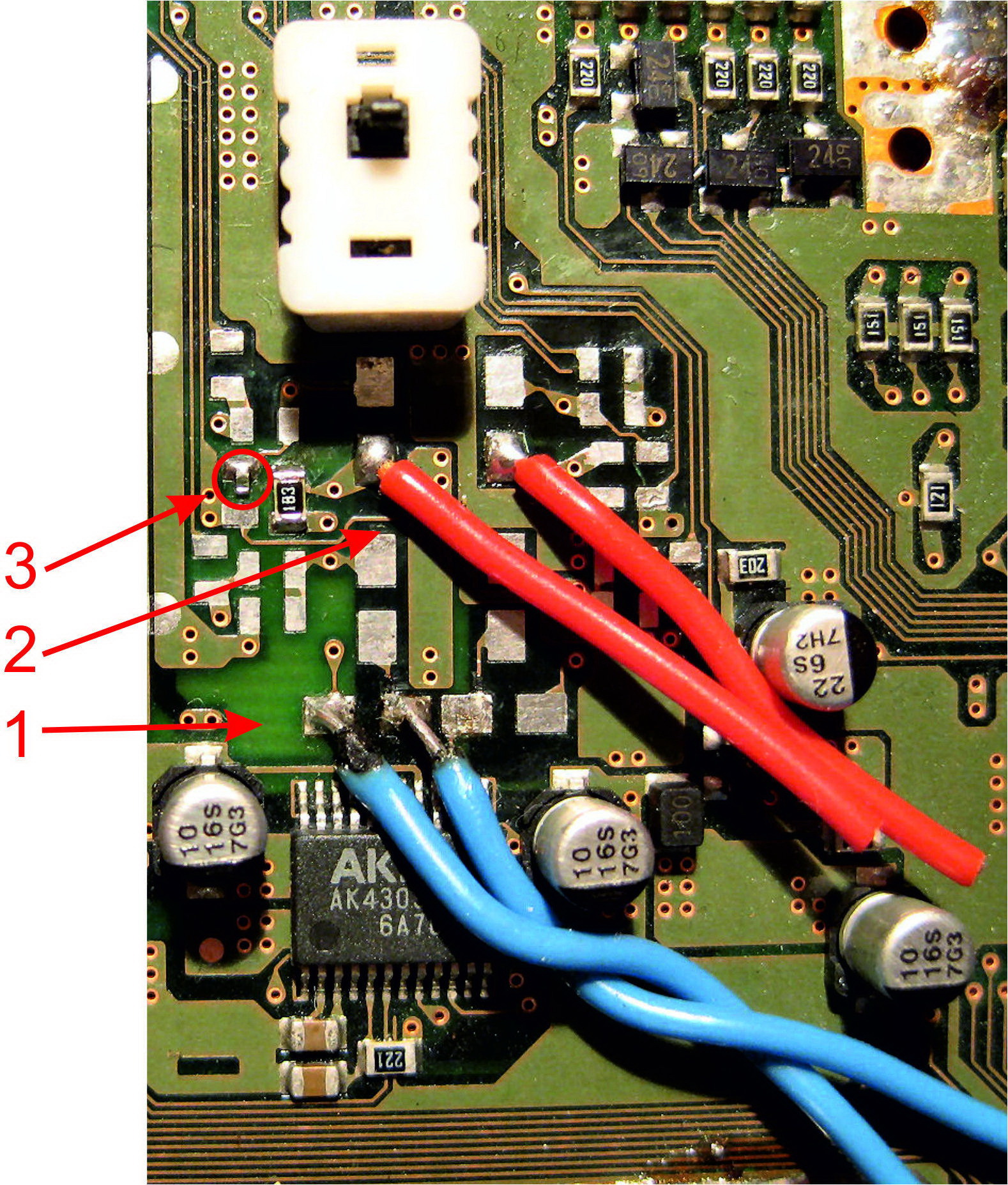

I read about your channel separation and it makes sense to me. But when I look at your pictures (especially the first one) I am asking myself if the 0-Ohm-resistor at the right side on the top has to be removed because it bridges the right and left audio channel?

I need some help troubleshooting. I think my trouble may be related to impedance (mis)matching.
When I first replaced the output stage, I was disappointed to hear some high frequency distortion over top of the Mahler I was playing. I checked and rechecked the solder-joints. No errors.
Then it occurred to me that I hadn't taken Mick F's final piece of advice, that is, I had not taken the input impedance of the following stage into account. His choice of 22k resistors was based on the 22k input impedance of his own preamp.
My integrated amplifier is a Topping TP60, which I used for some time with pleasure. The owner's manual does not give the input impedance, but an internet search suggests that it is likely about 100k ohm.
I decided to replace the 22k ohm resistors with 15k ohm resistors. (Provided that the input impedance of my TP60 is approximately 100k ohm, the total impedance with the 15k resistors is 13k.) With the replacement, the high-frequency distortion is effectively gone. The sound from the CD player is clean and pure. But the volume knob is now cranked way up, which is new. I've lost much of the loudness I was accustomed to.
Here's my question: If the input impedance of the integrated amp is 100k ohm, what sort of output impedance should I be aiming for with the PS1? What sort of total input impedance is desirable?
There are various things online about impedance matching, but I can't find anything like a clear answer to my questions.
I'm just trying to get the best performance from the output stage modded PS-1 with my integrated amp. I'd be grateful for any advice.
