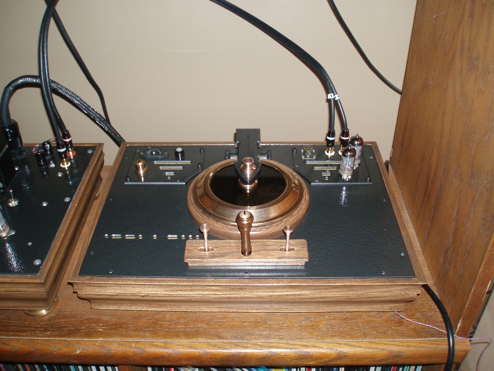

Modded PS1
My tubed PS1 is done.Much thanks to this thread for circuits and ideas.
