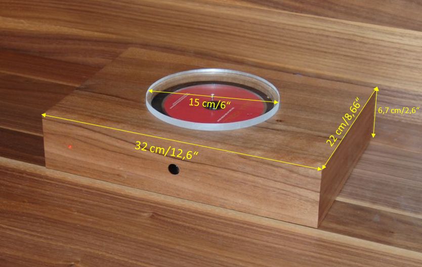

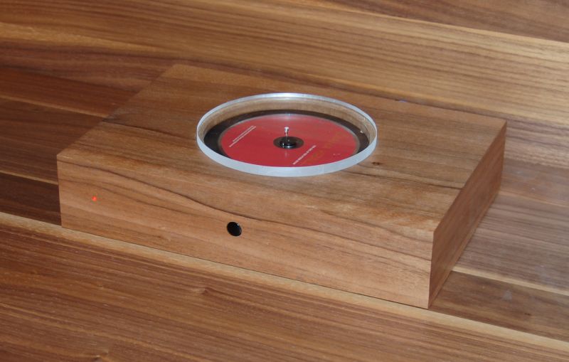

I recently finished my new enclosure for the PS1. It now fits very good to my lowboard. Like a chameleon .
Perhaps a new power supply would bring some improvement...
Supercool!!
Nice
Perhaps you can share the specs of how you do it? and give a details of materials.
Tolu
Very nice and minimalist.
Classy

Do you mean the enclosure or the planned power supply?

Sorry not to mention it, I mean the enclosure and pls kindly make another pixs on the inside.

enclosed are the measures. The case is made out of 0.2" MDF for ground plate and frame. The top is made out of 0.5" MDF. The circle is made out of transparent acryl (PMMA). The veneer is french walnut. The coating is done with Danish oil.
Pictures from the inside are momentarily hard to made because of time issues. The original PS1 top is omitted. The rest is mounted on the ground plate that is fixed with alu angles. I can make some more pics of the top and the back if you like.

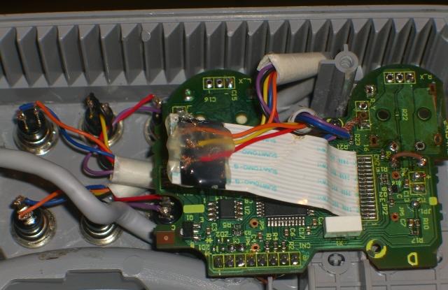

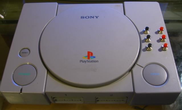

hi everyone,
just bought a ps1 few days ago... decided to add some buttons to it. first time doing any soldering... so pretty happy with it. any suggestions for mods of similar difficulty? i'm a starving university student, so i cant spend too much. i wonder how much of a difference a better power cable would make? eg. ps audio xStream power punch c7...
heres some pictures of my mod (its a 5502)
