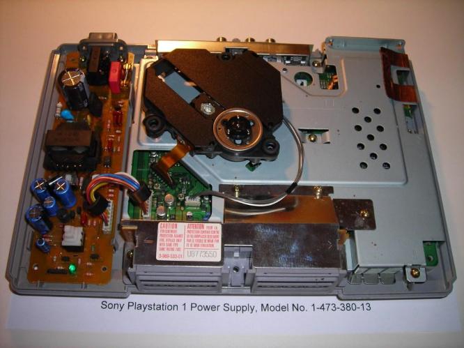

During the holiday break, I had some time to upgrade the caps in my Playstation 1's power supply. Referring to Post# 1631 in this thread, I contacted Greg Stewart and he gave me some good advice about improving the stock power supply. I ordered some Nichicon caps from Mouser and replaced the stock caps. I mainly used Nichicon KT and KZ "audio" caps. The larger filter cap is a Nichicon CS with a high ripple current spec. I also installed some .1uF/250V Wima MKP10 film caps on the AC input. Here is a photo of the SR670 power supply in stock form:
Here is a photo of the same power supply after the cap upgrade:
I've allowed the power supply to burn-in using some test CDs and after about 50 hours, I've noticed a considerable improvement in terms of a larger soundstage with better defined placement of instruments and vocals, greater dynamic range, lower and better defined bass, and greater detail.
I had already modified the output stage as mentioned before in this thread. I was satisfied with the upgrade there, and now I am very impressed with the improvements with the new power supply caps. I am considering an upgrade of the rectifier diodes to some IXYS HEXFREDs. So far, I've only spent $5 on the power supply caps, and the diodes will cost an additional $20. Thanks to Greg Stewart for the help.

Rich, when you have a chance, it would be helpful to have the values and maybe the part numbers along with which specific parts you replaced. The photo is kind of dark and I can't read all the values off the sides of the caps, especially where they're printed on the back side (funny thingie here).

Buckapound said:Rich, when you have a chance, it would be helpful to have the values and maybe the part numbers along with which specific parts you replaced. The photo is kind of dark and I can't read all the values off the sides of the caps, especially where they're printed on the back side (funny thingie here).

I've included BOMs from Mouser (Nichicon caps) and Digi-Key (Panasonic caps) depending on preference. I went with Mouser, because I wanted to try the Wima MKP10 caps on the AC input, but I am sure that the Epcos MKP caps are fine. Certainly, the Panasonic FC and FM caps would be good in this power supply. I still haven't installed the IXYS HEXFREDs, but that will be soon.

I also intend to replace the cheap PVC-insulated DC power wires with Teflon-insulated Silver-plated Copper wires. I just found some break-away flat cable connectors that Mick Feuerbacher describes in his Web site.

SR670 and 1-473-380-1x do refer to power supply board models. It appears that Sony made quite a few different power supply variants, and I've even seen identical power supply board models with different branded caps along with other different components. For instance, a friend's Model No. 1-473-380-13 PSU PCB has all Panasonic FC caps on it, while mine had less expensive Nichicon and United Chemicon caps. Who knows what Sony did with component supplies on the motherboard. I believe that might be part of the reason why some report that they really like their Playstations and others don't. Anyway, for the electrolytics, I arbitrarily picked the next higher capacitance value with the same or higher voltage rating. I also kept in mind the diameter and height (i.e., length) of the caps to insure that they would fit. The same applies to replacing the MKT cap at the AC input. I chose Wima MKP10 caps that had a 10mm or 15mm lead spacing, housing dimensions and the same or higher voltage rating (e.g., 250V) that would fit. The power supply board really doesn't provide much spacing between components to allow for more experimentation. I should also note that you should reference manufacturers' data sheets for component dimensions and not distributors' catalogs or Web pages. I found many errors in Mouser's Web pages, especially with the Nichicon cap dimensions.
I already referenced previous posts regarding the replacement of rectifier diodes. The IXYS HEXFREDs were recommended by Greg Stewart, but he has not actually tried these particular diodes in his Playstation. He used the Stealth soft recovery diodes in the rectifier with film caps. I have not tried the IXYS HEXFREDs since I like the improvements that the caps alone have made, and just want to listen to music for the time being. Perhaps I'll try it some time in the future, but I have a few other projects I need to complete like my PassDIY B1 Buffer and modded Sure Electronics T-amp.
I should mention that modifying the signal output stage per Mick Feuerbacher's Web site yielded the most significant improvements in sound quality, especially after the 4.7uF/50V Black Gate N caps and 22k PRP metal film resistors I used had many, many hours to burn-in. The power supply cap upgrades made slight improvements much like using a better power cord. I am sure there are those on these forums that would debate this, but that's what I hear. I still think the $5 or so investment is worth it. I like classical orchestral music, and the crescendos peak with greater dynamic range (i.e., no compression or disintegration of the soundstage).
