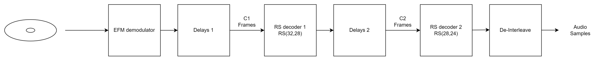

After watching Technology Connections video about audio CD:
I thought that it is actually not that hard to decode raw bitstream from an audio CD to get audio samples.
How hard could it be anyways, it is technology from more than 40 years ago, right?
So I started looking into it and first obvious things to do were:

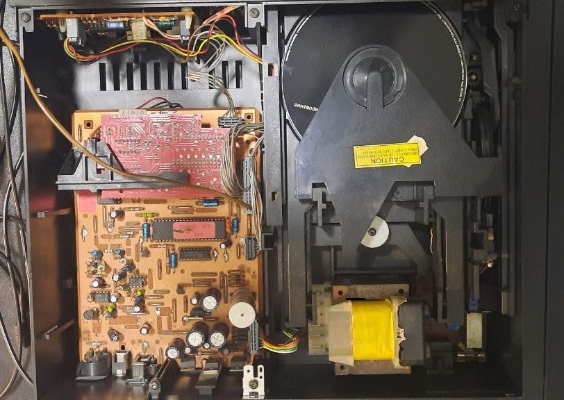

1. Get an old philips CD player so I can get access to raw signal from the laser head
2. Read the redbook standard
3. Implement the decoder
Looks quite straitforward.
The first item was easy - I happened to be in the Netherlands so I got old Philips CD-160 at nearest kringloop for 15 Euros.
Second one is available online:
https://archive.org/details/RedBook...stemIEC60908SecondEdition199902ISBN2831846382
The video actually does a good job of explaining the high-level picture. Some diagrams do look horrifying at first:
But actually it is just a bit of data manipulation and two Reed-Solomon decoders.

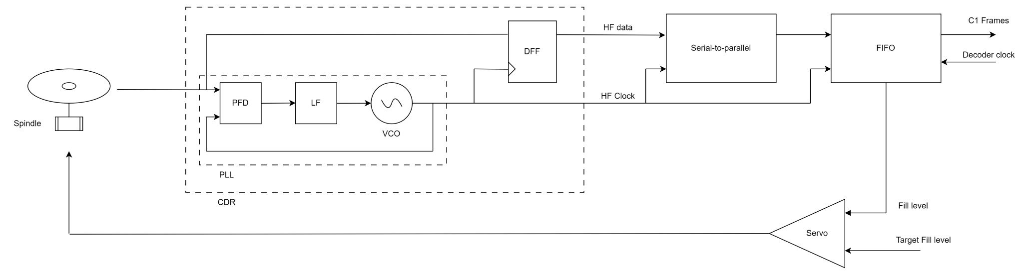

You need a motor speed control, that is some kind of PLL, also a memory for intermediate storage of data. All these and the error correction, subcode processing, etc. are implemented in a single chip. What extra do you intend to add? It could be interesting for education purposes.
Let's go step by step.You need a motor speed control, that is some kind of PLL, also a memory for intermediate storage of data.
First, the initial task with the HF signal (the term referring to the signal from the photodiodes in the standard) is to recover the clock so that the data can be correctly sampled. It's important to note that at this stage, the signal is analog.
This process is known as Clock and Data Recovery (CDR). There are various techniques for achieving this, with one of the simplest methods (commonly used in older CD players) involving a PLL (Phase-Locked Loop) that synchronizes with the incoming data stream. However, for the PLL to establish a reliable lock, the data stream must meet specific requirements, notably having a minimum number of transitions within a given unit of time. Failure to meet this requirement can result in the PLL losing lock, leading to data recovery failure.
Additionally, there needs to be a secondary loop to regulate the speed of the disk rotation. This is typically implemented at a higher level using a servo loop. After the serial stream is converted into parallel data packets (frames), they are stored in a FIFO (First-In-First-Out) buffer to ensure that subsequent stages of the decoder can access them as needed. This essentially creates two clock domains: the data is written in the HF clock domain and read in the data decoder clock domain. If the spindle speed is too low, the FIFO may become empty, while if it spins too fast, it may overflow. Therefore, the task of the servo loop is to maintain the FIFO fill level at the desired value, for instance - 50%.
All that is part of the decoder, yes. Currently I limit scope to the data decoder only, including subcode. The extra things that I want to see is how often the C1 and C2 frames errors really happen in real life and how effective the RS codes are.
Yeah, defenitely. But at these speeds a schmitt trigger and pair of D flip-flops (to reduce chance of metastability) will do the job.BTW for converting the raw eye pattern to digital stream you need a slicer circuit upfront.
This project amounts to designing the read logic in a disk controller. The PLL is an analog circuit and the rest is straightforward digital logic. 74LS TTL is more than fast enough.
Isn't that guaranteed by the eight-to-forteen modulation? For clock and data recovery, there are various kinds of variants of PLLs, for example a PLL with a Hogge detector as phase detector.

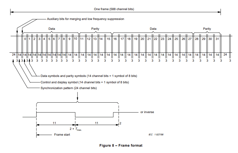

Yes but there are couple more things.
One frame on CD is 588 channel bits long and contains 33 bytes of data. 1 byte is for the subcodes, 24 bytes of audio data and 8 bytes of parity for error correction. After Eight-To-Fourteen (EFM) modulation each 8-bit byte converts into 14 bit word, so the data takes 33*14 = 462 channel bits.
The header patter takes 24 bits. That sums up to 486 bits. And the rest is filled with merging bits:
(Interesting note: there is a mistake in this drawing in the Red Book standard)
The merging bits are inserted after the header and each byte, and their purpose to guarantee that criteria for minimum and maximum distance between transitions in the HF signal are satisfied. The minimum distance is 3 channel bits (shortest possible pit/land), the maximum - 11 (used in the header).
Another thing is that 0s and 1s are not coded by pits and lands but in transitions between them.
Yes, that will be the easiest choice to implement, I guessa PLL with a Hogge detector as phase detector.

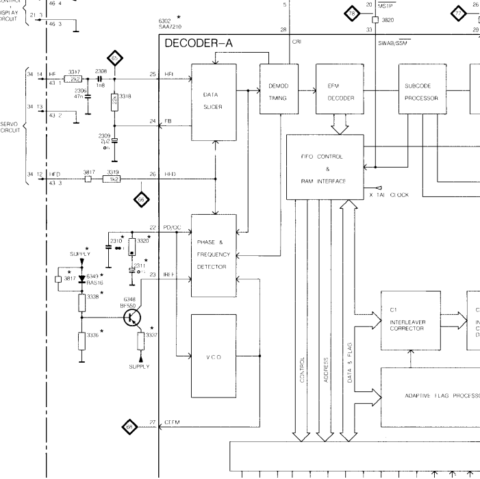

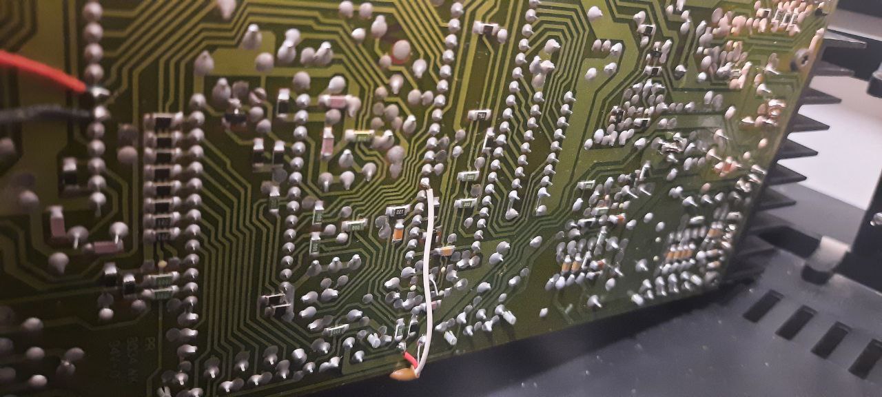

Alright, since my focus is on bitstream decoding, I hooked a cable to my CD160 main board to the inputs of SAA7210 decoder IC:
I need two signals: HF bitstream and recovered clock.
To acquire the data I'm going to use this FPGA board:
It has got 64mbit SRAM, 20 MSample/s ADC and a FTDI chip that would allow up to 3 MBytes/sec transfer to PC.

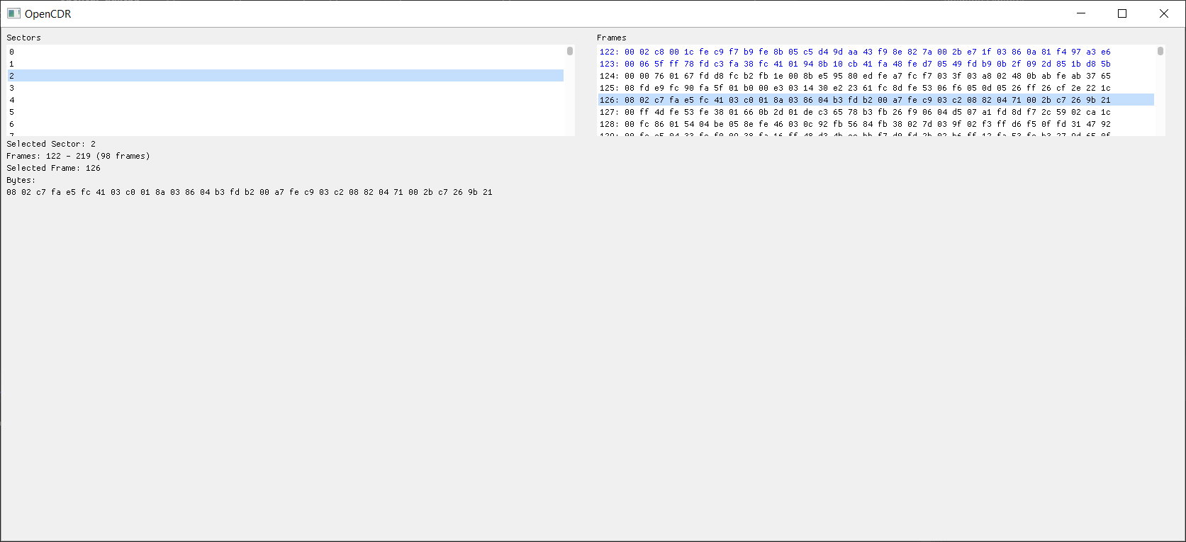

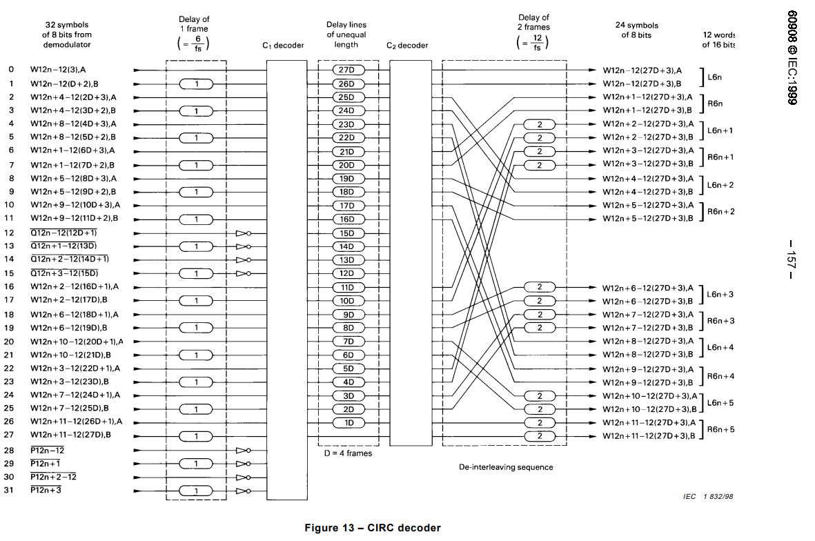

So this is how raw frames from the picture above are generated. The next step is de-interleaving.
I'll post entire project and raw data on github later. It is a bit messy now
