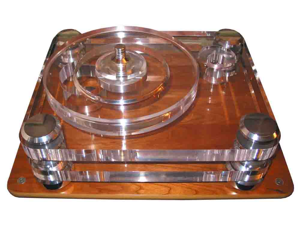

I have chosen acrylic platter from VPI because it was easy to get, came with ring clamp and I could not cut platter or ring myself.
There is one bad thing about acrylic platter: it does not conduct electricity. The platter on my TT combined with plastic belt for Teres motor worked like a static electricity generator. Teres platter users reported similar problem. With VPI belt the static was less audible. I have covered the platter with Cu foil and grounded it, see the picture. It solved the problem completely. I think conductive platter is also helpful in discharging static buildup in LP itself.
For my plinth I used solid cocobolo wood and acrylic for sub chassis. Wood alone (I mean not engineered wood) would be structurally unstable under a load of a heavy platter. If I did not have acrylic for free I would prefer aluminum for sub chassis. The bearing is screwed to the wood and 6” aluminum/lead ring. I use the ring to better drain energy from the bearing. The bearing does not touch sub chassis, see the picture. I think bigger ring like this (with lead cast into aluminum) could be used for a platter.

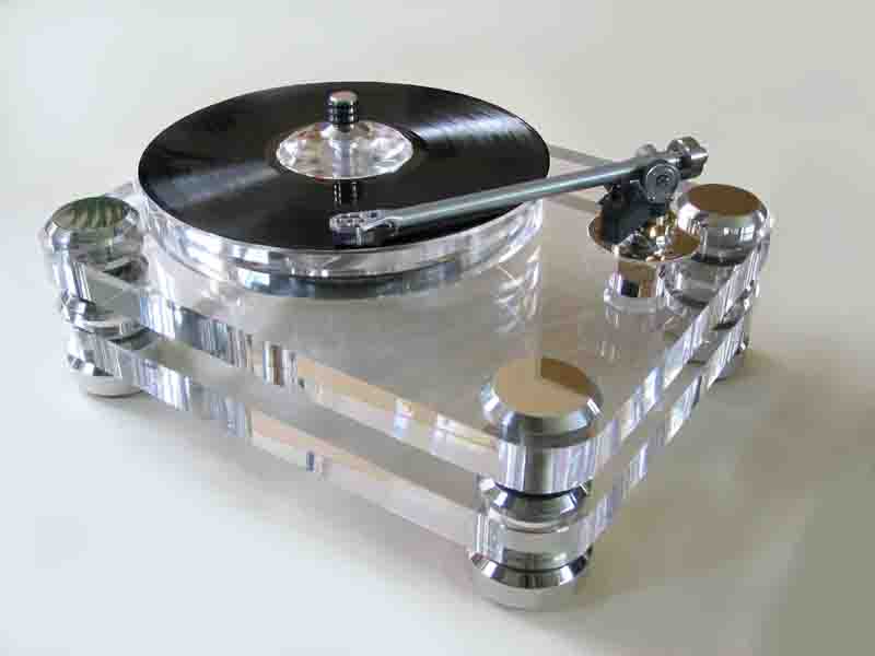

I started a DIY turntable project a few years ago and it hasn`t gotten any farther along yet. I began by fabricating a 2-1/2 inch thick platter out of two pieces of water clear 1-1/4 inch thick bullet proof plastic called Lexguard. These three images show lamination process using 2-part resin-hardner product called Behr `Super-Built 50`. Then the piece was cut in a circle on the bandsaw and mounted in the lathe secured with non-scratching double sided carpet tape between a plate and a small disc with live center. A 1/4 inch pin in the center of the chuck plate inserted slightly into a shallow centering hole drilled in the platter kept the whole thing securely centered. I had to face the right side and re-polish as the thickness of the Lexguard was far from uniform. I was really surprised by this actually! The finished platter runs absolutely true and is shown dropped onto the direct drive motor I was going to try to use which is currently part of my Technics TT.
Yeah I made the brass center weight as well, and that turntable stand underneath that you just see the top of.

This is the norm with acrylic, polycarbonate, or any cast or extruded sheet. You must machine all surfaces to prove parallelism as well as perpendicularity with the bore of the platter.
Why didn't you just buy a 2 1/2" thick chunk of material, would have saved some glue.;)
