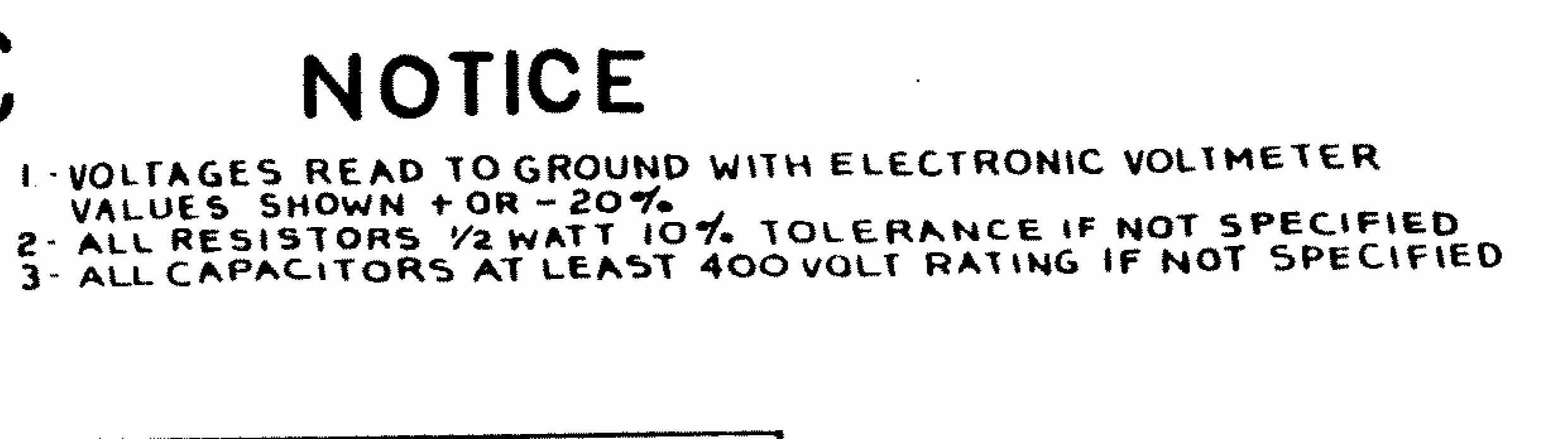

If the caps are bad then you will lose bias voltage ( they are shorting to the outside can and ground). Read the voltage on the terminal, if it is more than 2 or 3% off/under, they are weak or failing. You need to read your bias right before the 220k resistor if there are no tubes in the amp. With tubes in, no signal, you need to be very close to the spec since you are fixed bias.
As for the other items about the screen....it also pulls current and if those screen resistors are off they need to be replaced. If the screens were electrically damaged, then you now have hot spots which can make those plates glow again as soon as some stress is on them...meaning playing. Use them to do your testing, with no load/signal, they should be ok to atleast determine/fix the voltage issue...after than pitch them.

I took a look at it. The power transformer was fried. That is what happens when you run an amp with red tubes for too long. The transformer wholesale was over $100. After replacing it I found the bias was well out of range. The cause, a shorted filter cap in the bias circuit. The cost of the cap under $1.
So replace both caps, get new resistors and replace all of them. The cost of all the new parts will be less than the UPS charges! Not doing it will be way more expensive!
