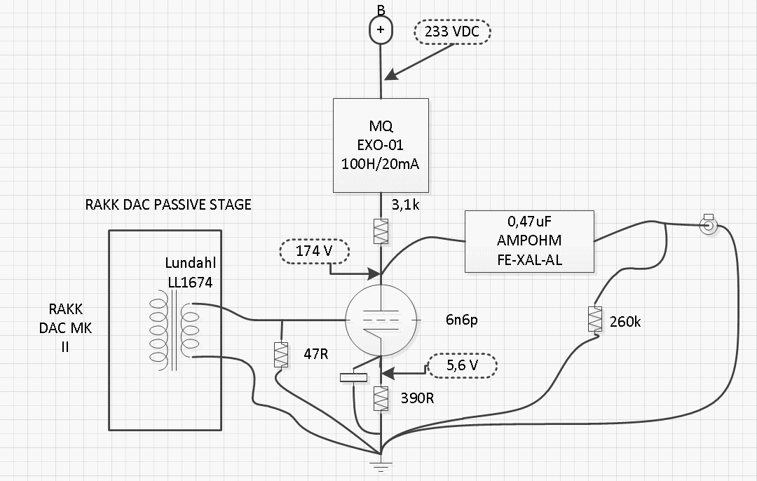

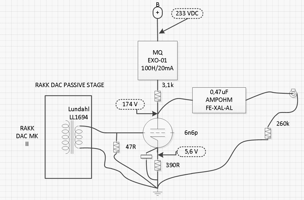

In my case. I decided to add an active stage after the RAKK DAC passive I/V section I have. I first lowered the resistor after the LL1674 transformers to 47 Ohm. And then added a 6N6P SRPP stage.
I got what I wanted in terms of speed. But something was amiss. No musicality. Ripped out one 6N6P and converted the SRPP to plate loaded 6N6P. The sound really came to life.
I'll pick the plate loaded version of the SRPP any day of the week. YMMV, IMO and all that.
PS. Bypass cap is 100uF/10V

Do the transformer and 47R make up enough grid leak resistance? Seems low to me.
It's cathode biased so the resistance in the grid circuit can be anything from zero to the maximum acceptable grid resistance for the type of tube used.

Hi Bass,
I'm working on a similar project. So I need to ask why 47R.
Resistors after the I/V transformer is used to be in the KΩ range.
A good idea would be to replace the anode choke with an output transformer.This would allow to throw away the coupling cap
Well yes, you'd use something in the kΩ range if it is passive. But I wanted the output stage to have a reasonable output similar to that of the passive stage. Maybe it is even lower I'm not sure. This way I guess the final gain is slightly lower than that of a typical cd player output.
I made a drawing error with the 260k resistor. And the I/V transformer is a 1674 ofcourse and not a 1694.
I see, but I think that LL-1674 needs to see much higher impendance. And if you decide to use an output transformer you can still lower the output of the active stage throw the turns ratio.
F.e. LL-1689 allows 18:2 and 18:1 terminations, plus the benefits of lower output impendance.
