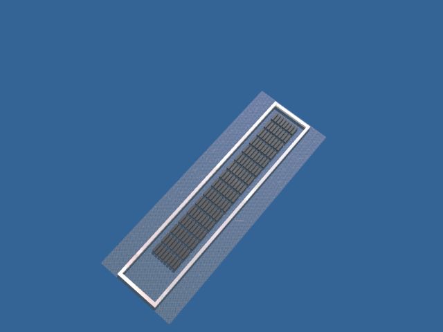

I have decided to built a magnetic driven planar speaker.
Got most of the parts, and the design is illustrated below. A perforated steel plate as I have used in my ESL projects, with 10x10x40mm neo magnets. A alu frame in 1/2" x 1/2" square alu tube provides stiffness and spacing between diaphragm and magnets (distance will be 2,7mm + 1mm vhb tape.
Diaphragm will be 6micron mylar, with 9mm wide CPC alarm tape as conductor (0,6 ohms/meter resulting in a 5,4 ohm dc resistance I should imagine.
Horisontal spacing between magnets will be 15mm, and 10mm vertical spacing.
Outer dimensions of the frame will be 190mm wide and 1000mm high.
There will be 8X18 = 144 magnets pr speaker.
As the back plate is bigger than the diaphragm, it will be easy to mount baffles, and easy to add a ribbon tweeter if I should decide to do so later.
I am very exited by this project, it should be easy to build and hopefully give more satisfying results than my ESL attempts has given so far.
Any comment to my idea? Should i make it wider, bigger/smaller distance between magnets, distance between magnets and diaphragm?
Theese magnets cost a fortune, so I am reluctant to increase the number of magnets in the first test (I have 205 in stock)
All that remains now, is to unite theory with practice and see how it turns out!

THat looks promising, with alll those powerfull magnets. by the way how did you get the tape and what is the width of the tape and most of all where did you get it. i looked like everywhere to get aluminium tape in small width also in the security branche but it looks like they dont use it anymore or something. i still got 4 perf plates with all the magnets of a Magnepan wich i would like to use for something after all the searching
sorry you metnion the width of the tape but with 0,6 ohm a meter this is nice thing foil
I got the tape from cpc.co.uk by recommendation from mr JAMESBOS
They ship internationally but have a rigid ordering system with prepayment.
5 rolls costed me 5 GBP and 18GBP including freight
The tape is 0,006 thick, 9mm wide. I haven´t opened the tape yet, so I am unsure if it comes with a liner or not. If it has a liner it can be rolled out and splitted in half.

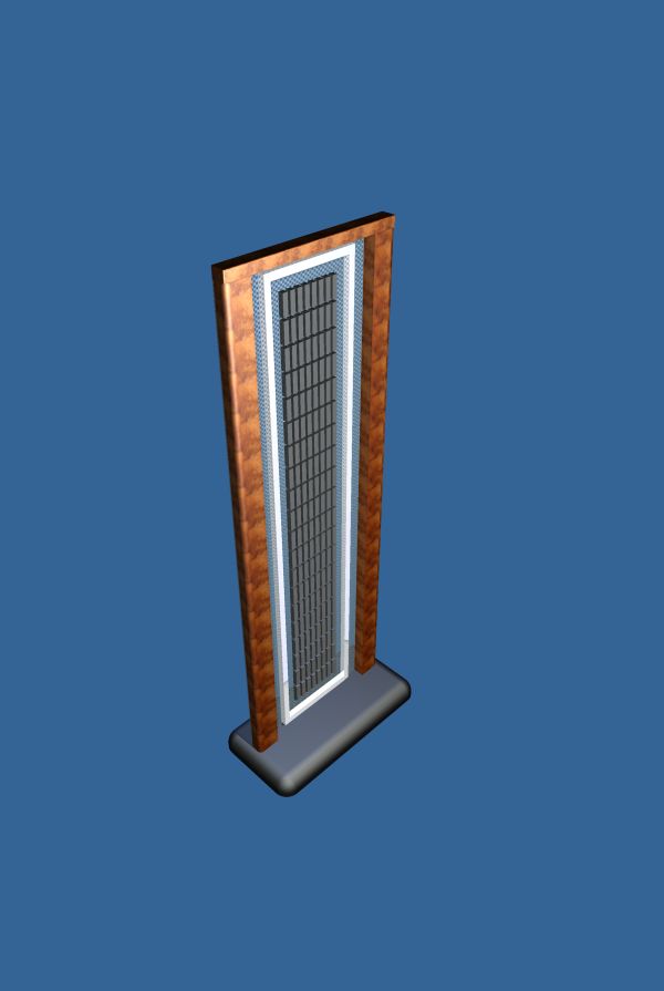

uploading a new illustration on how it is going to be built. I guess I will make the trim out of pine, and wax and polish it in a dark wood colour.
Planning on making a inner frame that holds the speaker grill cloth, and fit it with magnets so it snaps to the perforated plate.
I am planning on casting the base in concrete, the type used on bathrooms. It's on sale this week ;-)
I might have to reduce the widt of the speaker element in order to fit a ribbon tweeter.

nice image,you could raise the element itself from the floor a bit so the high frequency sounds better when standing. nobody listen with there head on the floor so
