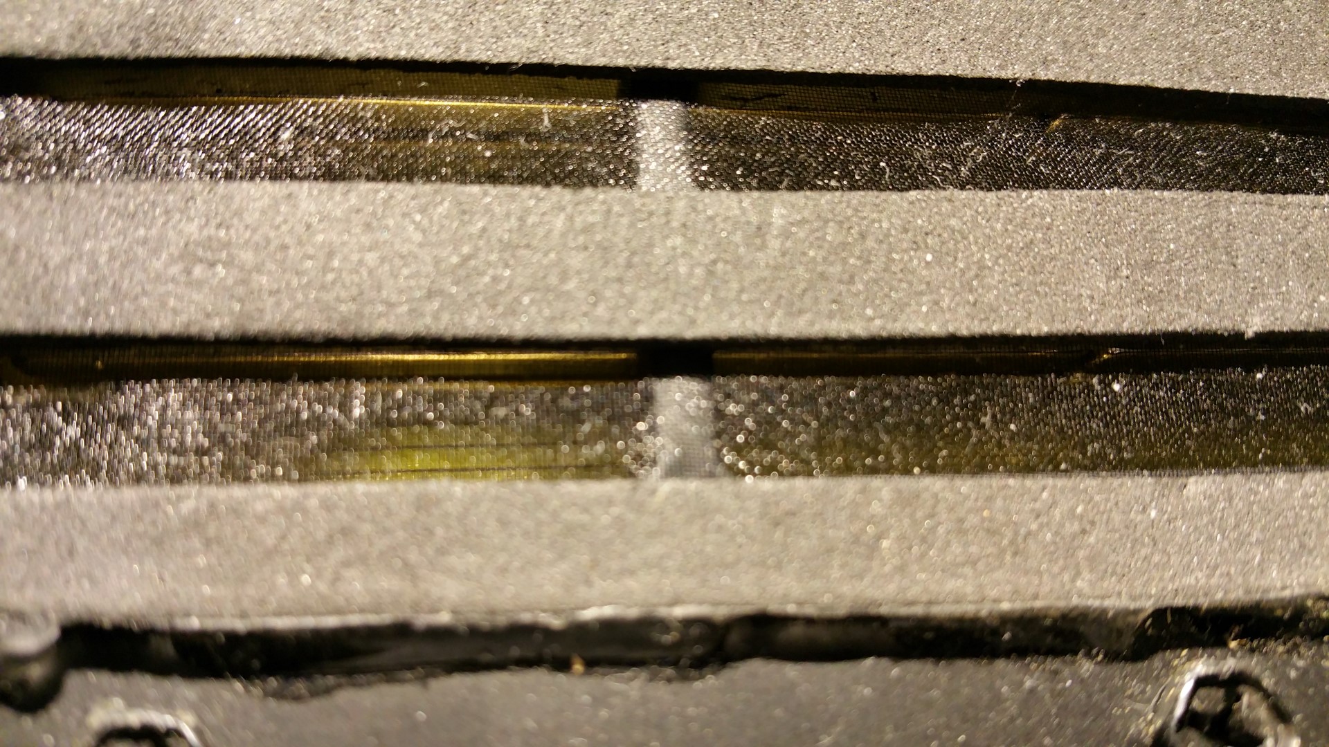

I also have a question as to the strength of magnets to be used. As you have seen the present magnets are all corroded and need to be replaced. I am unable to determine the strength of the magnet. Can someone please advise if I could just take a N55 magnet strip that has the same dimensions as the present lot and replace them? Or has the magnetic strength be exactly equal to the original magnets?

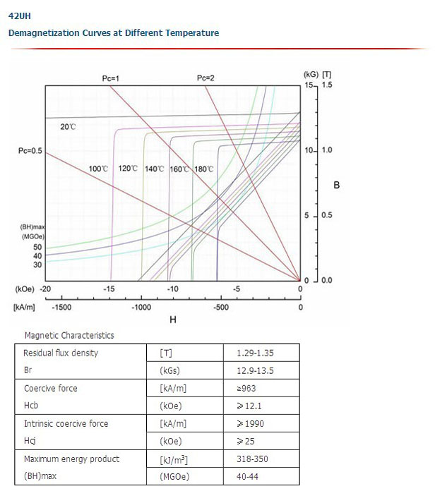

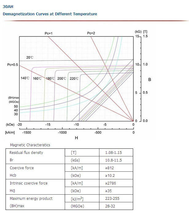

N55 is not needed. Most of the work done in rare earth magnets is to allow the magnet itself to work at higher temperatures. In the case of voice coil type linear motors ( normal woofers) you have an enormously inefficient motor type that produces a great deal of heat. Most loudspeakers are in the order of 2% efficient in converting electricity in to force. Heat quickly becomes a problem when you have for all intense purposes an electric stove element being used to help move around a cone. Magnets are very close in the motor and tend to really warm up in high power applications.
A planar has some good things going for it in home application. Lots of open area. Relatively low lower input for the frequency range of interest.
So below I posted two types of neodymium magnet material. They are pretty wide apart in the numbering scheme.
Look in the line Maximum Energy Product.
There is a fair difference in the numbers presented.
The curves are for demagnetization. The temperature where the magnet begins to loose it's strength.
N42 is pretty good for a planar that is not trying to be used in Pro-sound. Openly I don not know what was use din the Monsoon design. But I'm giving you a middle of the road suggestion. If you go to strong on the magnet you end up with an over damped motor. So you end up trading efficiency for loss in low frequency output. Remember loudspeakers like to have your cake and eat it to!

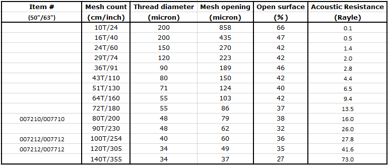

Would something like 1 yard - 200/80T Yellow x 50" Width Silk Screen Printing Mesh Fabric New | eBay be a better alternative to speaker grill cloth? Assuming that it was going to be tightly stretched across?
Nice find :up:
A seller of silk screen mesh that actually gives thread diameter and pore sizes. :)
I took the seller’s table and added a column showing the estimated acoustic resistance in Rayle.
The 80T fabric you linked to has Ra not that much higher than tightly stretched grill cloth. I would suggest using the 100T or 120T fabric instead.
1 yard - 300mesh/120T Yellow x 50" Width Silk Screen Printing Mesh Fabric New | eBay

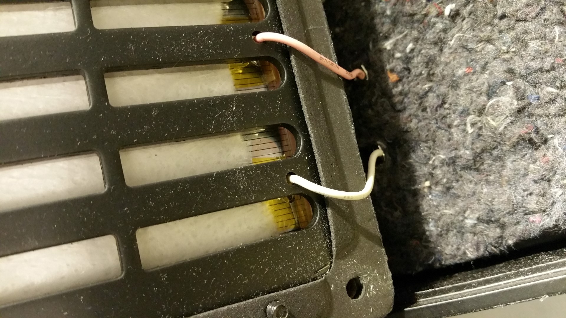

Bolsert, Lowmass & Mark I had a few more questions, could you please assist?
Is there any advantage of stretching & gluing the 300 mesh/120T fabric in the front of the speaker as well?
Apart from a notch filter are there any other mechanical means of reducing/eliminating cavity resonance? Stuffing the "inbetween's" with fiberglass/angel hair wouldn't be a solution I guess with the damping material moving with the diaphragm.
Is it safe to assume that cavity resonances would translate into increase of impedance on the graph after the fundamental resonance frequency of the driver? Or can cavity resonances also crop up before the resonance frequency of the planar driver.
How does one differentiate between the resonance frequency & cavity resonances in a planar driver?

If I were in your shoes. Mount your newly re-magneted driver and listen to what you have. If you have the ability measure what you have. Measuring is as simple as an IM-6 mic from Parts Express and the Audio Tool app by Julian Bunn.
Then assess what you have. If you want to play with damping you have a few choices. You can go with the learn as you go method. Might be a good one for you. Taking a baseline measurement is a good idea because we have a crazy ability to believe that every change we make is better. Many times it is not really better, just different.
You will have little ability to effect cavity resonances and they will be quite high up in the response to begin with. There will be cancellation effects across the planar ahead of any cavity effects. Your mounting baffle will have greater effects than many other things and treating the baffle itself with an absorber should produce some interesting and potentially useful effects.
It would make the front and rear response identical as possible, if this is a design goal. But then again, when using mesh, you will only see a small < 1dB difference in the mid and treble range if you only used the mesh on the back. The main thing is to make sure you have damped the diaphragm resonance enough so it isn’t limiting your output capability at and below the crossover. Basically, measure the near-field response before and after applying mesh to the rear frame as mwmkravchenko recommended. If you need more damping, add some mesh to the front frame as well.
For dipole use, there is no acoustic way I am aware of to damp the cavity resonance without ruining the rest of the response...you have to handle it electrically. In monopole use, it can be done, but you have to play with the damping and back chamber size/shape a good deal to get what you want.
