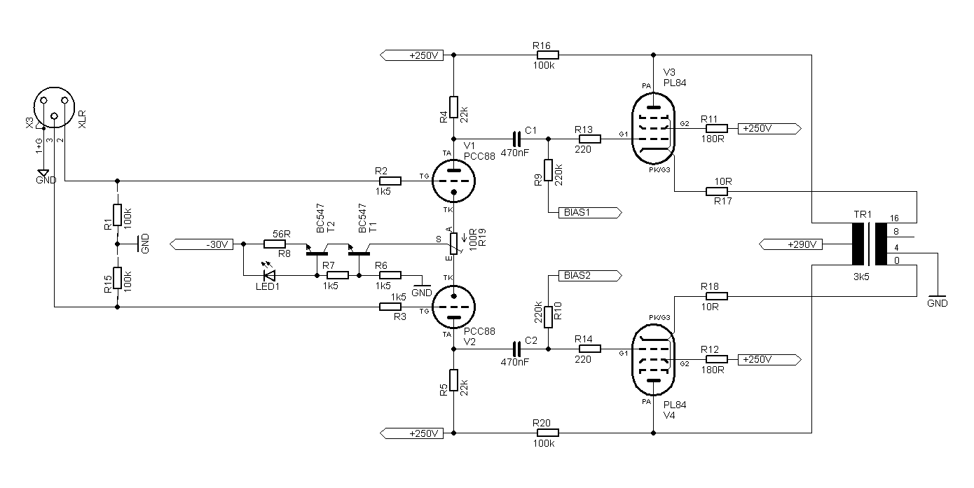

I have recently experimented with making the input stage a cascode, but I need to order some JFETs
A cascode is ideal for Schade. Just remember you have to have an unbypassed resistor under each FET to their junction point.
