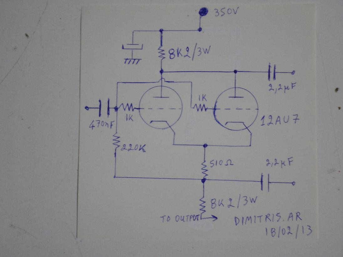

i am looking to use possibly a 12au7 in the phase inverter stage, as i have a few of these at home, any idea how they would manage driving 6 tubes?

Yes I remember your kind words , and I am glad that my amp inspires you to start building your project , of course you can drive 6 PL36 with the 12AU7 tube , you have to parallel the two sections of the tube , I don't test it but it will work , sure it will not have the driving capabilities of 6N6P or ECC182 , but it will work quite good , the circuit is attached below .
In case you want more power and lower output impedance you will have to use another driver/spliter tube and you will need 10 or 12 PL36 or PL500 which is very similar to PL504 .
