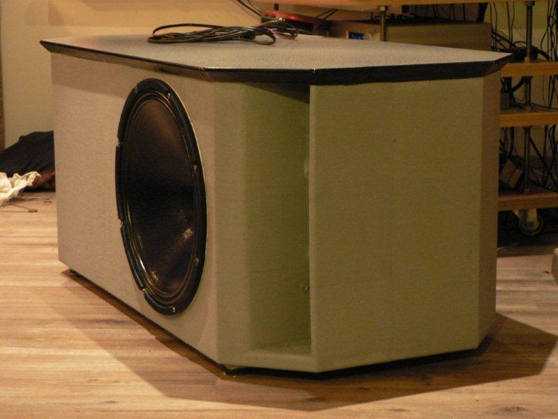

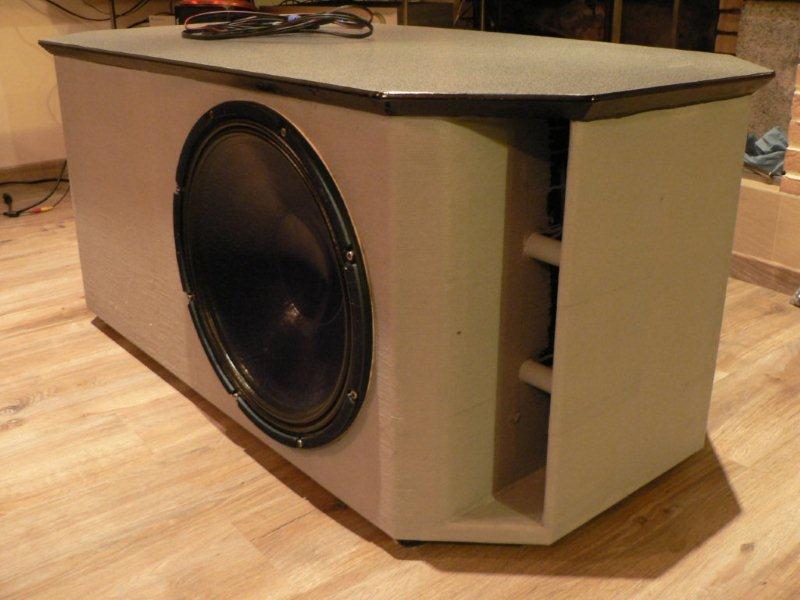

It has been a while since I've removed the driver to tidy-up the box.
Didn't have much time to play around with the finishing touch, but now I gave it priority.
I really started to miss the vibrations through the house! :D

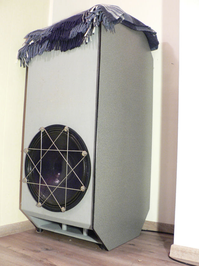

Welded a DIY grill to put in front of the sub.
The sound of a sub in the middle of a room is seldom satisfying, so I placed it in the corner in an upward position. Huge difference!
And out of the way too. :p
(It's not tilted backwards, it's the camera that's tilted to the left :rolleyes:)
