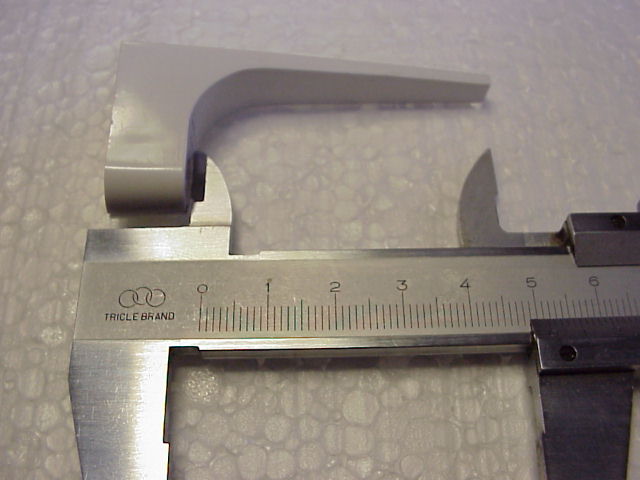

The deck I have on the shelve is the SL1800 and the overhang is adjusted with a gauge. I can't see the manual for the SL1500, only the MKII version so I don't know if the arm is the same.
Anyway, if it is, the gauge which I have aligns the cartridge back of the shell to top of the needle as 51.5mm.
Furthermore, clean the contacts of the arm where the cartridge enters.
I just noticed that the overhang is 15mm for the SL1500 as described in the brochure. That is the distance from centre spindle to top of needle.
Hope this helps.
/Hugo

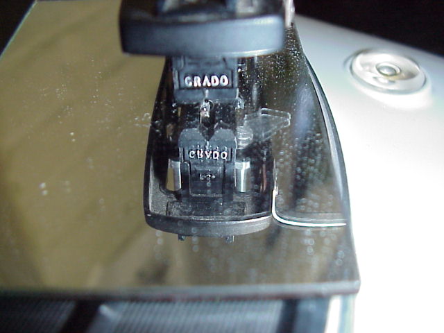

Here's an advanced explanation of how to do it. Since there is not too much you can adjust on the SL1500, I'd only care for the overhang and azimuth. A small mirror comes in handy for that.
Put the mirror on the turntable and let the needle gently rest on it. Now you will notice very well if the cartridge is mounted correctly. The picture tends to show a bad azimuth but of course I blame the lens of the camera.
/Hugo
