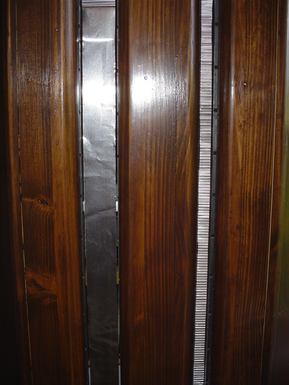

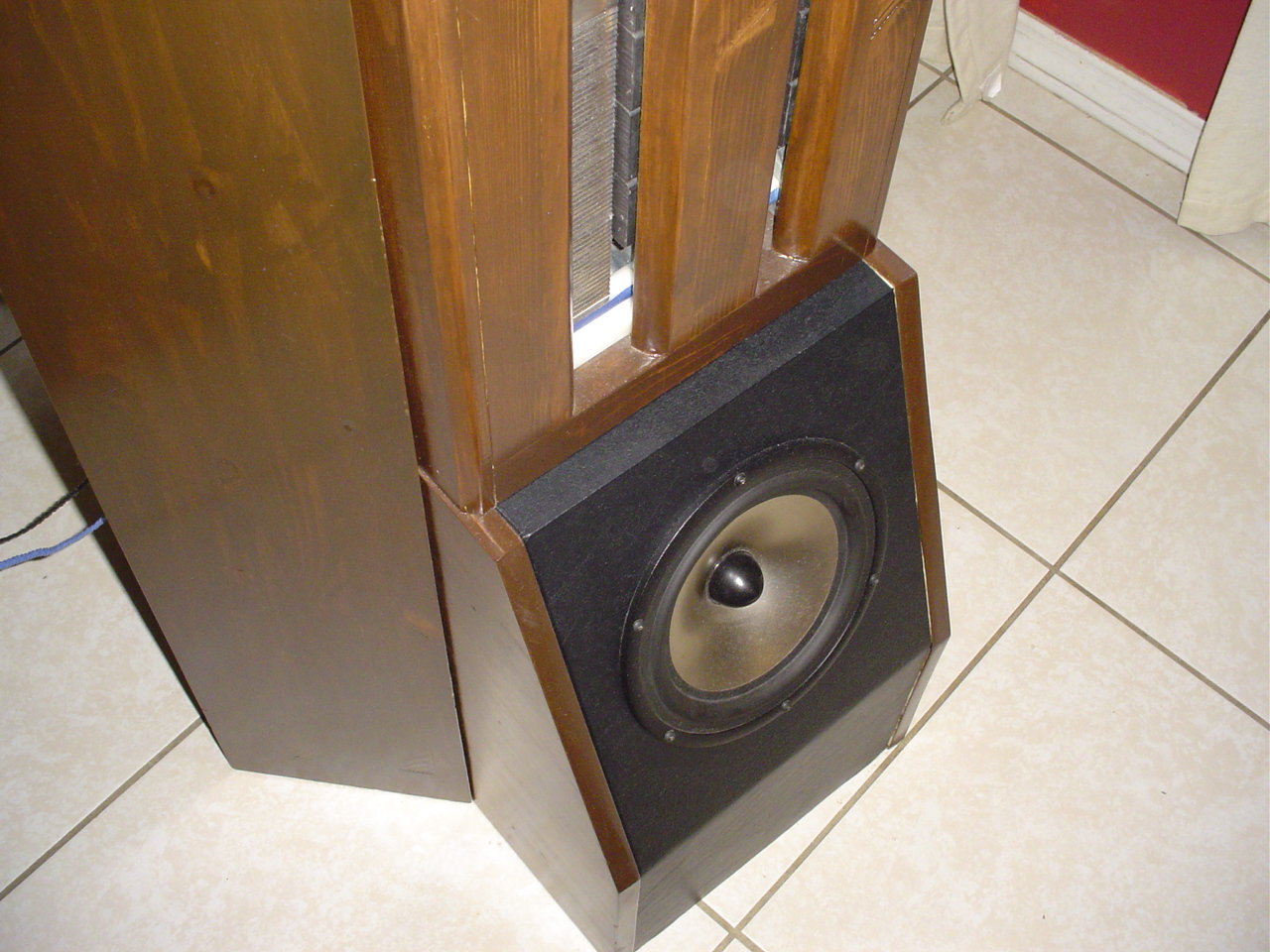

Pistonic corrugation
Corrugation hurts the midrange IMO, so i have created the suspension at the ends for tensioning and low freq response and left the middle smooth , best compromise so far .
Corrugating the tweeter does work .....

I did make a multi striped ribbon shaped like that, But I never got to test it,many many years ago.
As of last year I still had it,But now I can't find it as I was going to post a picture of it to show my etching technique on another thread. :(
I used copper foil etched and then sandwiched in between two layers of .25mil mylar with a very very thin layer of rubber cement.
I was exteremly light and the long folds gave it alot of rigidity.
And it did not readily bend easily.
I was messing around with ribbon designs from 1992 to 1998.
jer

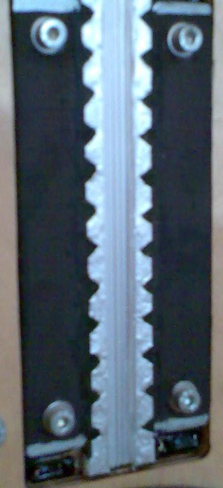

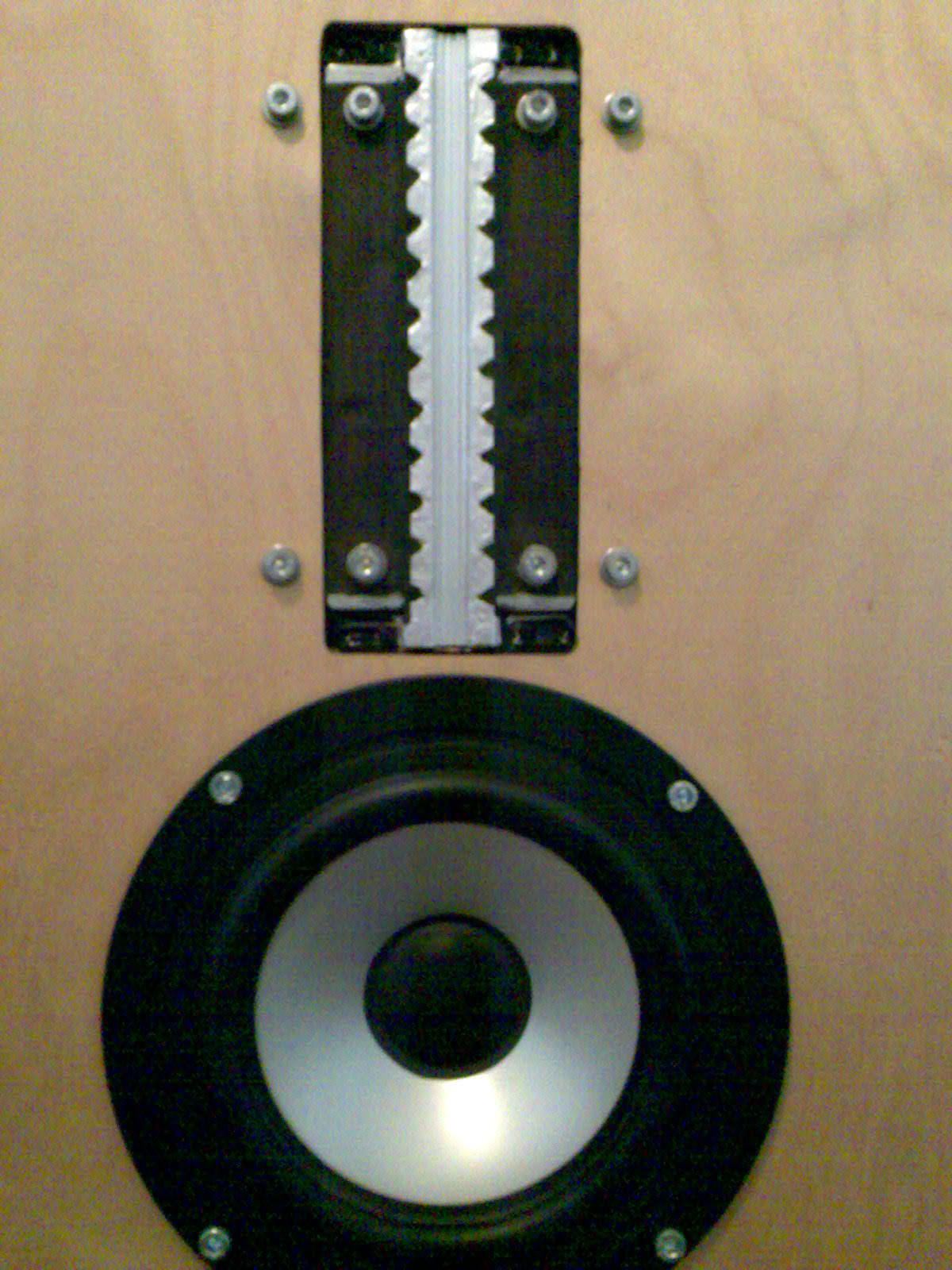

I came accross this patent:
Ribbon Loudspeaker Having Corregated Ribbon For Reducing Distortion
In this patent, the corrugations at the two ends are 5 times larger than in the middle.The goal is to reduce the "snaking" of the ribbon - I am not sure what that means.
The ribbon tends to bend like a snake after full corrugation making it difficult to tension and kept straight. If you want ( and you want ) tight magnetic gaps he is using the bigger folds to get the ribbon tensioned straight without "S" bends (snaking).....
