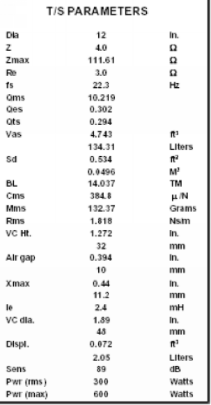

BAM is correct about "cabin gain" being included in the specs of enclosed car speakers. Also, they do that a lot when listing "frequency range", which is often a useless statistic as well.
However, a speaker made for cars will have T/S, (Thiele-Small) parameters just like any other speaker. If these parameters are stated accurately, they will determine what the speaker will sound like in what size box. In this case, if this speaker is put into a 2 cu ft box, it will be 3 dB down at 34 Hz. If the efficiency is stated accurately, (89 dB @ 1W/1M), that is not too bad. And it has an excursion of almost .5 inch, which is good.
In other words, I would not rule this speaker out, especially if you can pick it up discount off it's list price of $135.
Follow BAM's advice and check out alternatives and Parts Express. If you really think this is the subwoofer for you, let me know and I will check to see the sensitivity rating checks with the Thiele-Small parameters-some companies exaggerate and that is one way to catch them.
I think this speaker is a possibility.
Here are the Thiele-Small parameters if you or anyone wants to run them through a program:
Here is a useful page from Pioneer on this woofer: http://www.pioneerelectronics.com/Pioneer/Files/ts-w304c_spec_20011241032353030.pdf
