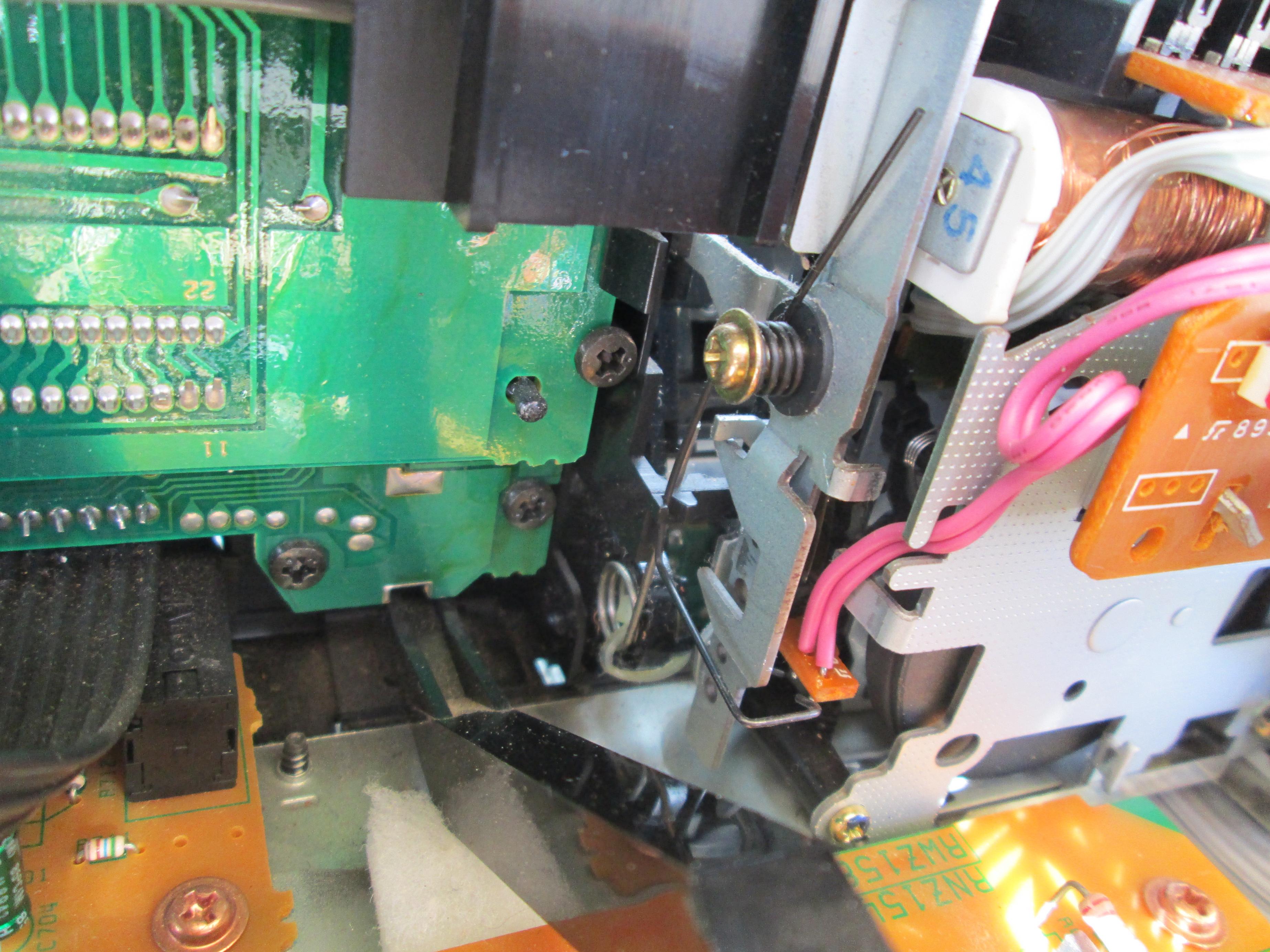

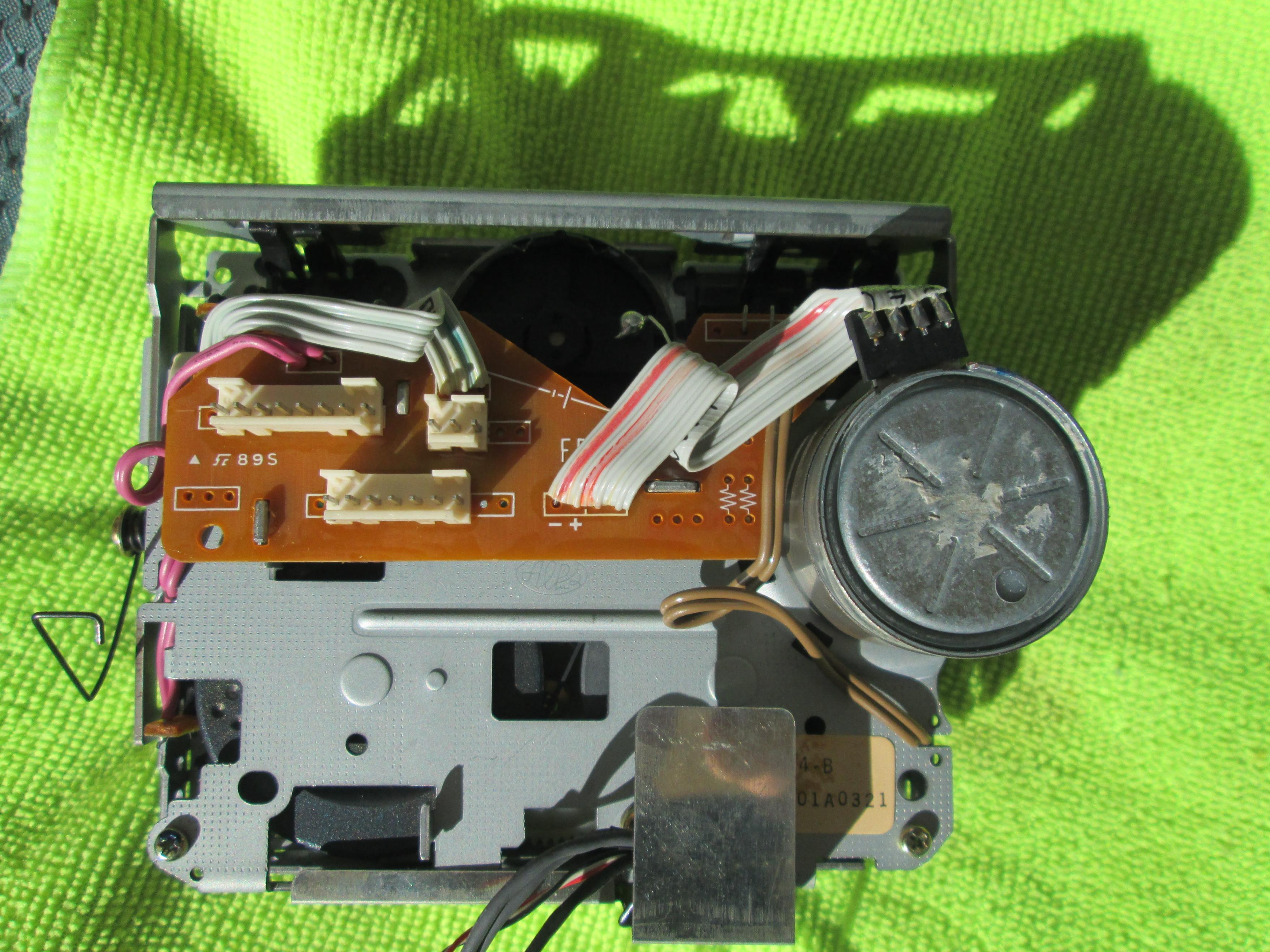

I have a Pioneer tapedeck CT-W910R thats been working great,then a few weeks ago while I was playing a tape it sped up and sounded like chipmonks chattering away? The pushbuttons FF,RW,Stop,Pause,dont respond nor the eject button and I have to turn off the power to stop it.This is a twin cassette and only does this on the left side,Ive cleaned the pinch rollers,spindles, etc.. the belts look OK, I cant see anything thats obviously broken mechanicly in the tape mechanism or swollen leaking caps, etc.. on the boards. Ive noticed a spring thats not connected to anything on one end though? (Uploaded photos) Its not in the service manuals exploded view and I cant find anywhere to clip the right angled end onto so Im wondering if this has anything to do with the problem? Any help greatly appreciated.:D

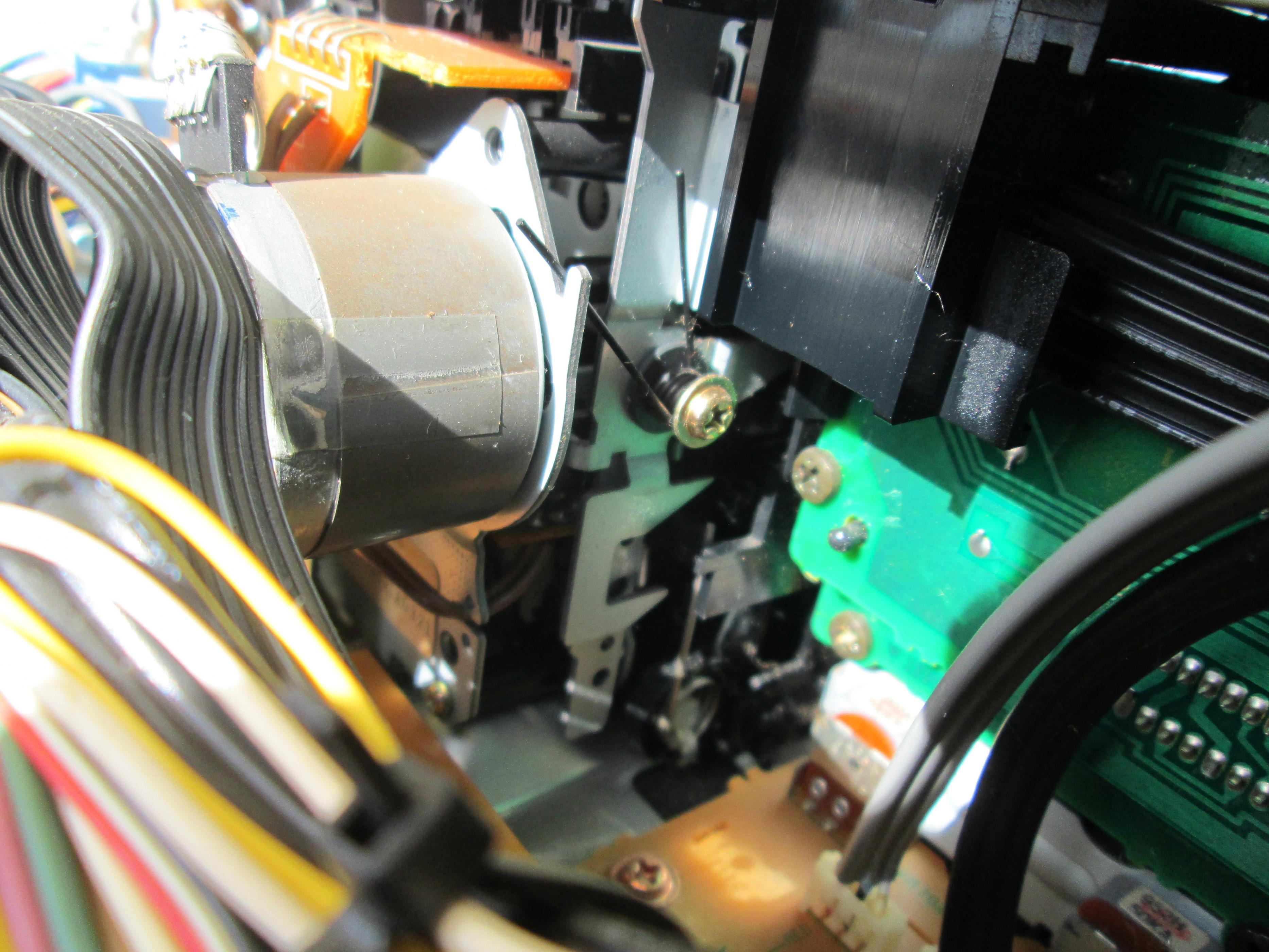

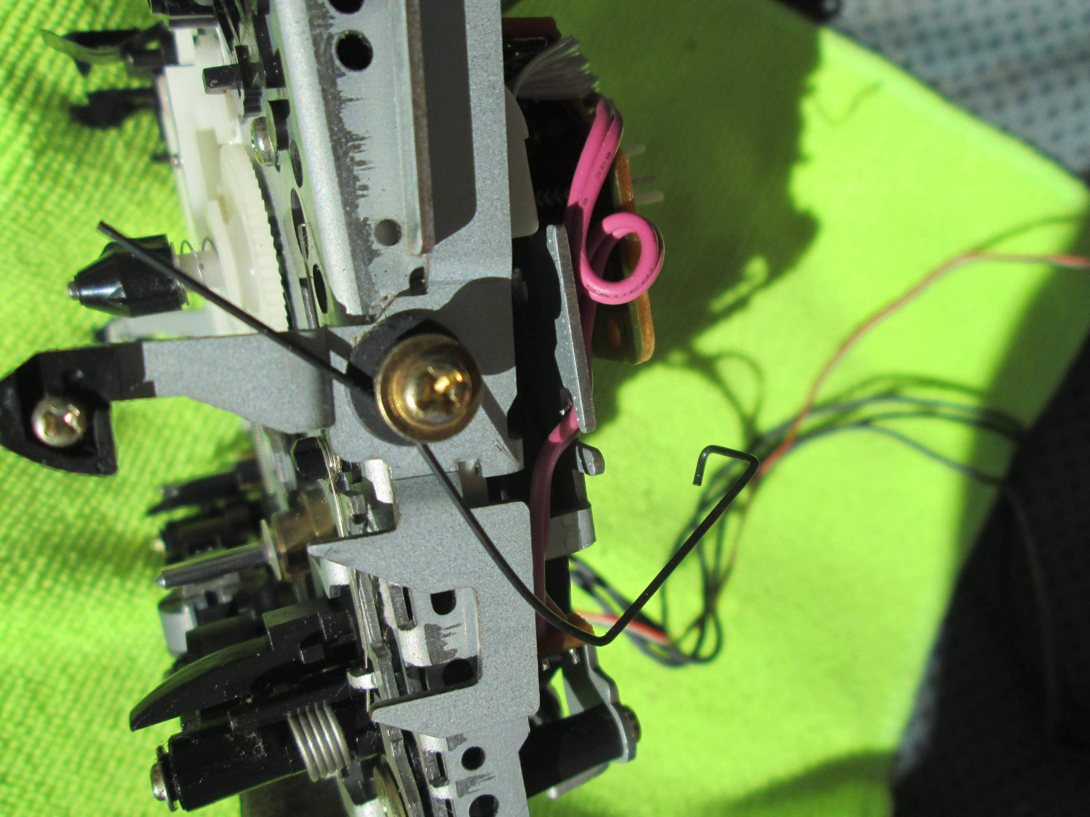

Here are some photos with the mechanism as it was still in the tapedeck,the first photo is the lefthand side with the different type of spring and the other photo is the right hand side showing the other spring?

If it suddenly speeds up then perhaps the pinch-roller spring has come adrift? The jamming of the controls might be due to the spring blocking the push button mechanism.
Thanks for the info, Mark. I have repaired many a tape deck in my time but this one is beyond me? I've tried everything I know plus a load of suggestions and ideas from other people like yourself without success, that's why I'm looking for someone in my area that is familiar with this model so I can get it fixed properly.
