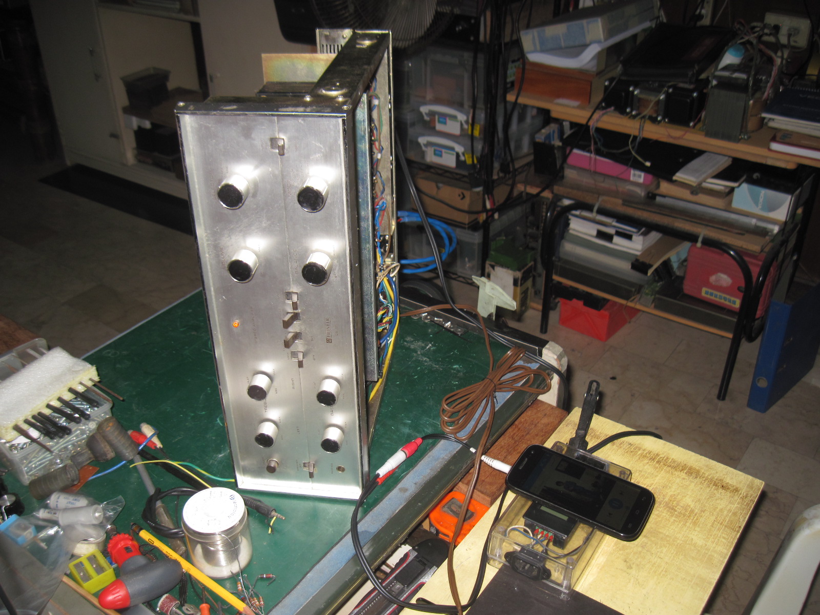

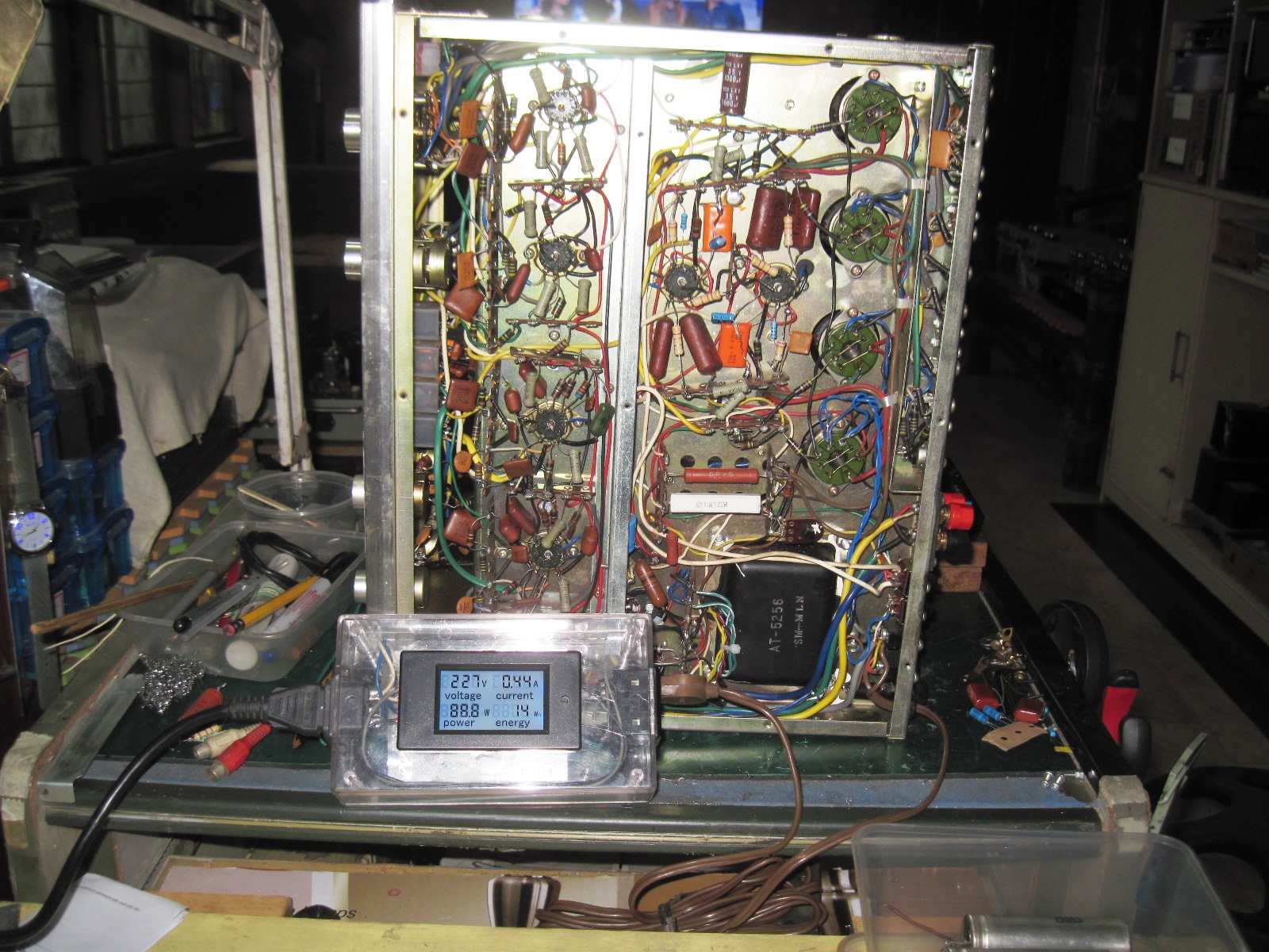

Hi, Ian mine was a pioneer sa-81, the original tubes are thin pins, the new production one was thicker pinned, so what i did was to loosen the sockets to accommodate the new production tubes....you can buy the novar 9 pins sockets but once you insert the 7868 new production tubes, then it will become loose for the old tubes..
can you send me the schematics too? thanks, i hate working on gears without proper documentations but sometimes i had to....
i wonder if this is the same as your pioneer sa-810:
