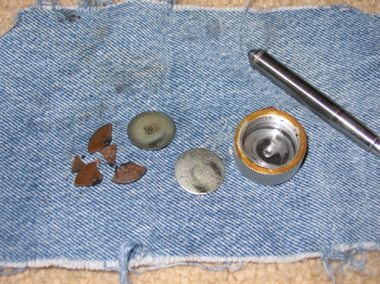

I think I need to replace a piece of my Pioneer PL-41's bearing. I don't know the correct terminology for everything, so bear with me. As it was assembled, the bottom of the spindle sits in a screw off cap on top of (from top to bottom) a plastic disc, two metal discs and finally the cap. The plastic disc appears to have shrunken and broken into several pieces. Because of the damage, I can't be sure if the plastic disc was solid and wore away, or if it had a conical divot in which the bottom of the spindle sat. Does anybody know what it should look like? Was that the order in which it was assembled originally? What should I replace the plastic disc with? I'm thinking teflon, but would any cheap easily procurred chunk of plastic do? Here are some pics to show the problem.

The plate should be made of DELRIN, and has a small indentation machined in it where the ball sits
There should be 2-3 teaspoons of oil in the bearing well
Its a simple repair and will last for decades if the turntable doesn't run out of oil

The dimple does *not* go all the way through the material on an Empire or Pioneer turntable and the Delrin rests at the bottom of the bearing well with the screw-on metal cap supporting it
I would make the Delrin thrustplate between 1/8th and 1/4 in thick, and the same size as the internal diameter of the bearing well, so it's a "press-in-with-your-thumbs" fit
Thickness of the Delrin will affect the "ride height" of the platter; that isn't that critical in this application as you'll see; you may need to adjust the ride-height of the tonearm ( which you would do if you were fitting a new Cartridge, for e.g. ) *No Biggie*
Put some gasket goop or silicon sealer at the top of the screw-on cap where it meets the turntable body to save oil leaking out of there; going dry is how the Pioneer thrustplate collapsed and caused the problem
That won't have damaged the spindle or spindle ball, the thrustplates are designed to be sacrificial in these old designs; no harm done
*ReOil the spindle every 5-10 years, having cleaned out the bearing well 1st
*Replace the Delrin thrustplate every other lifetime ( make a note on your 2090 PalmPilot now; so you don't forget :att'n: )

I wouldn't bother with the dimple you describe in the thrust pad. Delrin would be a good choice but it didn't exist when your turntable was made - Nylon is probably the material used and the dimple will largely be the effect of wear. The dimple serves no useful purpose if the bearing sleeves are dimensionaly accurate - if, however, they are rather 'sloppy' the dimple will be centering the bearing to a point (no pun intended).

Both very similar build to the PL 41 mentioned here, and while I had always assumed the "dimple" in the bottom of the bearing well had been worn there by the hardened ball in the spindle, in fact the manufacturer had machined one there when these were new in both the Empire and the PL 12
I'd suggest its just to trap a drop of oil so the spindle ball never contacts the thrust plate completely dry; engineering overkill, a valid theory, or otherwise, that's how they did it when these were New
While a material like phosphor bronze will soak up oil like a sponge ( as will cast iron ) these wouldn't make good materials for a thrust plate here because these would wear too fast, and would be hard enough to damage the hardened spindle ball over time
The nylon/Delrin doesn't have particularly good oil absorption properties, hence adding the dimple, but Delrin to is too soft to damage the spindle by contact over time
You are 100% correct that Delrin wasn't available back then, and that nylon was. Delrin was mentioned as it's proved to be a superior material for this repair and won't wear out anywhere near as quickly as replacing the original nylon part with nylon

I had a large enough piece of the thrust plate left to put a caliper on, and it measured .083" in thickness.

I took the cap to a machine shop today and they cut a plate out of a delrin rod. It cost me $12.36. I had looked at ordering a sheet, but many places have minimum orders. I was also concerned about my ability to put a dimple right in the center without access to a drill press. I'll get the table back together and see where things stand.

I ordered and received a 12" length of 7/8" diameter delrin rod from McMaster Carr.
Took the rod to a friend who owns a machine shop and he cut off several .083" slices for me.
I used a center punch with a light blow from a hammer to create a 1mm diameter dimple.
Put the 3 metal spacers in the threaded cap, added the delrin plate, and added oil per the Electric Gypsy's instructions.
However, here's the observation/question:
It appears that the metal spacers are slick enough with oil that the whole assembly spins in the cap. (Of course I have no way of knowing if this happens when assembled to the table, although the inside bottom of the cap where the lower metal spacer rests does show wear.)
I could have started with a larger diameter rod and machined it so it would be force-fit into the cap so that the assembly would not spin, but the original does not appear to have been done that way.
I have experimented with removing all the metal spacers and substituting an O-ring of the same approximate height on which the delrin rests. This prevents the delrin from spinning.
Seems to work, comments please.
