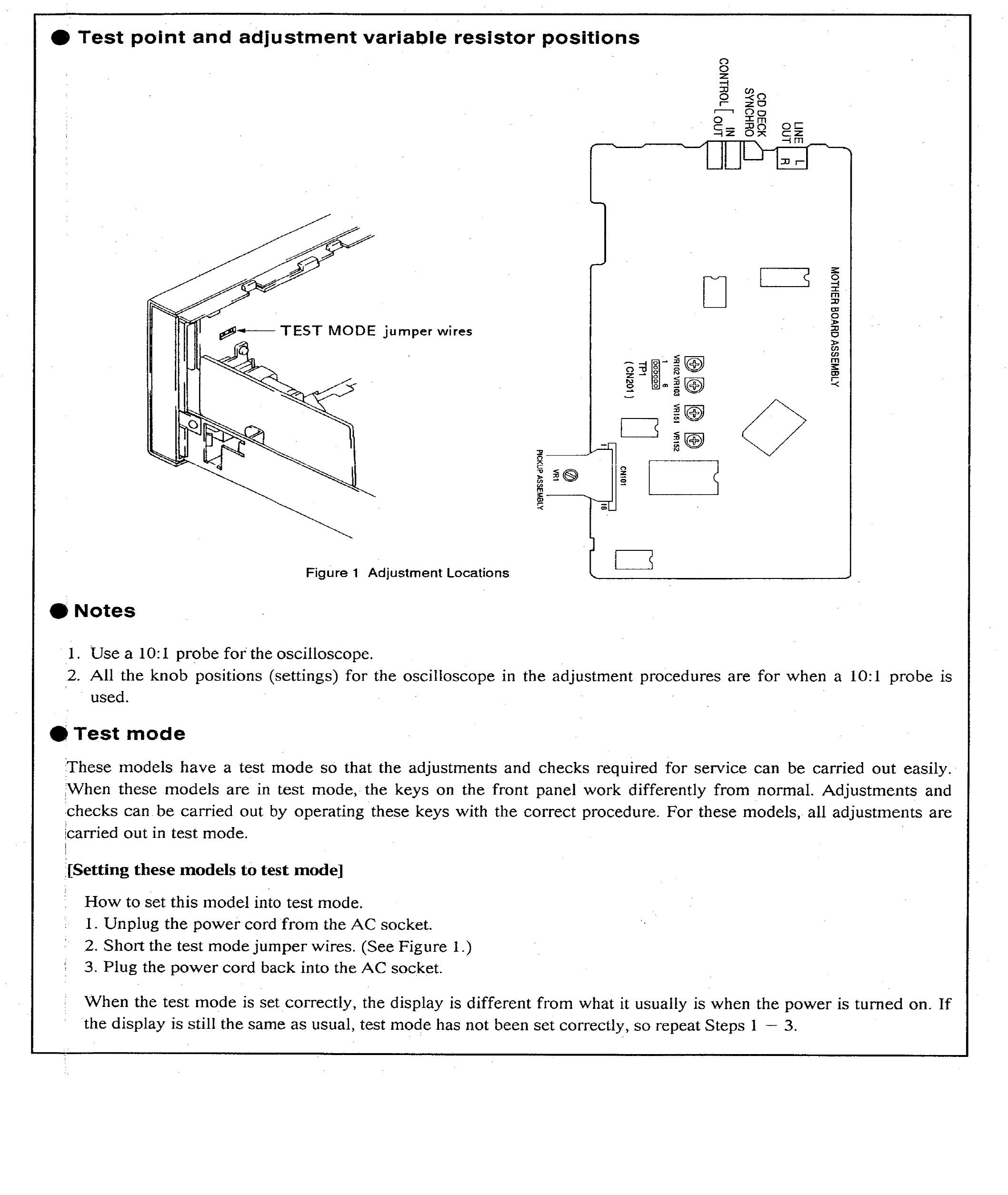

Have you checked that the switches are working properly? You want to check contact resistance. Don't assume anything, just check these things.
There is a service program in the service manual for most Pioneer CD players. Run that and it will tell you which system is failing. It overrides normal play operation and allows you to turn on each function in turn so you can check each signal test point. Some other makes (Denon for example) also have a "heat run" mode used for finding intermittents. It runs in a loop until it detects a failure and stores the failure code on the display. The service program will be your best friend right about now.

Make sure you are following the exact procedure to get it into service mode. Sometimes its not as easy as it sounds. Make sure you follow any instructions over applying power and holding down buttons etc.

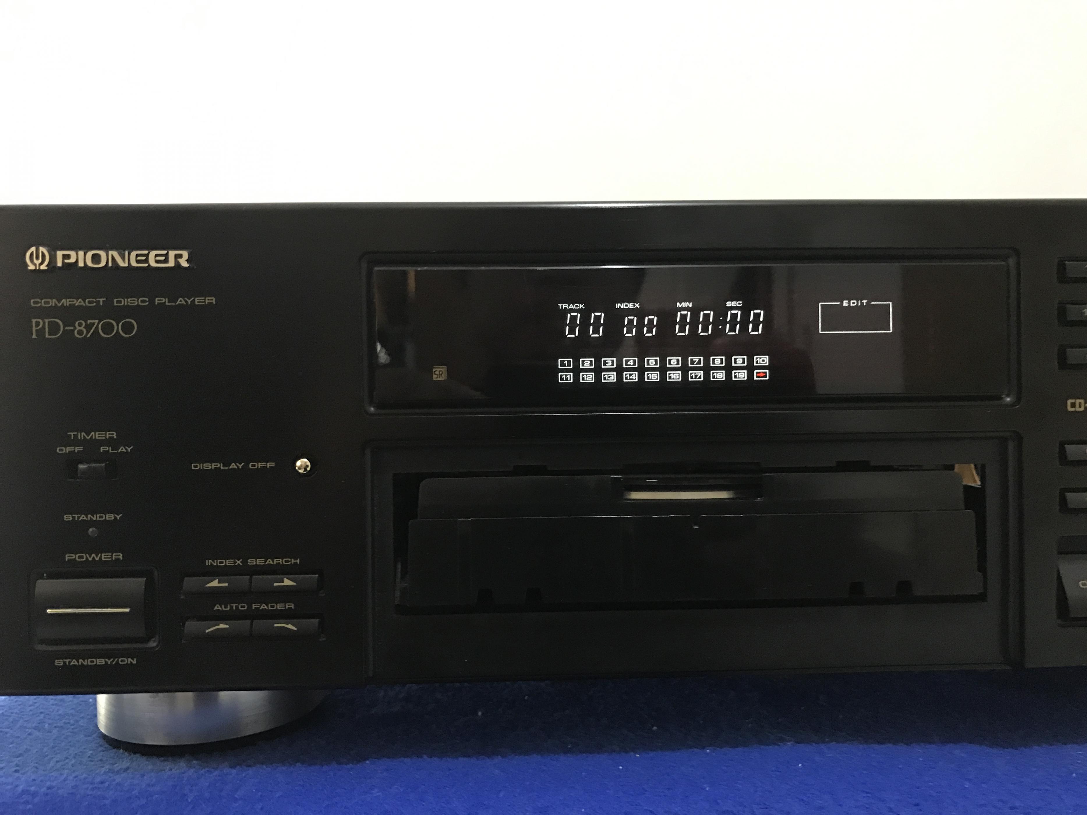

I followed what exactly mentioned in the service manual regarding the test mode but won't execute any command.
I wonder if the DECODER IC is faulty it will stop the unit from executing the TEST MODE.
I have a scope and checked for RF signal but i cannot find any.

Your Pictures show the Display looking different to normal in Test Mode so my guess is it is accessing Test Mode OK.
Can the Sled be moved back and forth with the Scan Fwd/Back keys?
The 'Programme' key turns the Focus Servo ON. (The Laser will Light and the Focus Coils should be Driven and the Lens appear to rise and fall. If a Disc is in place, and moved by hand, you should be able to 'hear' the servo at work.)
Pressing Play at the above point will engage the Spindle Servo and the Disc should start to spin. If the RF signal (Eye Pattern) is observed it should look a little 'blurred'.
Pressing Pause next will turn on the Tracking Servo which should make the Eye Patter nice and clear.

I made a discovery and I have to blame my Stupidity:headbash:
The TEST MODE is working, I need to remove the short pin after plugging the AC cord duh!:D
OK so the Spindle motor is working, FF/RW will track the Optical assy and Program will initiate the PLAY mode. So maybe it's an optical assy issue?
In Test mode:
I press the PROGRAM the LENS starting to light up.
Pressing PLAY will rotate the Spindle motor but I need to stop for sometimes as it whirling like a helicopter.
Pressing the PUASE will display the PAUSE sign but won't show any track number.
STOP will stop the spindle from rotating.
Have you an Oscilloscope? Can you look at the RF Test Point?
With a disc loaded, when you press PROGRAM do you see any signal?
I suspect you won't, or it will be very small, too small for the player to recognise, hence no play.
Not normally recommended but a small and I mean small turn of the Laser Power potentiomemter on the Laser itself may spark things into life. I'm afraid I can't remember which direction is 'Up' so make a note of where the potentiomemter is before you start and try it both ways.
I do suspect the Laser is at fault.
