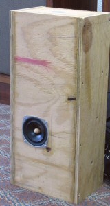

I resemble that remark! ;) If I couldn't 'slam' a pair together in an afternoon I was goofing off way too much. Not that having power tools helped, though in my defense it was just a proof-of-concept made from house repair scraps to showcase Dave p10's doped/plugged 40-1197s:
Anyway, I normally left the finishing to the end user. For myself I didn't care since they were always big/loud enough that hiding them behind open weave drapes was easiest.

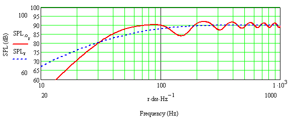

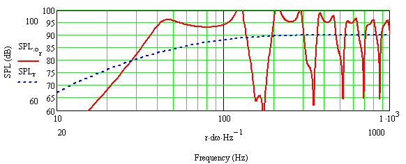

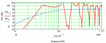

WRT traditional TL designs, as Dave says, stuffing does not significantly affect the apparant line length the driver 'sees.' One of the (many) myths of TL design, that. Assuming a semi-resonant line is what is desired, rather than a near-aperiodic or pure transmission line, then the principle affect of adding damping materials is to help attenuate the unwanted harmonic resonances of the pipe, and to change the system roll-off characteristic to something shallower.
For example, here's the frequency response of a simple, untapered pipe with a Peerless midbass & the driver mounted at the far end, with no damping applied:
And here's the exact same pipe / driver, but with 0.5lbs ft^3 of Dacron hollow-fibre stuffing added throughout the line (different materials will need different packing densities for the same level of damping).
Note that the final cut-off frequency doesn't change much. However, what you do get is a much more balanced response overall, closer to the driver's natural sensitivity (where the undamped pipe boosts it signficantly above this), the attenuation of the harmonic modes, and the shallower roll-off described above.
