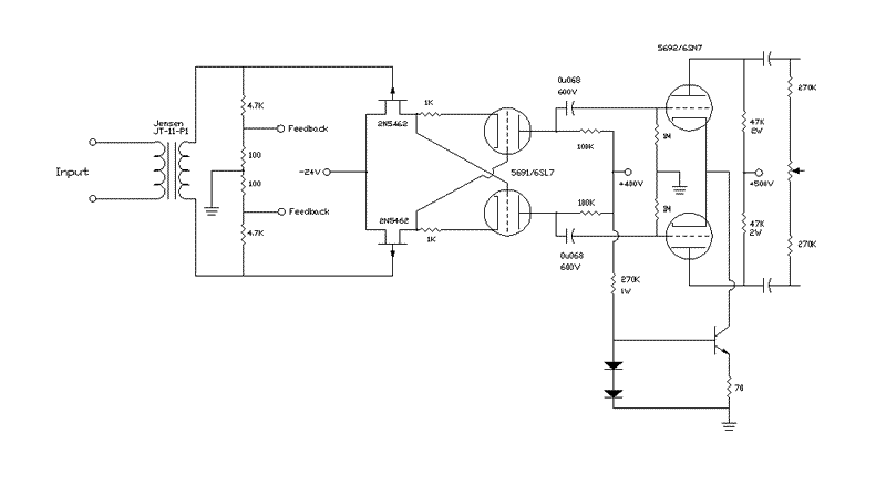

Josh, I'm putting together a website, sloooooowly. I'm still trying to figure out the mechanics... In any event, here's a version of it. The one in my "big" amp used the same mediocre CCS (I'd redo that!) though set at 12mA, and split rails at +/-350V to get the swing higher. 150k on the plates of the 6SL7. There's a follower (MOSFET, though my original used 6SN7) between the driver stage and the output tubes.

Because of the configuration of the input stage Cgp isn't very important, so you can use a high mu tube. If cost were no object, some matched D3a, triode connected, would be pretty cool.
I'm redoing the stage now for publication at the new website (that's why I had found that old drawing). Besides showing the bipolar supplies and using a better CCS, there's an improvement when the cathode resistors in the first stage are changed to LEDs.
To do a screen drive calculation, you can use the curves given at Vgk = 0, with screen voltage as the variable; several sweep tubes' datasheets show this. Just do the same sort of construction you'd do with pentodes in AB push-pull. Damping factor will never be anything to write home about; there's not a lot of open-loop gain to play with, so 10dB feedback is pretty much what I was stuck with. Fortunately, the MOSFET drive for the screens means that there's no blocking at overload.

Actually, I learned about it from the RCA Tube Manual, though RDH will certainly have a good explanation. As a rule of thumb, start with the B+ voltage, then draw a line up to the knee of where you think your driver will swing. I tend to load low, idle low, and bang the screen hard. My 6LF6 amp had 800V of B+, 3mA of idle current per tube, and 1250 ohms plate to plate. That gave me an easy 150-180W.
The low current linearity of this connection is surprisingly good. I think I've posted some curves that Bascom King published in Audio showing the 6JN6 at very low currents.
Now one does have to be somewhat careful about the output transformer to avoid notch distortion, but a decently stacked and wound primary will usually avoid that issue.
