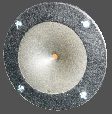

I have been using a pair of piezo tweeters in my system since the 1970s and one has recently gone open-circuit after the chip amp that was driving it went DC. :bawling: I have attemped a repair but it doesn't sound so good now.
I am looking for a replacement, but these seem to be hard to find. The tweeter is a direct-radiating piezo with a metal chassis instead of the usual plastic one, and I think they were used in some early Celef and ProAc speakers. They are about 3.25 inches in diameter.
When I bought them, they were marketed by Bandridge but I suspect that they were made by Motorola.
If anyone knows where I can get one of these, or any other info about them please let me know.
I hope I have successfully attached an image...

martinsoundpro.com is selling piezos (not the cheap junk sold at partsexpress).
http://www.martinsoundpro.com/item.asp
here is another source.
http://www.adelcom.net/MotorolaTweeters1.htm
The 1016a is nice but can't be run passively without a transformer network.
I've had great luck running a piezo with an active crossover (the ones that ring at 4.5khz, I run 60 ohm in series and active cross it at 5khz LR so it is 6db down at 5khz).

Hi Keith,
It's a pity that you don't have the reference for your tweeter.
Wayne P. from Pi Speakers, used to have a model of a speaker (kit) with a piezo (KSN1038 http://www.audioroundtable.com/PiSpeakers/messages/16150.html ). In the mean time some years ago he did the upgrade of the kit with a new tweeter that you could buy from him. Now I don't know what he is using anymore (I looked and is a DX25), but you sure can give a look for yourself and ask him in the forum or by mail. He also sells the xover (cap) to go with. What's the sensitivity of your speaker(s)?
http://www.pispeakers.com/Products.html
Thanks,
There are some interesting discussions on piezos in that forum. It seems the KSN1038 is a horn unit though. I have found out that the KSN1036 is a similar-sized direct-radiating piezo but it has different contruction (plastic case, grille on front etc).
I'll keep looking...
Cheers
I'm still searching, but in the mean time, I have put together a picture of all of the different Motorola piezos that I have found, along with their part numbers. This may be of use to someone other than me :)
Here is the pic...
I'm still searching. Surely somebody must know something about these elusive tweeters? Even a model number would help.
I have got hold of a ksn1036 and it is quite different to mine. I'll do some careful listening and perhaps some measurements to see if they are compatible.
