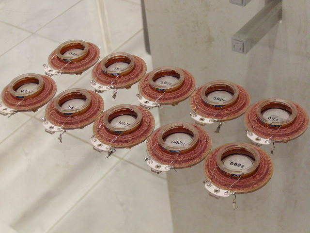

Another problem - how to wire the 6 exciters to obtain MAXIMUM efficiency? Have looked at various internet articles and have realised that series connection and paralell connection have different gains in db and a combination of both is different again.
Can anyone help on this one as I am not sure of the correct wiring configuration

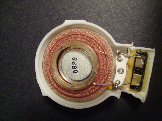

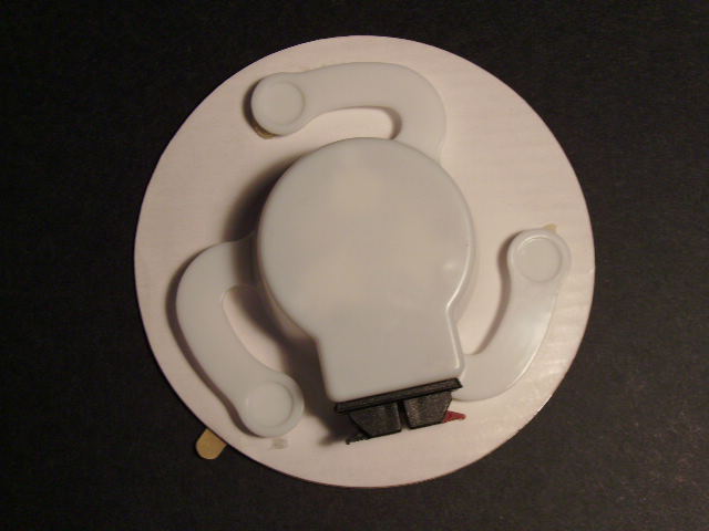

Hi human.bin.
I have no sound pads remaining so I can not take any further photos(sorry). All exciters have been removed including the two that are on the large panels at the moment.
Here is a simple step by step process to follow:
1. cut the three plastic ''arms'' near the main body of unit. Then lift them and remove from cardboard disk.
2. Cut or tear the cardboard disk from outside going inwards to the ''foot''. Do this in 2-3 places and tear away as much of the cardboard from the foot as possible (be gentle and careful!).
3. you will now have to peel off, bit by bit, the remaining cardboard and sticky, clear ring from the foot of the exciter(slowly with your fingernail - be careful once again)
4. cut casing near terminals (vertical cut) bot sides and bend outwards slightly - see second photo - '' ready to remove from casing''
5. cut wires leading to positive and negative terminals. The exciter is now ready to be removed.
6. use a small flat head screwdriver and place between casing and exciter magnet . Lever up the screwdriver so that exciter begins to separate from casing. The exciter is held to the casing with three small double sided foam ''dots'' underneath.
7. Once the exciter has lifted up enough, you can grab the edge and tear the rest of the dots away from the casing. Then, peel the three dots away from the casing and the exciter is ready.
Don't forget that the small PTC resistor is connected to the positive end of the exciter and must remain if you are only going to use one driver per panel.
Hope this helps.

When the panels are completed in their prototype form with all 6 excirers per side, I will try to get a SPL and even a frequency response curve. I know someone who can help in this field.

If you mean the PIEZO TRANSFORMERS?........they came with the Le Son tweeters(built in). They match the very high impedence of the piezo to the amplifier load. With the transformers, the output is VERY much increased.
Parts Express sell a KSN1188 clone that is cheap and has a built in transformer. It is 4 inches in diameter and is a screw on P.A driver for horn flares.
