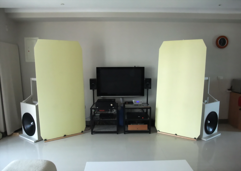

Here's how I set them up (for now):
The amp driving the panels is unusual with a 20 Ohm output impedance. It's setup by a mixed voltage and current feedback method brought up by Mr. Rod Elliott here: Variable Amplifier Impedance
All 5 excitors wired in series with 4 of them bypassed by a cap. Because of the bypass cap, the group of 4 is unseen (shorted) in the higher frequency range, thus a clear trend of high impedance in the bass and low impedance in the mid and high frequencies. (plateau under 200Hz, broad valley center around 2.5kHz)
The high impedance drive interacts closely with load impedance, thus an output curve almost tracking the impedance curve:
That's by calcuation. In reality, it seems the boost in LF is not so much. And I need addtional EQ to make it flat down to 40Hz or so.
Later I tried active xover with an amp driving the single unit in fullrange, and another amp driving the 4-unit group. So I got freer adjustment and more boost actively. However I didn't like the sound of active version (for the first time). It's not so coherent as passive version.
At its best (after EQ, of course), I got about 40Hz ~ 20kHz bandwidth with proper tonal balance. And they can play quite loud. No numbers. Loud enough to be painful or bother the neighbors.
But when it plays loud, beyond a certain point, it starts to sound compressed and thickened. I'm not sure where exactly the problems come from. Maybe it's the limit of excitors, or the undamped panel itself, or the improper securing means, maybe all of them...
I didn't mention that there're several intrinsic resonant peaks on the panel itself (or maybe also related to the positions of the excitors). Now they are at 6.3kH, 2.5kHz, and/or some others not so pronounced around several hundreds...

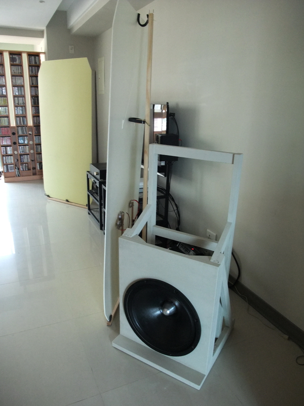

Along the experiements, I think I'd better release the LF load on the flimsy panels (and poor little drivers). So I added cone woofers for bass augmentation - my old 18" pro woofer on OB.
I kept the panel running fullrange, but not anymore in the stress of additional LF boost. The OB (dipole) cone woofers are arranged so that they cancel a portion of LF produced by the panel at the rear side (negative lobe of the dipole bass meets bipole NXT panel). Two major goals for this: less LF trapped between panels and wall, and keeping the bass sounds appear at far left and far right. (refer to the "OSD" concept...)
The frame holding the exciters seems not to be very
rigid, a good frame for the motor would be helpful IMO.

The pictures couldn't tell all the stories. Let me explain. The thin sticks are supposed to support the mass of excitors without interfering their fore-aft movements. I hope they would act like upside down pendulums. Prior to the fixing of panel, I installed these stick/excitor assemblies first. Without panel, the one with sigle excitor has a self-resonace of 2~3Hz; well under 1Hz for the 4-unit group. I guess these are far enough from any audible resonances of the panel :D
In my first two experiements, excitors were self-supported by their own VC formers and plastic feet -- as the securing method of original design. OTOH, in some other commercial product or in other panel builders' works, there're 'spines' for supporting the excitor (like you've mentioned). Between them, I'm not sure which is better.
I just imagine the excitor should be 'riding' on the (chaotic) waves, giving only the initial 'excitment' and then let the panel do the rest. With free floating support, the mass of excitor would interfere less with the vibrations of panel. At least we may avoid another set of mass-spring sub-system (as much as possible).
Of course it's very likely that my idea can't be thoroughly realized. It's just a trial. More will come.
And the concentrated 4-unit group was for simplification. Those two fixing spots on panel are both at 1/3 positions which is suggested by a member of another forum. Again, more trials will be needed. I'd need some other way to secure the excitors, as my flimsy foam boards were already damaged on the rear side. It's too fragile for repeated experiments. And I haven't figured out a proper and effective way to support several excitors and maintain their free floating actions...
More will come, for sure. ;)
A valid approach in my view, nevertheless your
"standing pendulum" will have higher order
"bar modes". But the approach is creative, higher
order modes could be tackled by damping.
That 'riding on the chaos' is a very aesthetic picture,
but since the resonance of your 'pendulums' will
be subsonic the movement of the motor will be mass
hampered in the audible range.
The panel is acting upon the spring predominantly,
which is given by the VC suspension of the exciter.
Of course you may circumvent problems in adjusting
the VC rest position, as your pendulum is kind of
'self adjusting' - on the other hand you will need a
"transport lock" for the exciters, when moving your
speakers to the next audio show ... ;)
