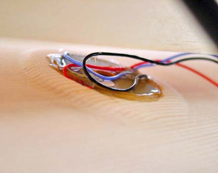

Of particular interest is the ''TRANSDUCER'' (picture attached).Seems to be a piezoelectric ?

Di fiemme is known for its superb efficiency that's why violin and piano makers use them for ages. It differs from usual wood as longitudinal wave speed is almost 6000 m/s and strong anisotropy of parallel fibers. Second trick for efficiency in piano are the transversal beams and pre-stress. What causes the audible sound happens between solid and air in hydroacoustic nearfield about 1mm thick. Turbulences, whirlpools and their interference define the far field we hear - hard to analyze experimentally but can be modeled using CFD/CAA methods.

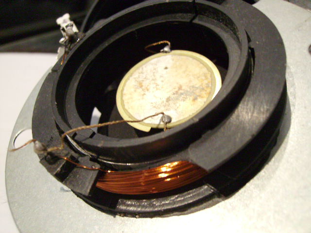

My piezo exciter taken from 3$ horn tweeter has nasty resonances regardless membrane material and no bass. Wish to find cheap and usable alternative for dynamic exciters.

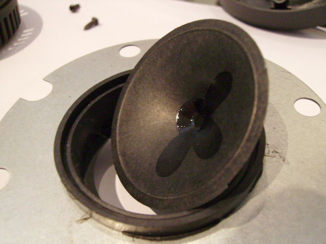

MY next step towards the panels is to mount a piezo cone at the top with a impedance matching transformer.
This may increase the top end output I suspect?
At present, I have found the correct positioning so that highs are quite adequate, but could be a bit more pronounced.

Don't spend money on piezo tweeters - just buy piezo elements alone. You need many of them at least ten to get 16 Ohms in parallel (monomorphs), overall capacitance around 200-500nF. To get anything below 2kHz you need to add mass on the back side of them and chose plate fundamental resonance low enough (100Hz). Use wood that is for musical instruments and couples better to the air.

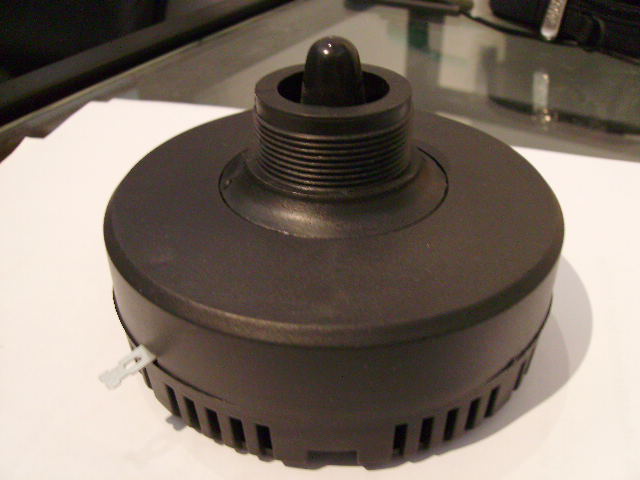

jzagaja, I already have the piezos and with transformers, they reach 100db on horn flares attached!
Without horns, they are around 95 db, so only two are required.
Also, they will only be tried as TWEETERS ONLY so there is no need for full range operation.
