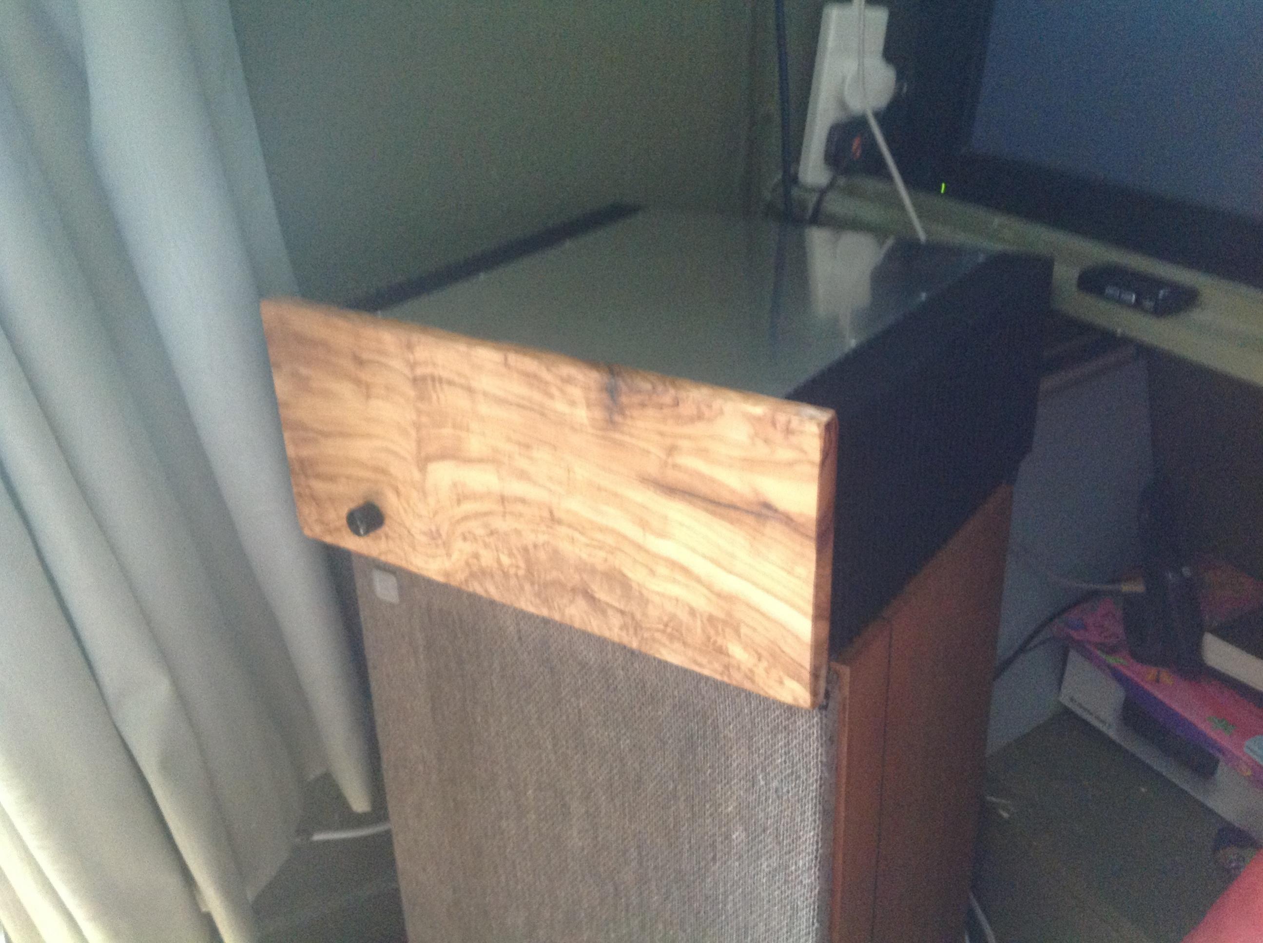

New build
Not the best picture. The front is an olive chopping board, the volume knob is horn and will ne replaced soon. Heat sinks from Australia.
