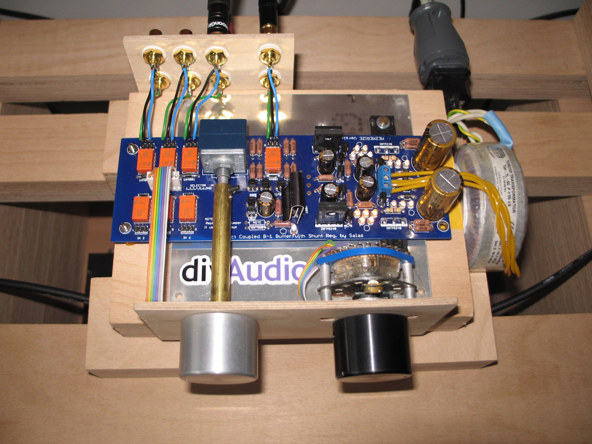

Finally ist done my Aleph P Clone has moved into a new enclosure.
I`ve used a LSQR3 for Volume Control & Input selection.
Layouts for board are from RSTaudio
Sounds fine & replaces my B1 Clone
For driving a F5 Clone i think its a better decision.
Now B1 is Pre for a SYMASYM
Many thanks to GENERIC and ZEN MOD who helped me with a little
hum troubleshooting
(now i use 221Ohm resitors at input so souce can`t look directly at the zeners at the input what removed hum complete.
I had the same problem with the Bosoz when let the 221Ohm resitor out at input
I only wondering how this is solved at orgin Aleph P
....hmm ...who knows maybe ? for me problem is solved)

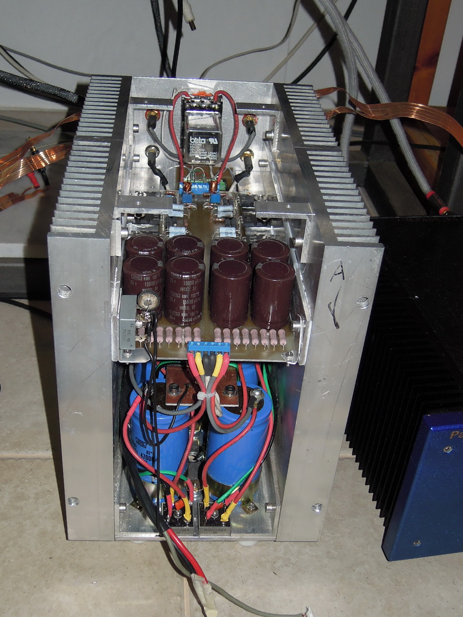

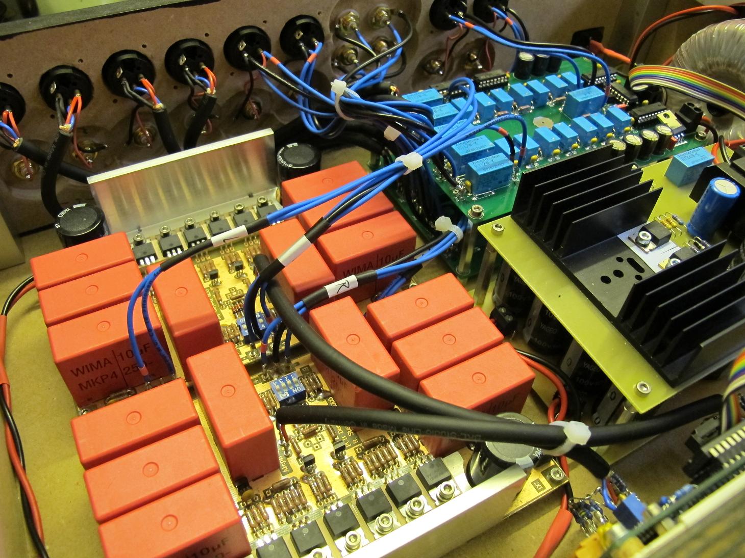

At last the A40s are finished! The sound from these is EPIC, simply stunning. Huge soundstage, super sweet treble and pile driver bass with superb grip and control (no doubt aided by the use of a 500VA toroid with 44,000uF per channel). If anything these are a perfect lesson in how power ratings can be misleading; the power amp they replace is rated at 100 watts per channel (an Audiolab 8000P which is very nearly 26 years old) and these monoblocks just blow it into the weeds. I was wondering, when I was building them, if there would be enough power for my KEF Q7s!
I have not driven the amps to clipping because the Q7s sound like they might burst and also my ears wouldn’t stand any more volume. What is also amazing is how effortless and relaxed the sound remains at this volume. Another plus point is that the sound is every bit as good at very low volumes too. All in all I am absolutely gobsmacked by the magnitude of the improvement over my old amp (the KEFs sound amazing when driven properly with a quality signal) and I’m still using the Audiolab preamp (8000C) with the A40s, but not for long because I’ve just received a B1 buffer preamp PCB with matched JFETS from Pass Diy.

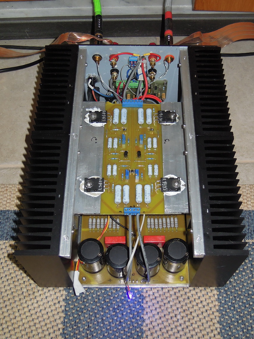

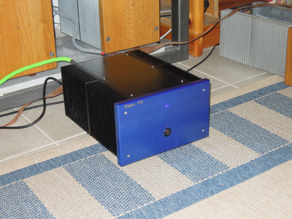

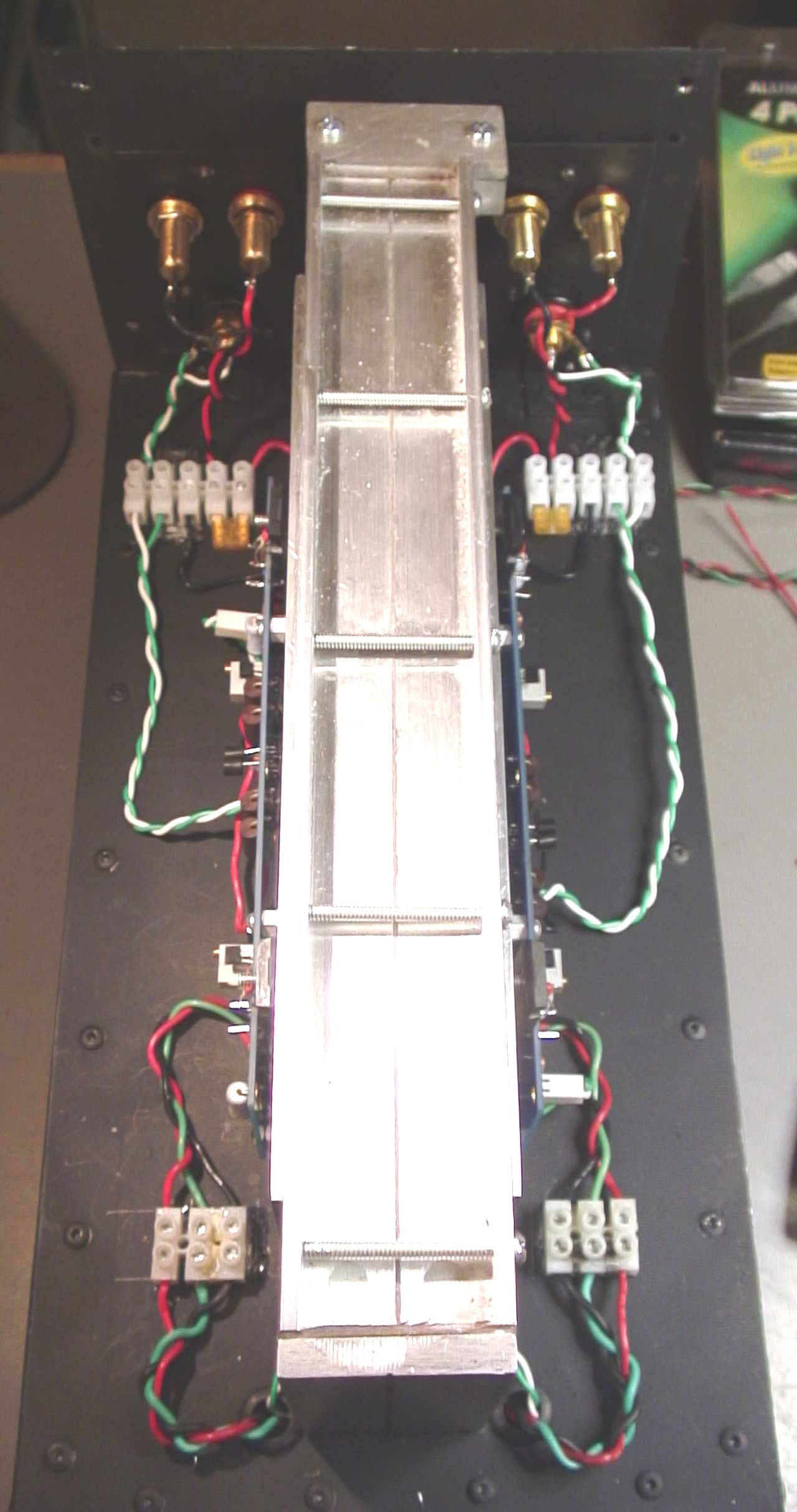

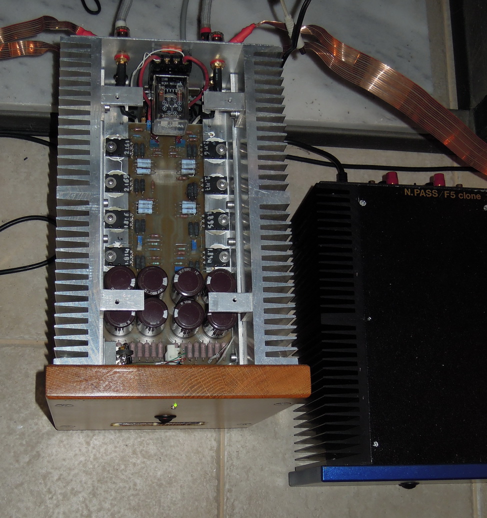

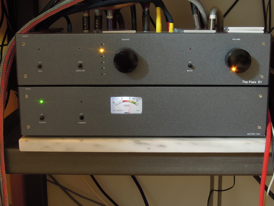

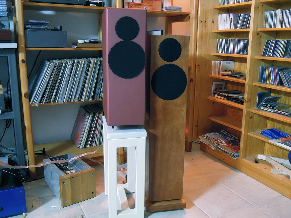

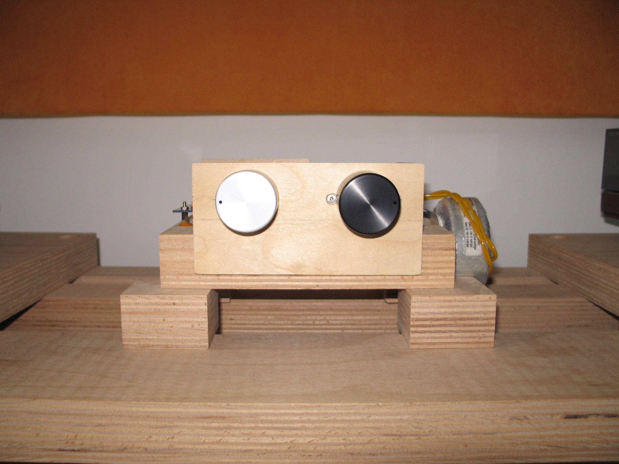

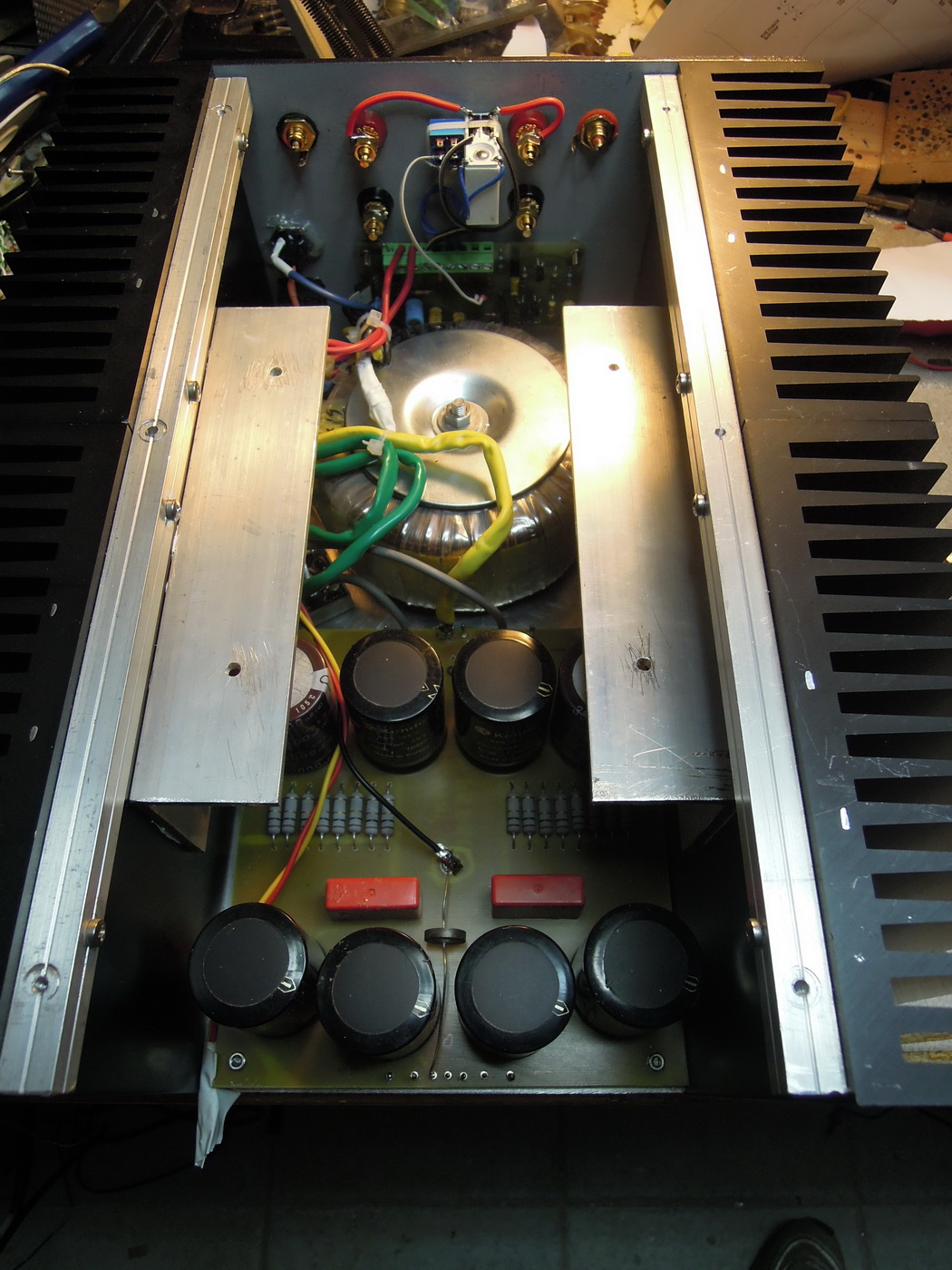

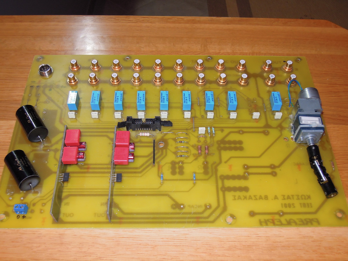

Dear friends
My name is Kostas A. Vazakas from Greece and I'm sending a few pics of my latest diy audio from N. Pass projects.
At first my DCB1 build on my old ALEPH's L motherboard and enclosure, https://www.passdiy.com/gallery/projects/70/kostas-a with two 12v/2.2 Ah batteries, and working fine from the end of 2010.
I think that I'll never change it because it is very natural, but without gain.
This was a problem with my ,also diy F5,because I couldn't listen music at higher levels.

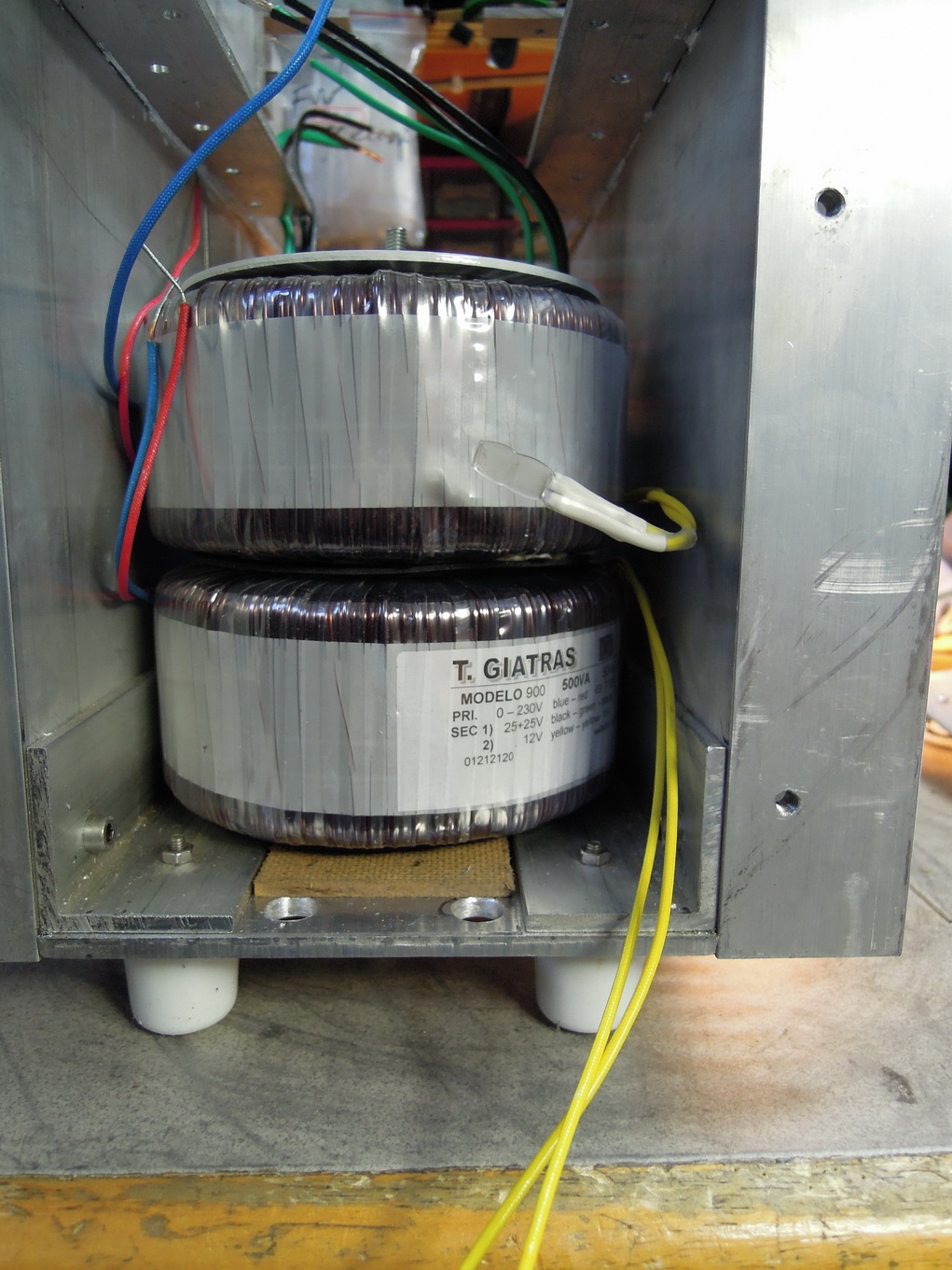

My F5 clone has a common PSU with 500 VA transformer and 176 mF total capacitance, and a pair of 2SK1530,2SJ201 per channel.It was constructed before a year ago.

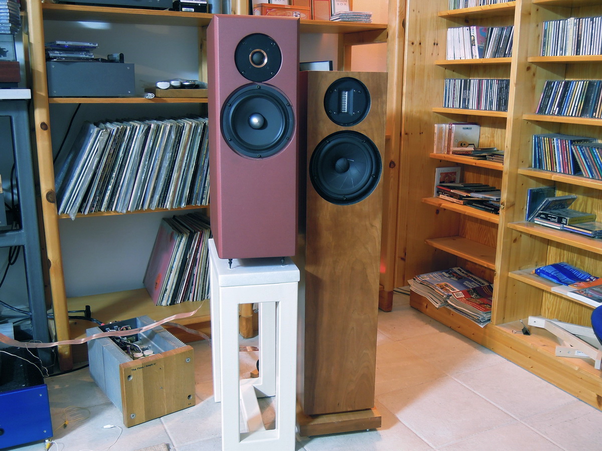

It is sounding better with my main speakers (SEAS W18NX001 & millenium tweeter) than my old DIY ALEPH 30, with more stereo imaging, detailed sound and better low and high freqs. But with the ribbon speakers (SS 18W8531G00 & Fountek JP3) ALEPH 30 is more musical and with more relaxing sound. F5 is a little bright at high frequencies with my ribbon tweeters.

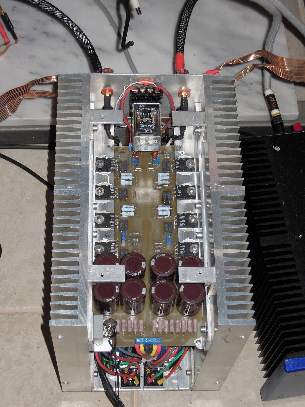

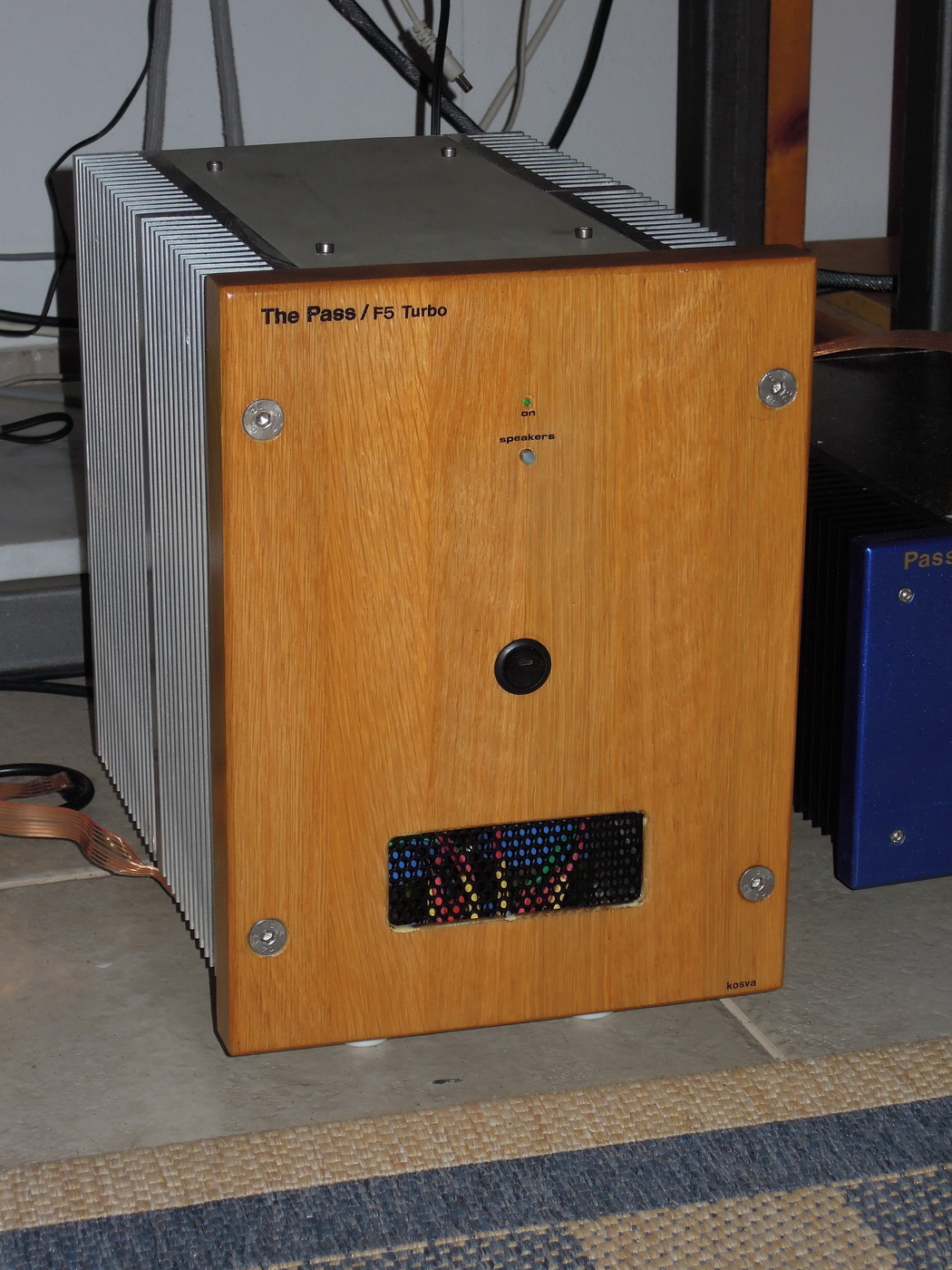

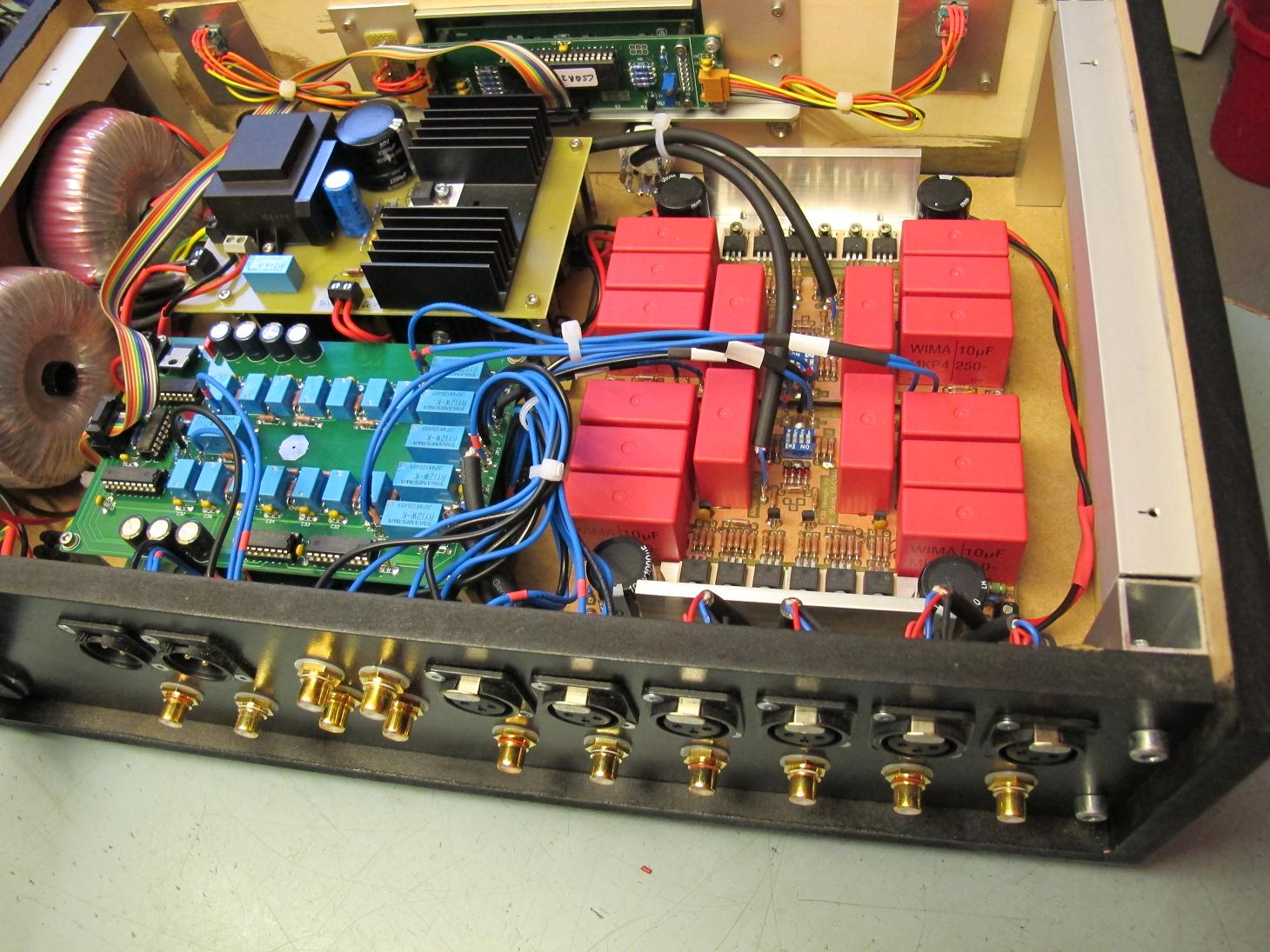

But three months ago I finished my new F5 Turbo V1, with two pairs of 2SJ201,2SK1530 per channel and two separate PSUs with 500 VA (2x25V AC) and 154mF capacitance per channel.This amp is builded in my old diy ALEPH 5 mono enclosure. The problem is that the temperature is rising to 59-60 Celcius with 20 C room temp at 0.7 A per device.It's a heater for the winter.
My next step will be to use one channel per one enclosure of my old Aleph 5.
The sound is perfect, more powerfull and I don't need a gain preamp any more for my room.
My CDplayer is a DIY PRO2 and the dac is a DIY also, 2xTDA1541a with the D1 unbalanced I/V output, both of them are working hard for many years.
Dear Nelson thank you again for sharing your knowledge with the diyaudio community.

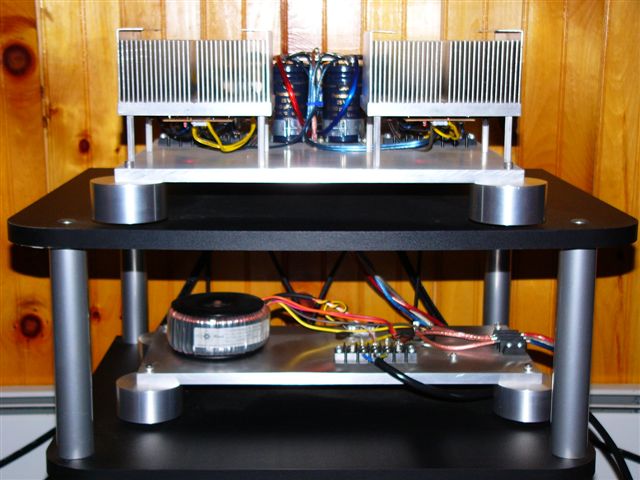

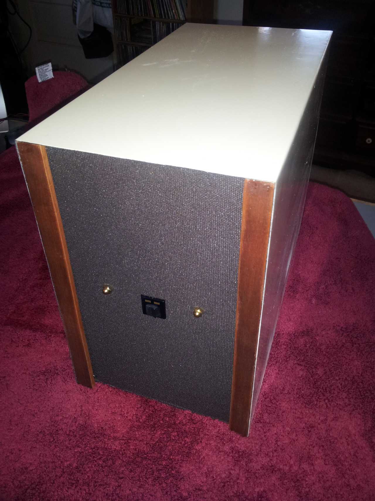

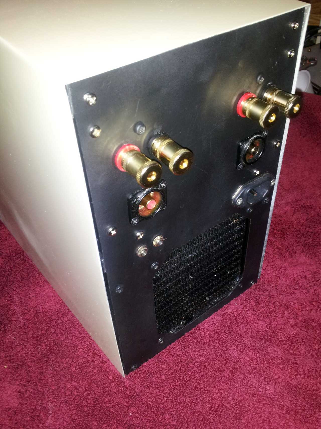

The latest version of a liquid cooled chassis for Pass and other "WARM" amps is almost complete.
For a pictorial build thread please use the following link. Please consider this a prototype that can be scaled up or down to cool anything from the tiny ACA to the biggest "House Heater"
Comment and suggestions welcomed. Hope you enjoy the approach

Hello Bcmbob
how much dissipation with this fan/radiator. enough for a turbo V3 ??
