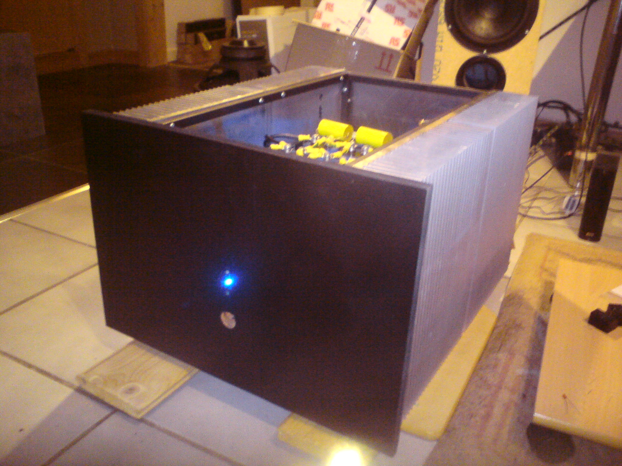

Sweet! Are your transistors staying cool?
Not as cool as I'd like: with about 205mV across the .47 ohm resistors, the heatsink is getting pretty hot: I have to be a bit determined to keep my fingers on for 5 seconds . I will do another round of adjustments now everything is wired up and I may take the bias down a fraction.
I used all the heatsink I had...
Tim, also keep a close eye on those in-rush limiters (thermistors). Depending on your amps operating condition, they can run very hot--and it looks as though you have them mounted on/near wood.....
Unless you're into the aromatherapy of burnt pine, this might be a problem....
You have 6 devices so the chip temperature is not likely to get too hot.

one of my Aleph2 monoblocks almost done. it is up and running.
and running some how cool about 18-20C above ambient
Very, very nice. Those large heat sinks are performing rather well, it seems.

Thanks: there's no sign of heat on the top: I didn't want to put my finger on them seeing as they are part of the power supply...
Now that I look at it, those sinks don't seem connected to ground.... BAD mmmmkay, all exposed conductive surfaces should be grounded.
Thanks for your concern. Actually I have run a grounding wire down through the bottom of the case and out to all the metalwork. Ohmmeter says it's all grounded.

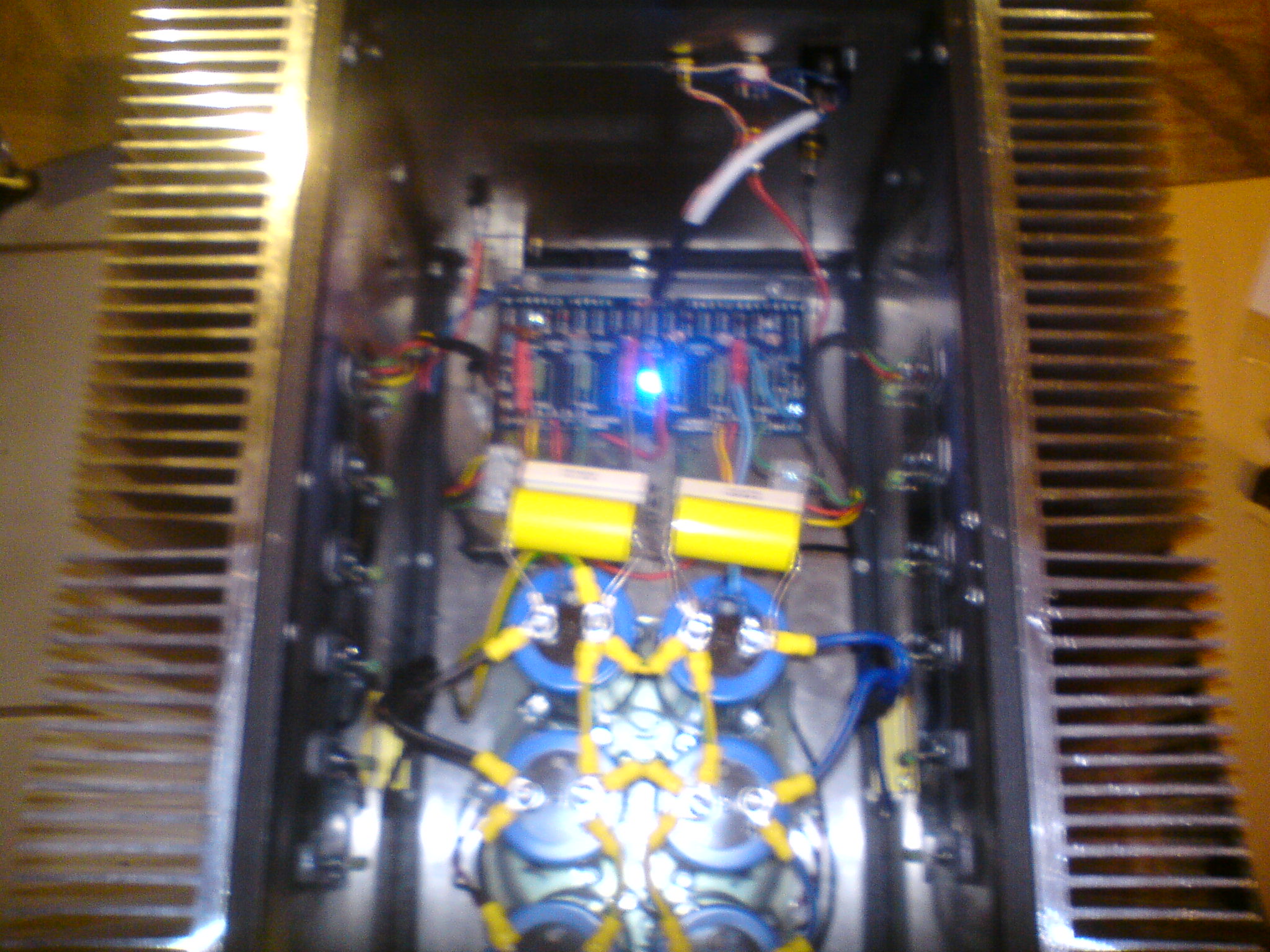

150 mU rail
CRCLRC + same small ones as Papa said
100 mU in the power suply
The 2 mono blocks have their own banks 50 mU rail (total of 40 10 mU caps)
At present I may ad another 50 mU rail if I go By amp or ballanced so each board got its own
And 36mU on the mains DC filter.

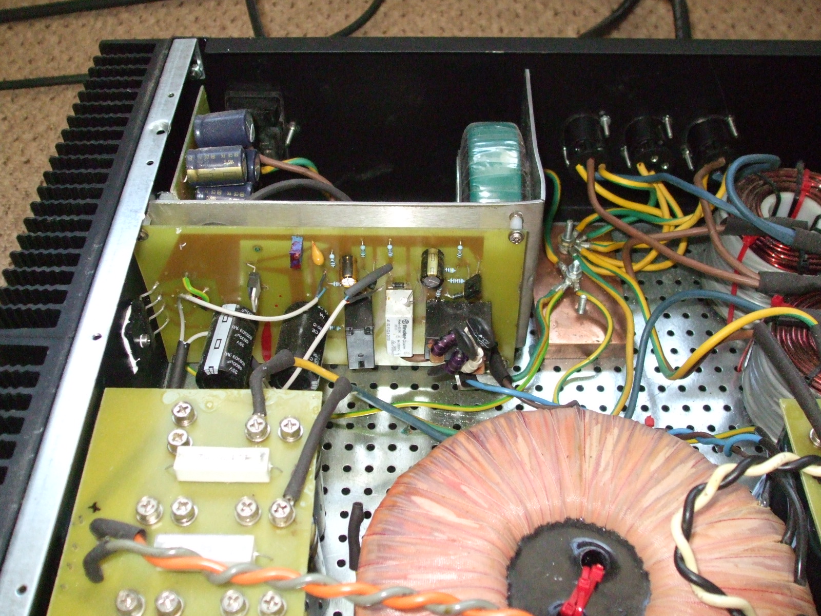

May I ask what you used for a soft-start circuit?
BigE
shure you can.
Simple transistor/relay timer.
once power up capacitor charges and trip a transistor which operate a relay that by pass the NTC
One day I will get it tidy and then post SCH for all.
Same pictures and more on my My F5 tread.
PIC Just a teaser in the corner the Aux suply and controll circuit.

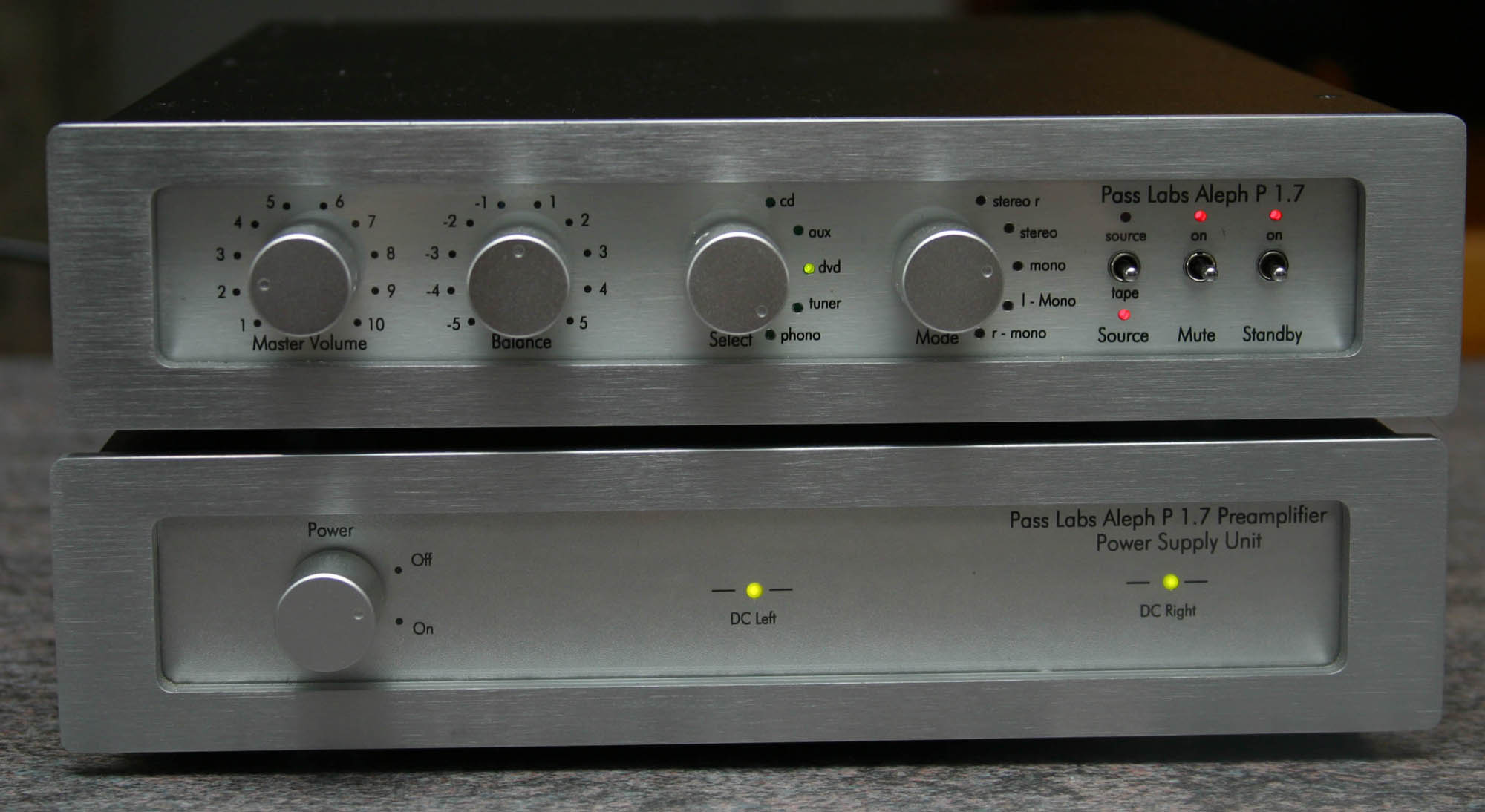

Hi all
I would like to share my latest creation, My just completed Pass Aleph P1.7
I was completed this afternoon, and has been running all day with background music
The matching Pass X-Ono, was completed some time ago. (see Post 262 and 263) of this thread.
Now to finish off my 1.2 power amplifiers. Quite a bit of work still required.
George

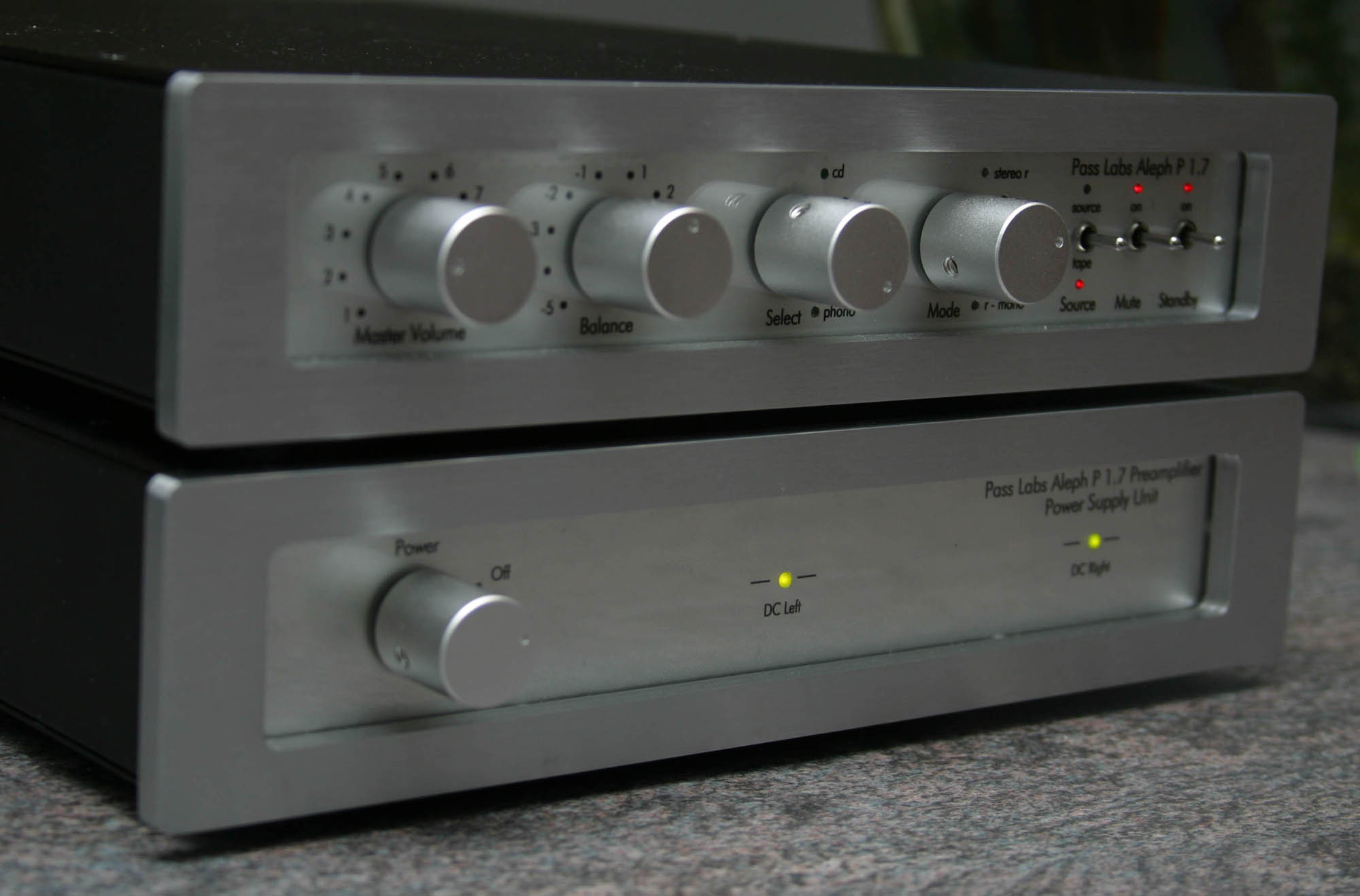

Hi Blistard and Jacco
Thanks for your kind words. You are correct in the Spectral look. That was exactly what I was trying to achieve.
The only thing remaining is to change the knobs on the x-ono, as shown in post 262 and 263 to match.

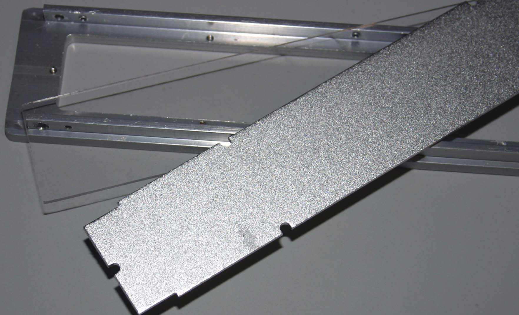

I would like to share how I made the front panell.
The case is an off the shelf unit from the VT4C shop in Hong Kong.
The front is a 2 part affair, with a removable sub panell.
I drew up the front lettering in AutoCad (could use any other package for that matter), and printed them on overhead transperency film.
I then got 2mm thick clear acrylic cut to size for me, and then sandwiched the lot together. There are fastening screws from the rear.
It gives the front a really nice depth
