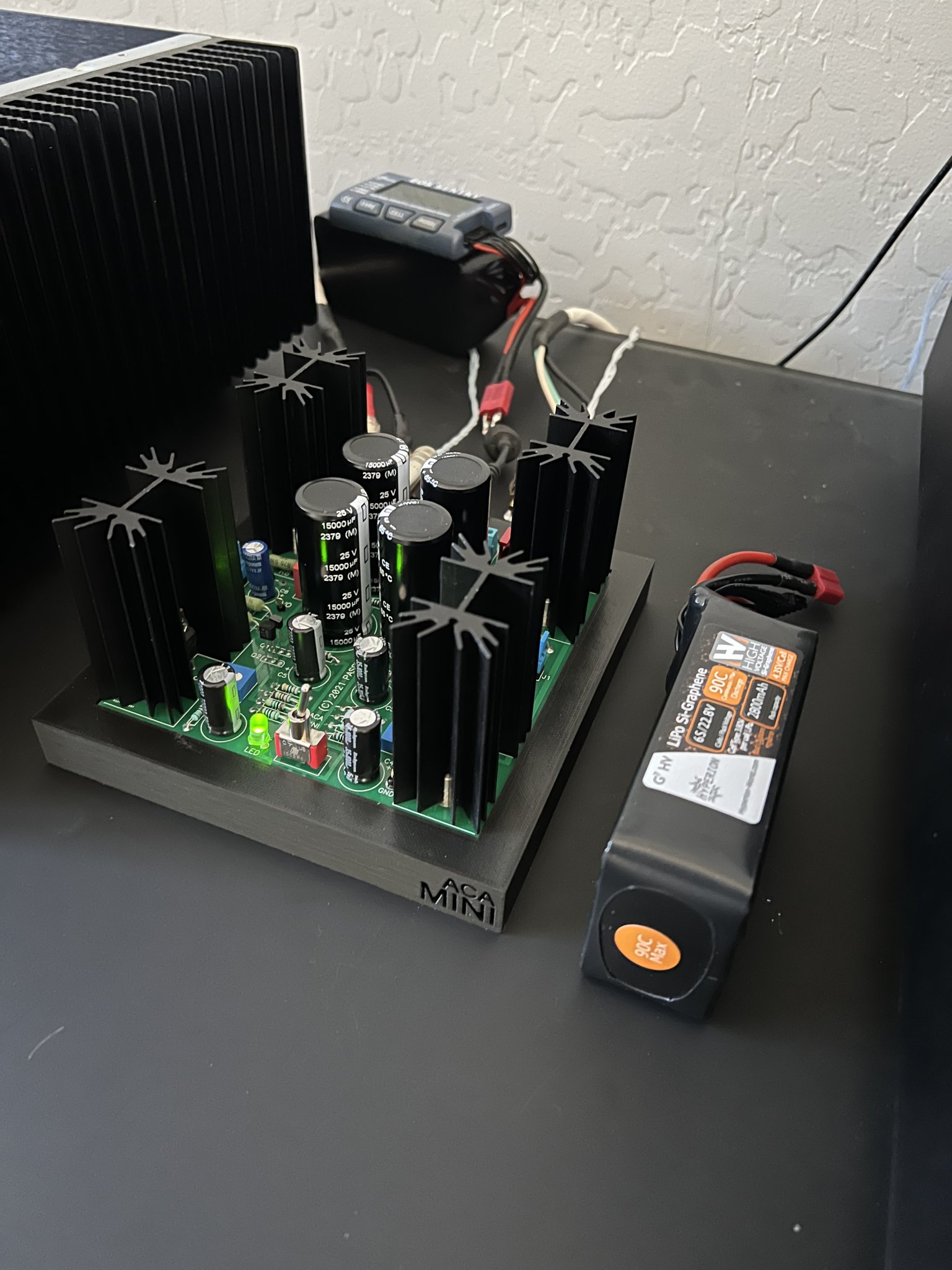

Here’s my ACA mini with 3d printed chassis and I’m powering it with a 6s lipo. Sounds amazing, and not just for the money.
:clown:
Reactions: 1 user
With 6s 2800 I’m running it for about 1 hour. Voltage drop with lipos is so linear that it’s not a problem and the bias isn’t changing. I’ve also got tons of 6s 3300s that I’m staring to use. So, two of those for an evening of listening.
Lipo powered this thing sounds really amazing. Easily as good as any of my Pass or tube amps.

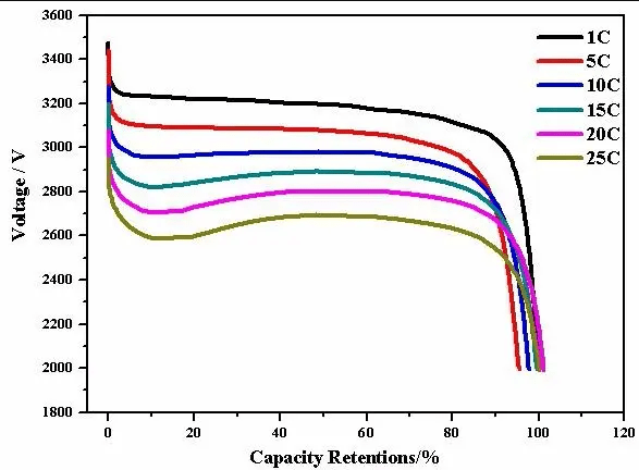

I'm running my M2 on LIFEPO4 and the discharge curve on said chemistry is FREAKISHLY FLAT! Nothing like the dead silence of a direct battery.

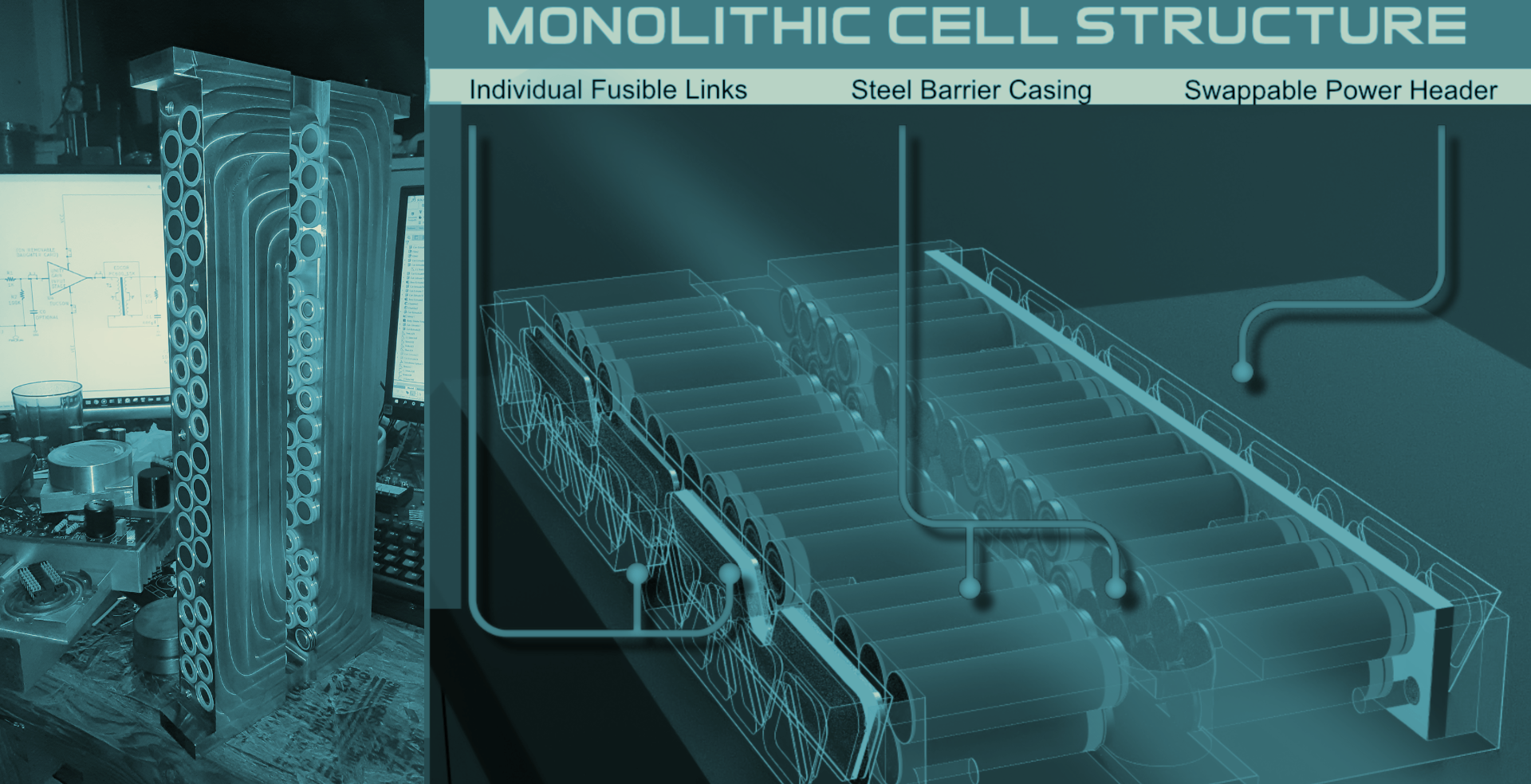

Your points on safety cannot be overstated. A dead short will frighteningly demonstrate the kind of power on tap. The other issue is a potential for catastrophic failures that occur independent of bad work habits. Nasa research on isolating thermal runaway is well established and I have my own spinoff of the strategy; burry can cells in a slab of aluminum, which will draw enough heat from a given runaway cell that a cascade is prevented. Safer chemistries are another practical method. LIFEPO4 happens to be quite resistant to runaway, and Lithium Titanate is practically impossible to initiate runaway. My batteries are in the 1-2kW range and a runaway battery that size is not something that can be easily extracted from a room. I'm also working on smaller monolith packs that are more akin to the packs you are running, albeit I use the 21700 form factor.
Here's current progress on a runaway resistant 1U 1kW chassis and a smaller 8s brick. For the smaller bricks I'm working out ways to do a hybrid where each can is separated by aluminum but the outer case is a high-temp engineering plastic. My goal is to make high-grade enclosures at different price points and going with polymers is key to that end:

Wow, those are really neat designs / ideas. I have never (to this date) had a battery failure or a runaway cell (even after hard crashes (in models!). The only time I have ever seen a failure has been when cells were over-volted by user error during charging (i.e. wrong number of cells selected).

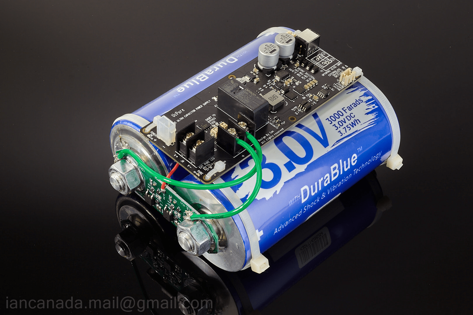

In the end, this is a hobby and you have to try new things. In this case it was a huge performance increase. What we really need is a charging and disconnect from the mains system like IanCanada’s LifePo4 setup.
