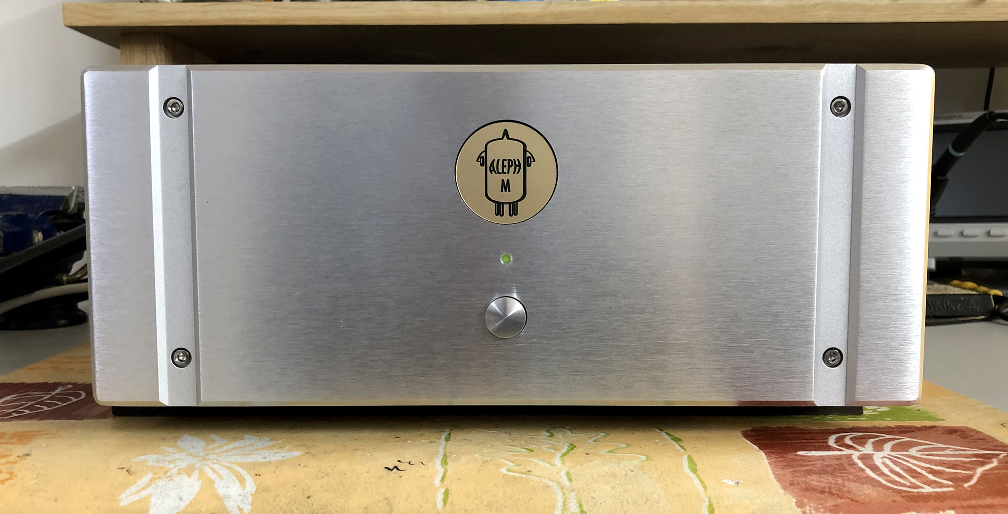

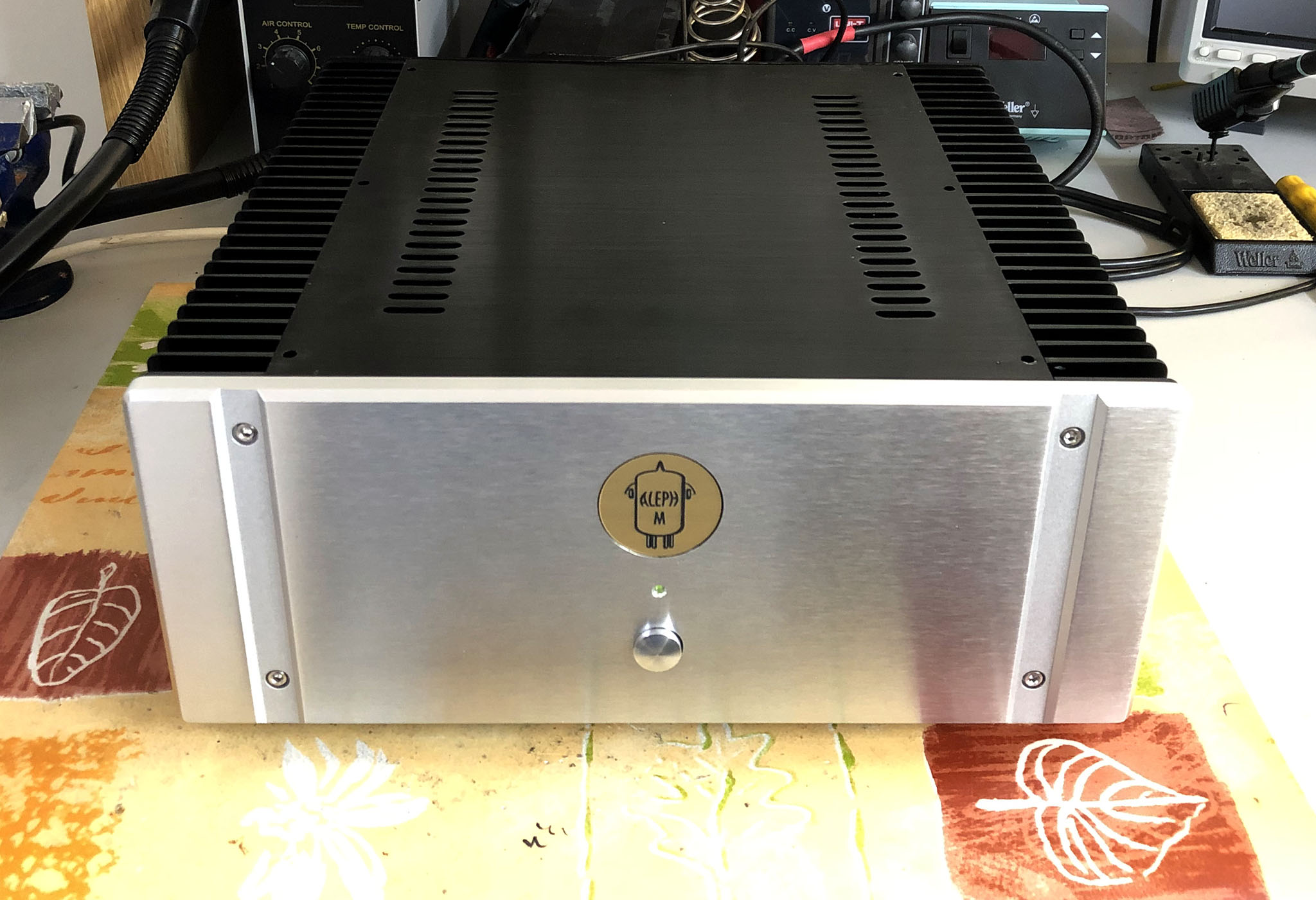

Hello,

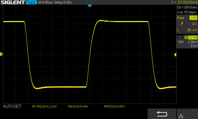

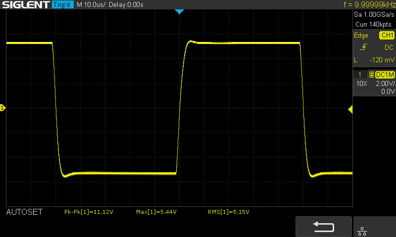

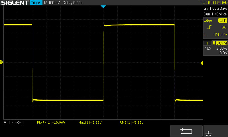

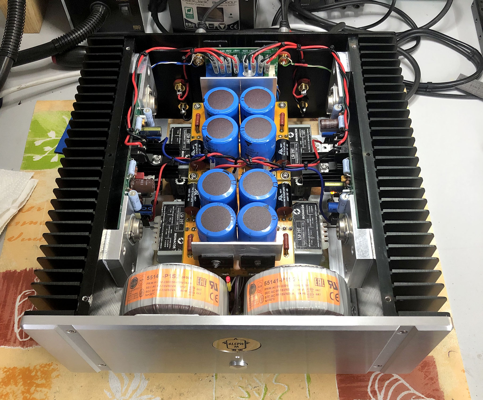

I present to you the PASS ALEPH Mini 2x15W that I built to celebrate the coming 10 years of the circuit.
It is built in double mono in CLRC (22KuF + 3.9mH + 0.47R + 22KuF) under 20v loaded with 1A of bias. The mosfets are IRF9620 and IFR250. I have sorted and paired all the components.

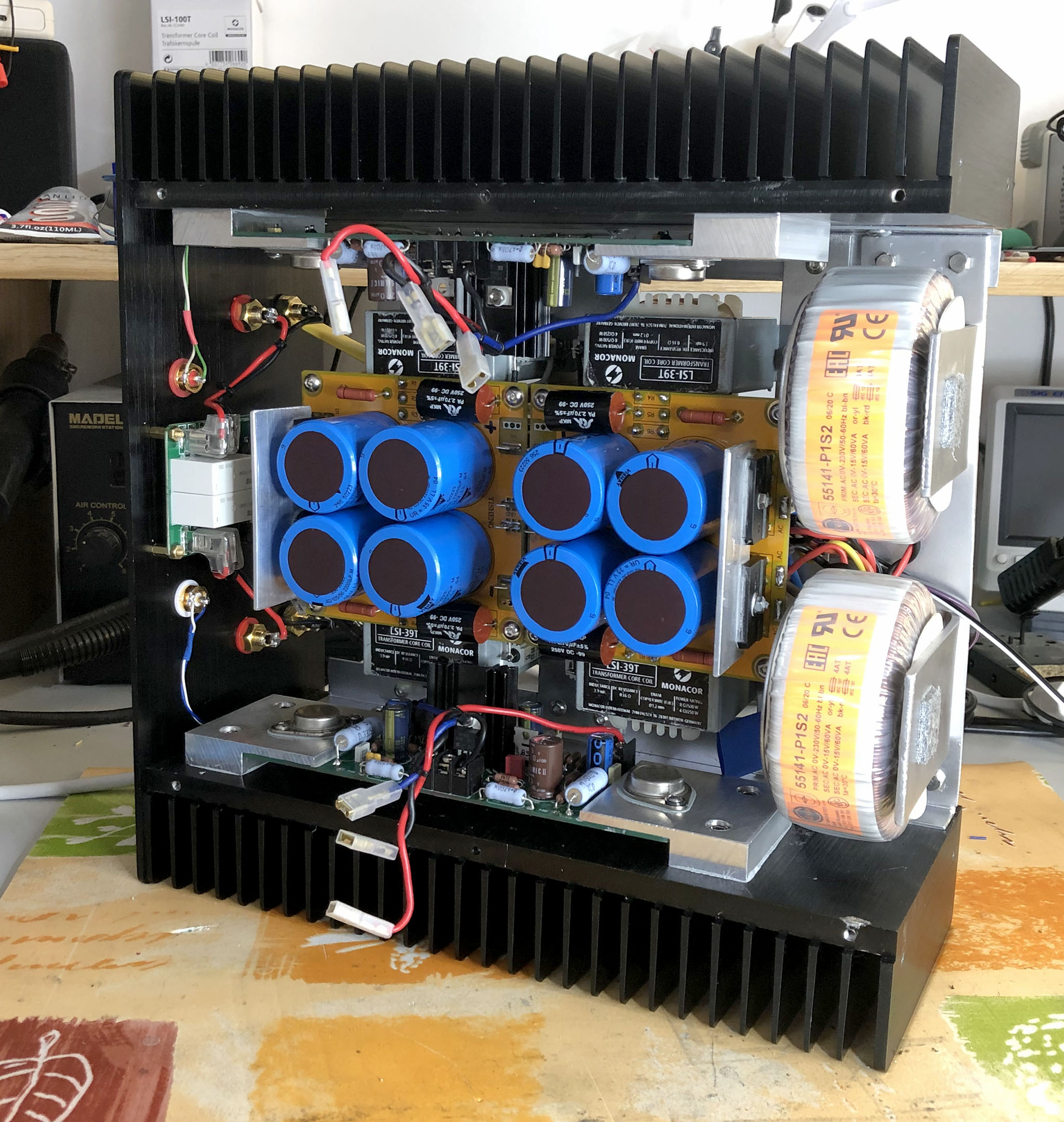

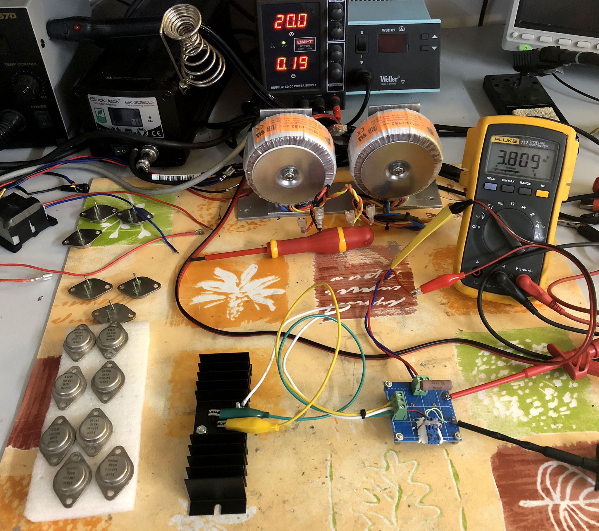

Hi!
The boards are from Ali but not the components.
A few more photos.
Below, there is a softstart. The most off-putting is the sort of mosfet. I also burned several IRF9620 (Q1). The amp does not support plugging or unplugging an RCA cable when it is powered on. Errors during test. When Q1 burnt, we got 20vDC at speaker output. Need of a secure and high voltage speaker protection module. The white Chinese module directly burnt with 20v.

> The chassis is a very nice work from french audiophonics shiped from china.
So now they are openly importing and selling copied Pass cases in the EU !!!
Patrick
Yes, as i wrote, its an insulting nice copy
But what i like more and is more important to me then the front-appearence and the PASS-lookalike, it is the metallwork and the heatsinks. This clone is how a chassis should look like for such pricerange. I am sorry to say but this "italian deal" is a no deal for me.

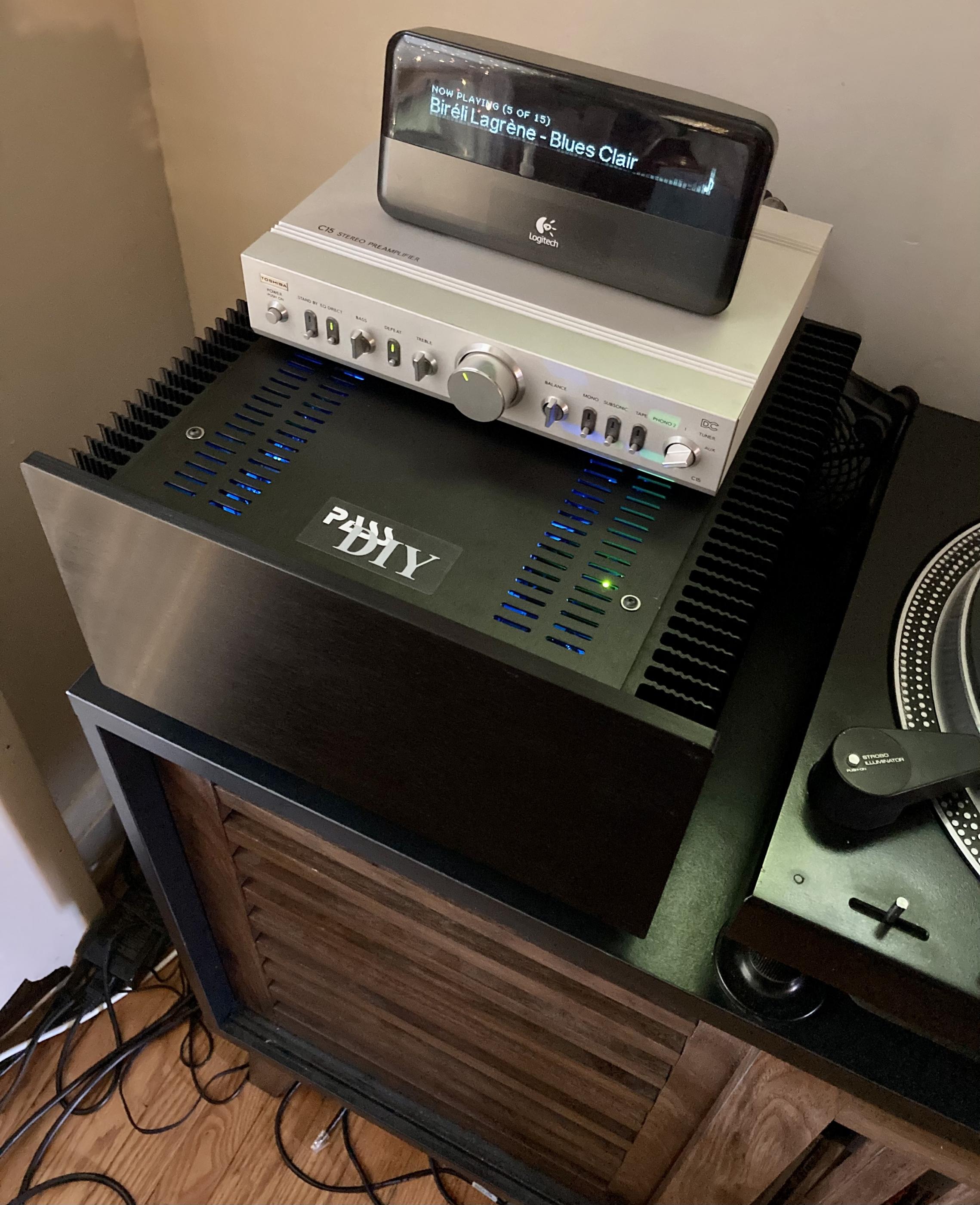

@elven ears,
Amazing build and execution, I love the custom organization of your wirings and custom extrusions you placed on the heatsink for the F5 boards. Beautiful work.
My build is much more rudimentary but I do use an 800VA Toroidy with (4) 20V secondaries for ease of wiring and nearly a dual mono setup.

Poseidonsvoice
congrats to this beautyfull amp, lots of nice goodies build in. I need to check these neurochrome parts - interesting. The J Boards look very nice!
Oh allmost forgot: VERY nice transformer !! Did you import this from Poland?
Good job on the cables!

elvenears,
Yes, the Toroidy is from Poland. It's an 800VA with quad 20V secondaries. A little expensive (~ 250 euros) but silent as a mouse.
Neurochrome Guardian-86 gives me insurance, and it does not affect the sonics and it does not affect the THD/IMD measurements at all. So it's a win, win for me. The THAT::RX Mono receiver board (discontinued) uses the THAT1200 chip and is very transparent sounding, better than amorphous core Lundahl transformers in my experience. Other options include AMB α24, XRK's BTSB board which can provide gain too if needed. Neurochrome also sells the universal buffer board which is very similar but also extremely transparent to boot (as his measurements show). All are excellent honestly for Pass related projects. As diy'ers, we can pick and choose based on budget, build quality, etc...our amps will always be the best! Hooray!

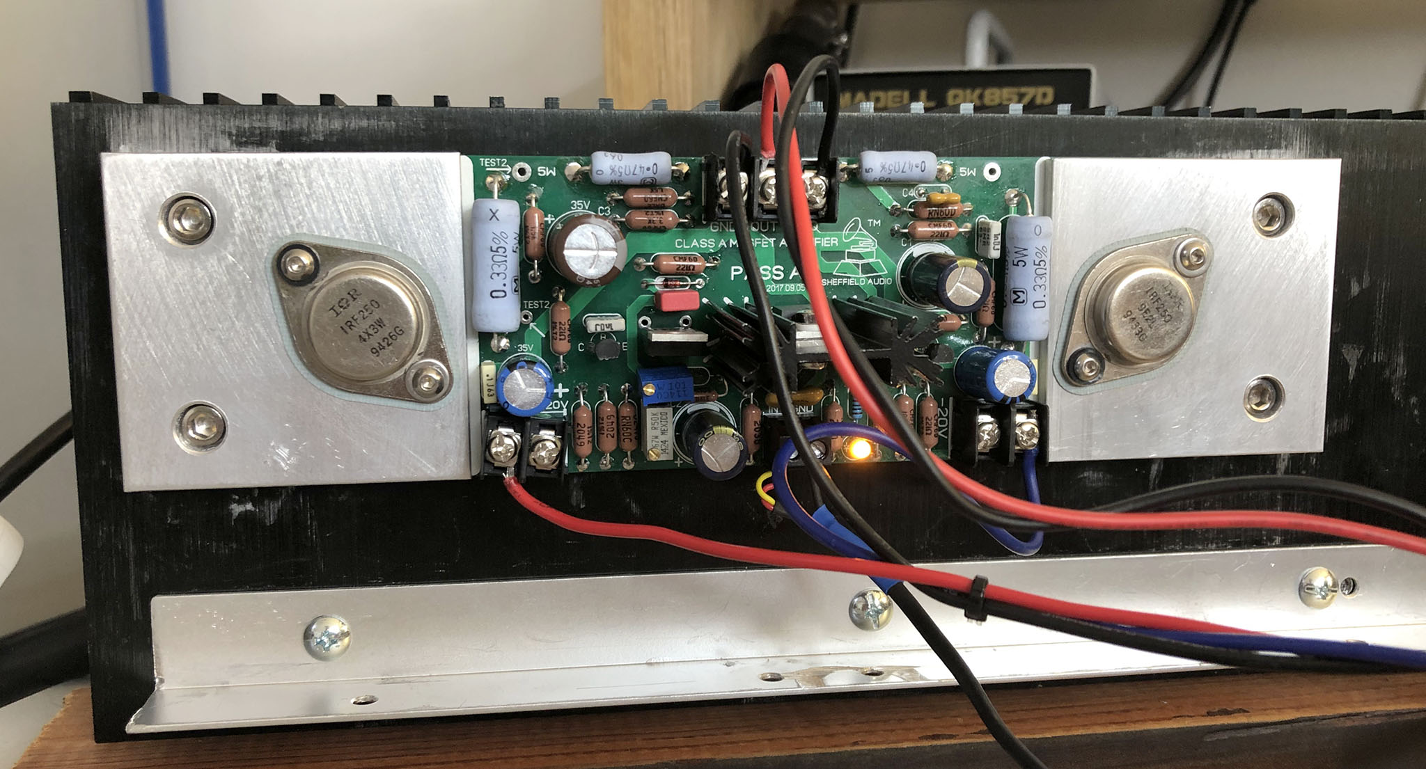

Hello,
