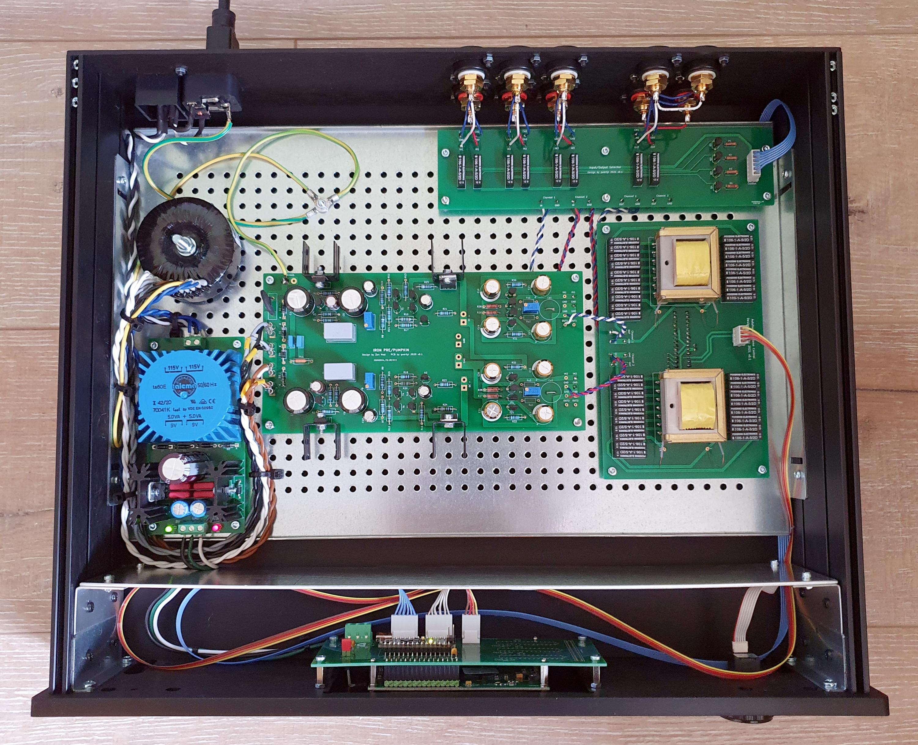

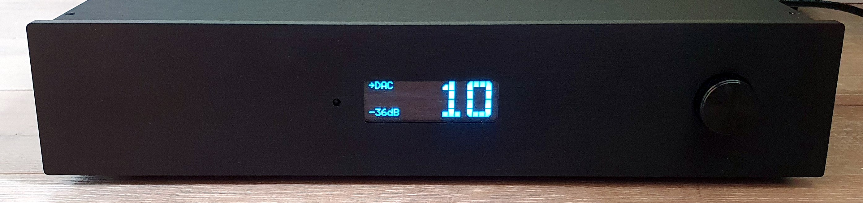

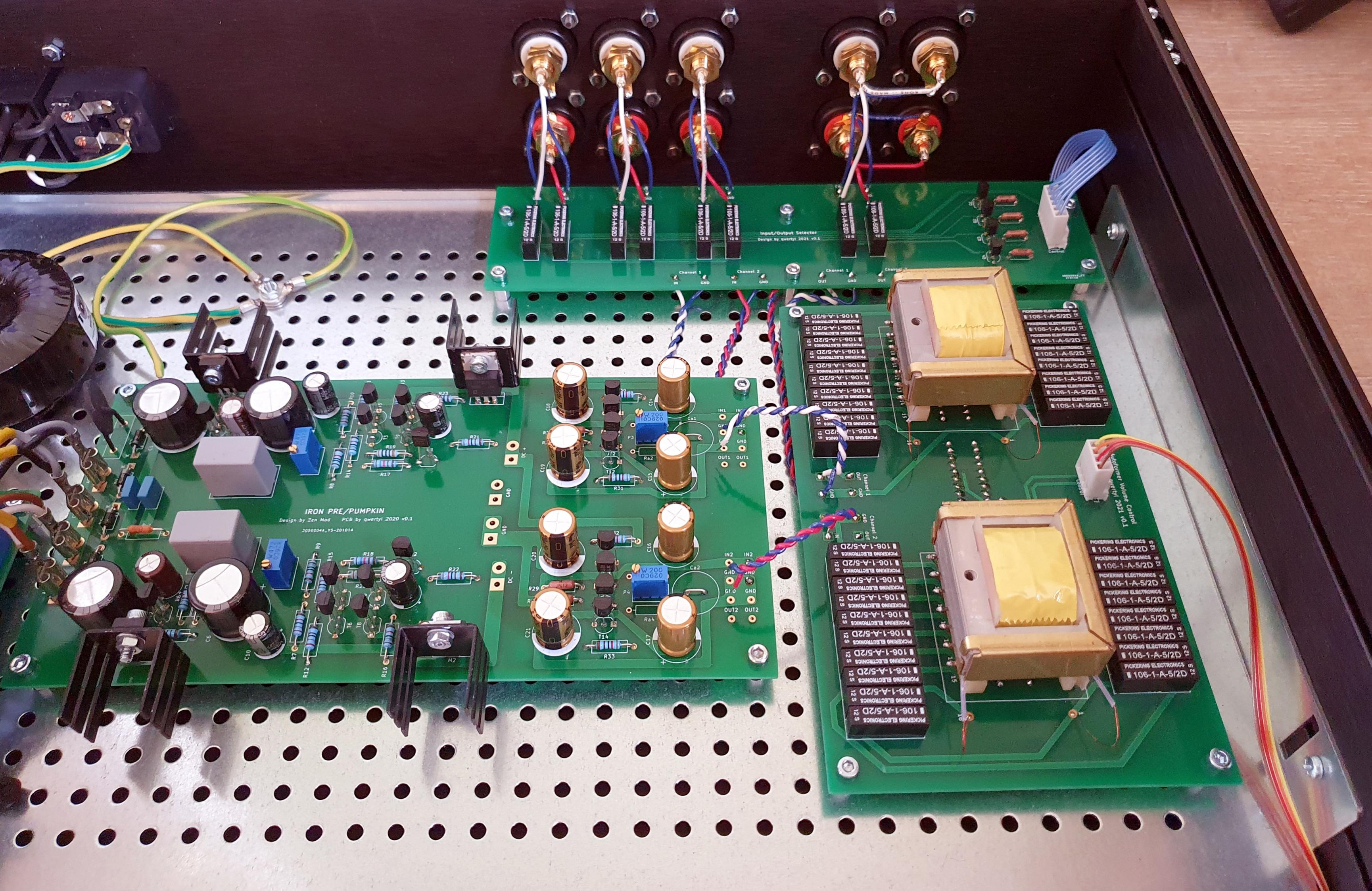

My take on Iron Pre/
View attachment 954617 View attachment 954618
View attachment 954619 View attachment 954621
More info and photos here

At the moment I can only confirm that it plays music Haven't done any serious listening yet.
I have some strange issue with OLED display - sometimes after powering on it displays rubbish and I have to reset Arduino to make it behave correctly. Not sure whether it is hardware or software issue...

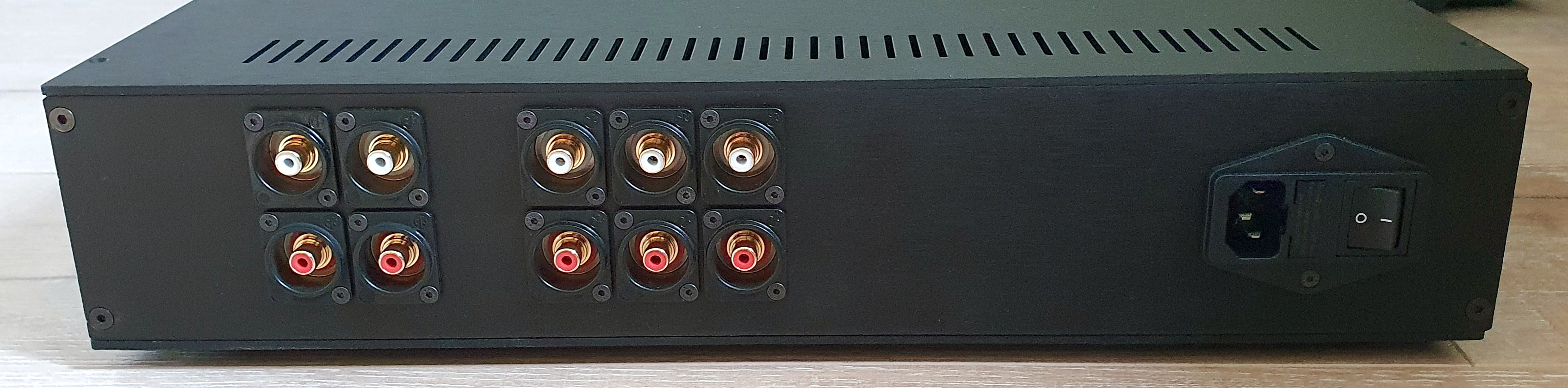

What brand RCA sockets are those? Love the look of the black flat head machine screws holding them.
Nash
Make sure you have defined the correct reset pin in your code.
It took me some time to realise this in my ESS9018S HiFiduino with OLED.
Beautiful work Qwertyl!
Nash
It is Neutrik:
NF2D-B-2 Neutrik | Mouser United Kingdom
NF2D-B-9 Neutrik | Mouser United Kingdom
What do you mean? I don't think I have defined reset pin in my code at all...
My OLED has a reset pin. It needs to be connected to one of Arduino pins.
You have to make sure that when you initialise the display you pass the correct pin to the initialisation routine.
I have failed to do this initially. In that case the display behaves a bit randomly at startup (ie sometimes it manages to initialise properly sometimes not and then displays rubbish)
In my case (but you need to check syntax for your libs)
#define I2C_ADDRESS 0x3C
// Define proper RST_PIN if required.
#define RST_PIN 4
void setup() {
#if RST_PIN >= 0
display.begin(&Adafruit128x64, I2C_ADDRESS, RST_PIN);
#else // RST_PIN >= 0
display.begin(&Adafruit128x64, I2C_ADDRESS);
#endif // RST_PIN >= 0
By all means google a bit first. I remember having issues with that until trying the above. It might depend on your OLED but I would assume they are all pretty similar.
Which library do you use btw? I like big characters like on a LCD 20x4.
Thanks. I use this OLED: NHD-0420DZW-AB5 Newhaven Display | Mouser United Kingdom with serial interface.
I don't think that it has a reset pin. I downloaded OLED library from Newhaven Displays website.
