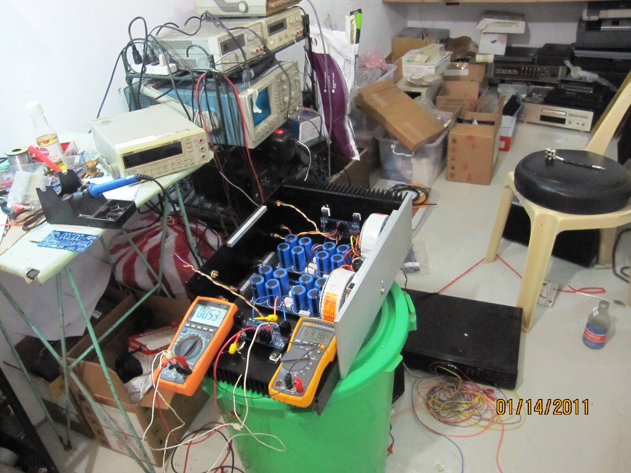

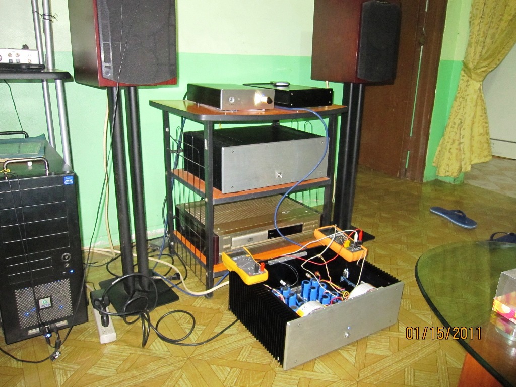

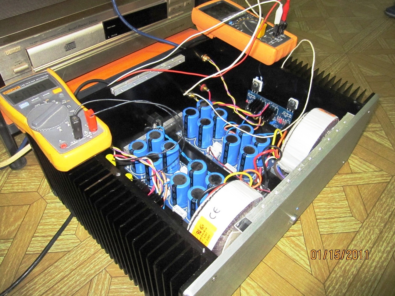

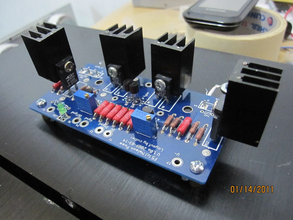

Hi Guys
I just completed F5 for a friend of mine.. I'm using Fairchild for outputs and without the thermistor.. it takes about 30mins for the bias to fully set..
Nuvotem 225VA and 4 x 27000uf/25V caps per channel.. DC offset is about 1-2mv.
Thanks NP..
regards from the Philippines.
