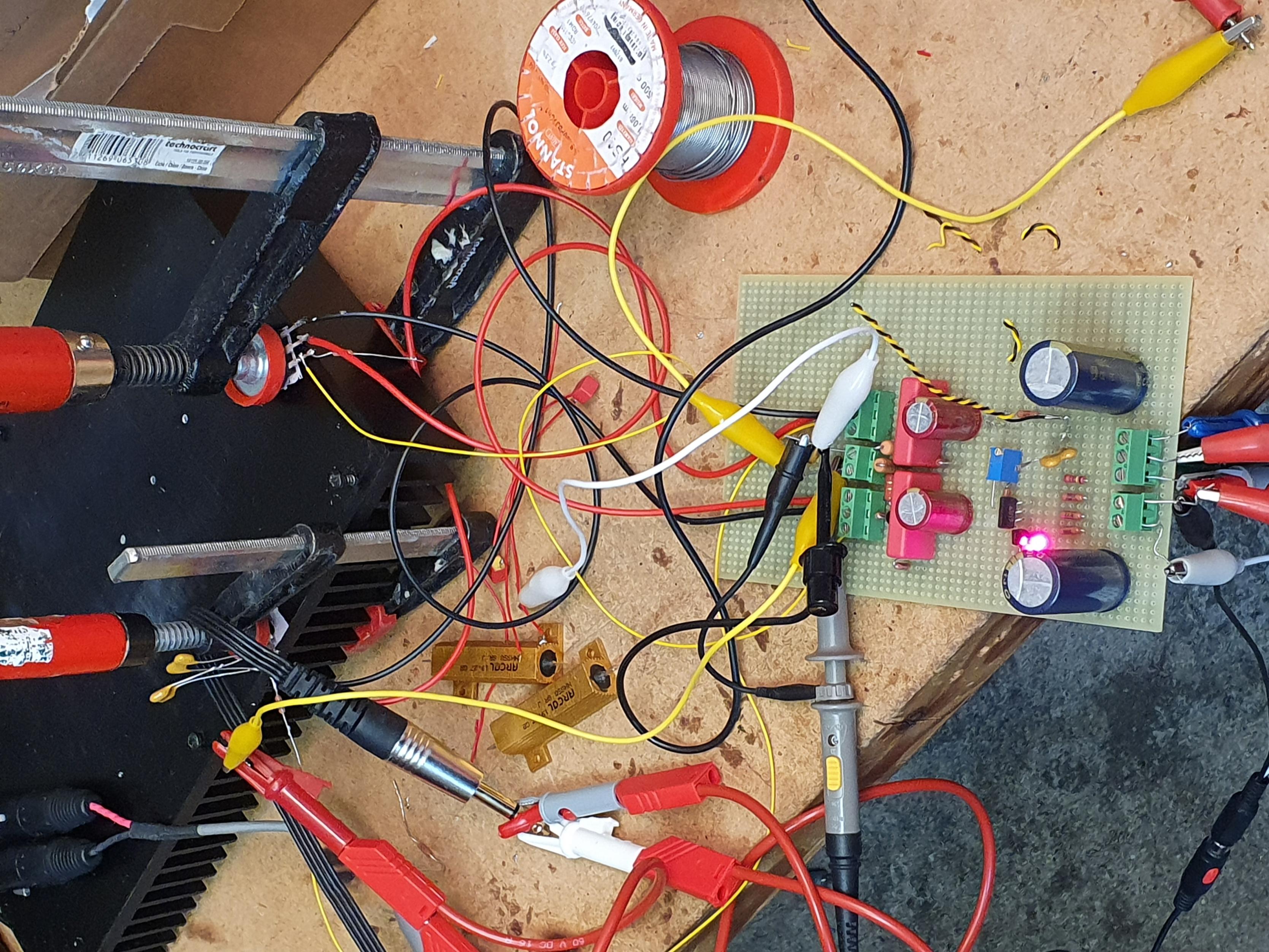

This is my latest Aleph J build. It's pretty ugly, but it works okay. It's for low-impedance headphones. It has a 2SK214 lateral FET as the gain device, and currently an IRFP150 in the Aleph current source (will change this to something smaller). Now I need to build the second channel... oh I hate perfboard!

Interesting. Don't those plastic clamp protectors melt?

Nah. I am running this at 300 mA, so there is not much heat involved. But I also use this clampling method for testing MOSFETs at high power, and the plastic never had any issues.

This afternoon I built the second channel. I simply made a careful copy of the Asian Spaghetti mess, and the thing worked right away! Phew... now I have to wait for some parts to make a decent power supply. I am planning for a fully dual-mono PSU using SMPS with big LCRC filters.

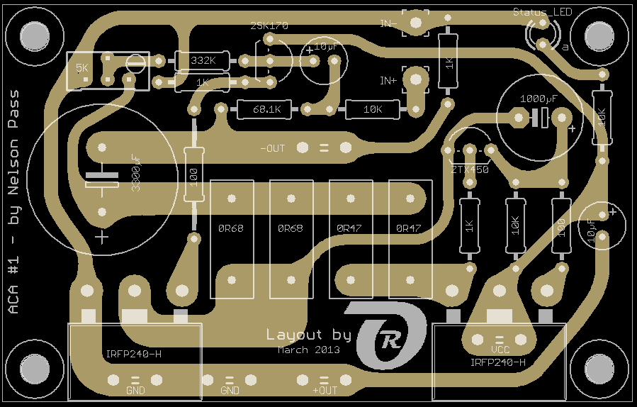

My measly attempt at a build. My first Pass build amplifier. I used what I had lying around. The boards were those by Rudy Ratlos here
338968d1364487212t-wtb-amp-camp-1-pcb-image1-png
