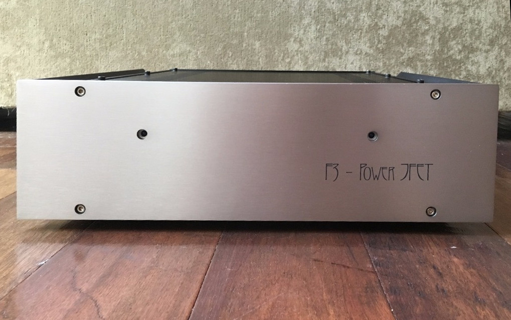

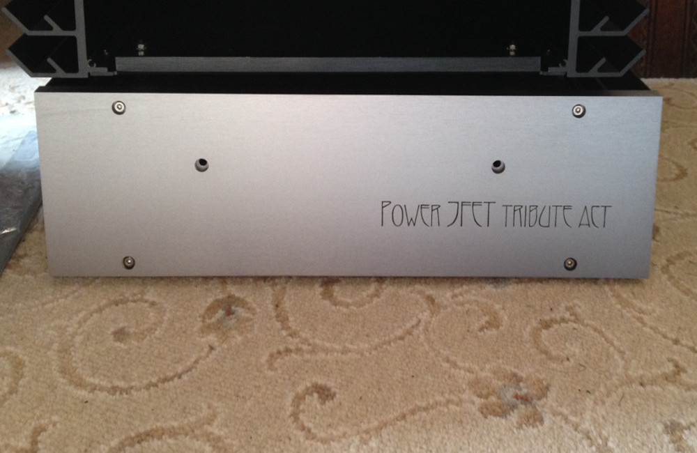

That might differentiate it for us "in the know", but it doesn't really do much for the common masses.
I'm also a sucker for the Firstwatt-style cases and aesthetics, so I like to make the distinction clear in other ways. (Example pictures attached; genuine F3 on wood floor; my clone on carpet.)
