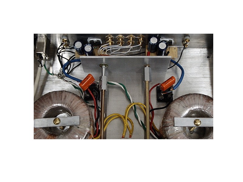

I have made a few changes since this pic but it is essentially the same. I am now using four discrete bridge rectifiers and added damping to the transformers. The chips and basic components are built on to protoboard using just the component leads. I really like this P2P layout and have used it several more times since.

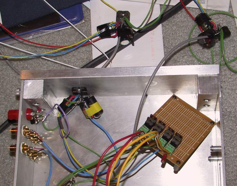

Here are my latest gainclones. I haven't yet finished the chassis wiring, as I am going to put the DipChip APOX IR1 inside it with with a volume control board.
I will get the wiring routed nicely once I get everything to go in the chassis finished.
I get no hum, and it sounds decent, but needs time to break in.
If you loose all those cables, it may sound better;) I didn't notice that breaking in makes so much difference with those amps. It either sounds good from the beginning or not. Are those Panasonic FC caps? For my budget oriented projects, I'm gonna try them too, together with Nichicons KZ.

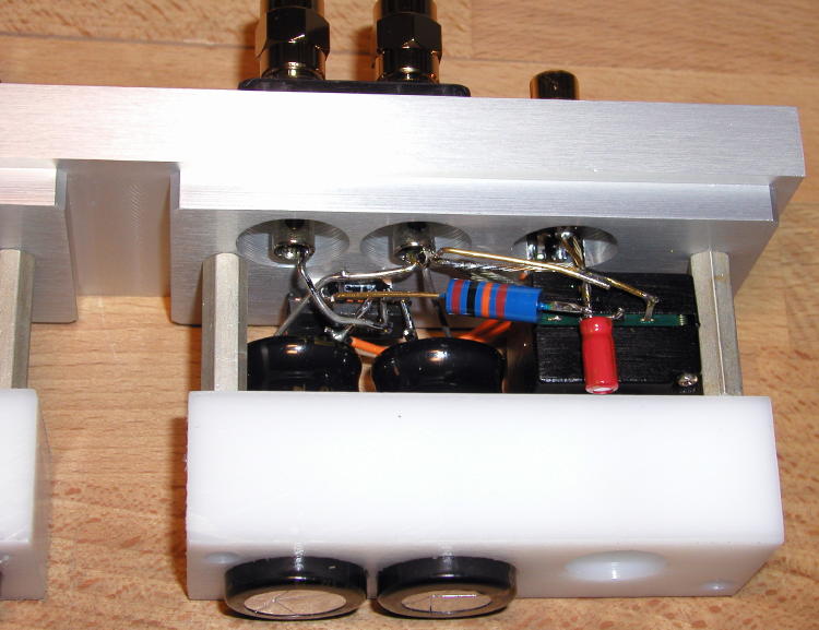

Just wondering where people have gotten the volume control extenders so that u don't have to have wire going all the way to the front of the case? Did you buy them or make them yourself?
I make mine from aluminium rod and the 'inards' of a terminal block as can be seen in the picture HERE
