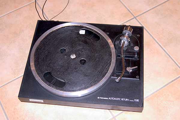

Just thought some may be interested in this modded early pioneer TT, a PL513X, here is the original TT and the next post is the modded one, it has roughly 50 mods in total and sounds really sweet.....total cost for TT including mods, cart and preamp..roughly $120.00 OZ dollars.
