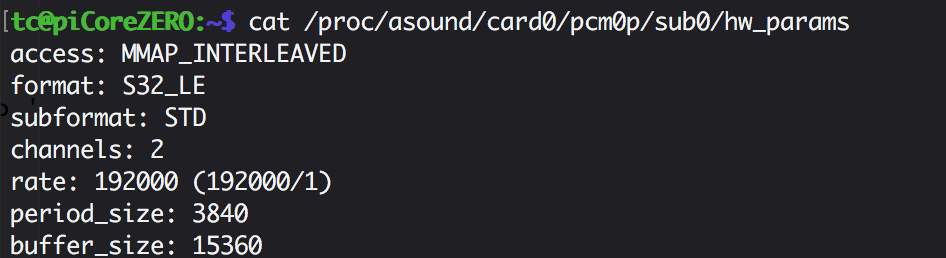

Activating mmap for I2S DACs
It's me again.
As mentioned before I recommend to activate mmap for I2S DACs.
For those who want to try it:
Below you'll find a little how-to.
You need to be able to ssh into PiCorePlayer as basic requirement.
The below commands toggle (activate or deactivate) i2s-mmap support.
First time they turn support on. Next time they turn it off.
Before you run the exercise make a BACKUP first!
After ssh login copy/paste below all in once:
Code:
sudo su

Enabled mmap. What does that do in this context? I understand memory mapped files etc...
