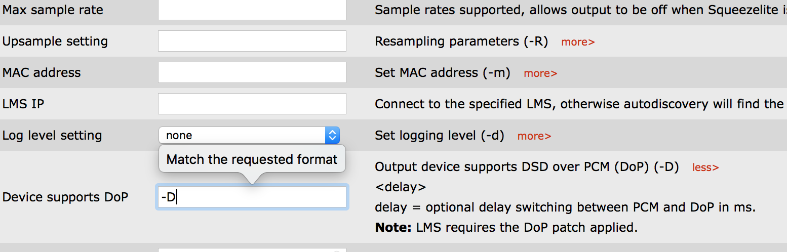

Can't save Squeezelite settings - "Match the requested format"
Hi Greg,
I have been using pcp v1.19 for quite a while on my Pi2 and everything runs like a dream. Thank you and the team's effort for developing such a great software!
I just bought a new Pi3 and tried the latest v3.22 pcp, but I am experiencing an issue that I can't save the Squeezelite settings if I put the "-D" as the "Device supports DoP" parameter, a "Match the requested format" pops up when I press the "save" button. (pls see the attached screen capture)
In my existing Pi2/pcp1.19, the same setting works fine. I tried to did some research on google but no luck.
Could you please advice what the issue could be? Thanks.
By the way, I tried both normal version and audio version, same issue.

hi Jackybrown,
You need to add a number not -D, the -D is added automatically.
Before you where effectively adding "-D -D".
As we develop the software we have been adding code to prevent incorrect input.
The "Various input" field is free format (I think).
regards
Thank you for your prompt response, that solves the problem!
Maybe for other newbie's benefit, just to clarify here:
If you don't put in any values in this parameter, LMS will convert the DSD file to PCM. But if you put in a number in, such as a "0", LMS will transmit the DSD file via DoP.
Again, thanks Greg! What's a wonderful software!

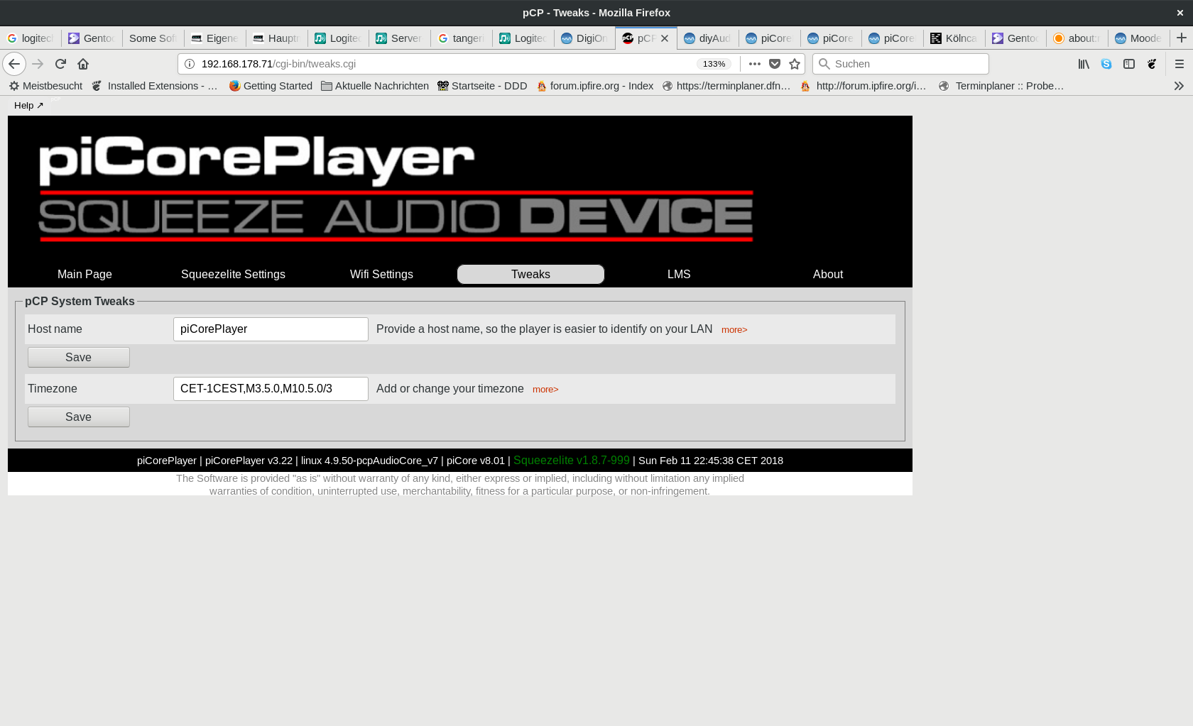

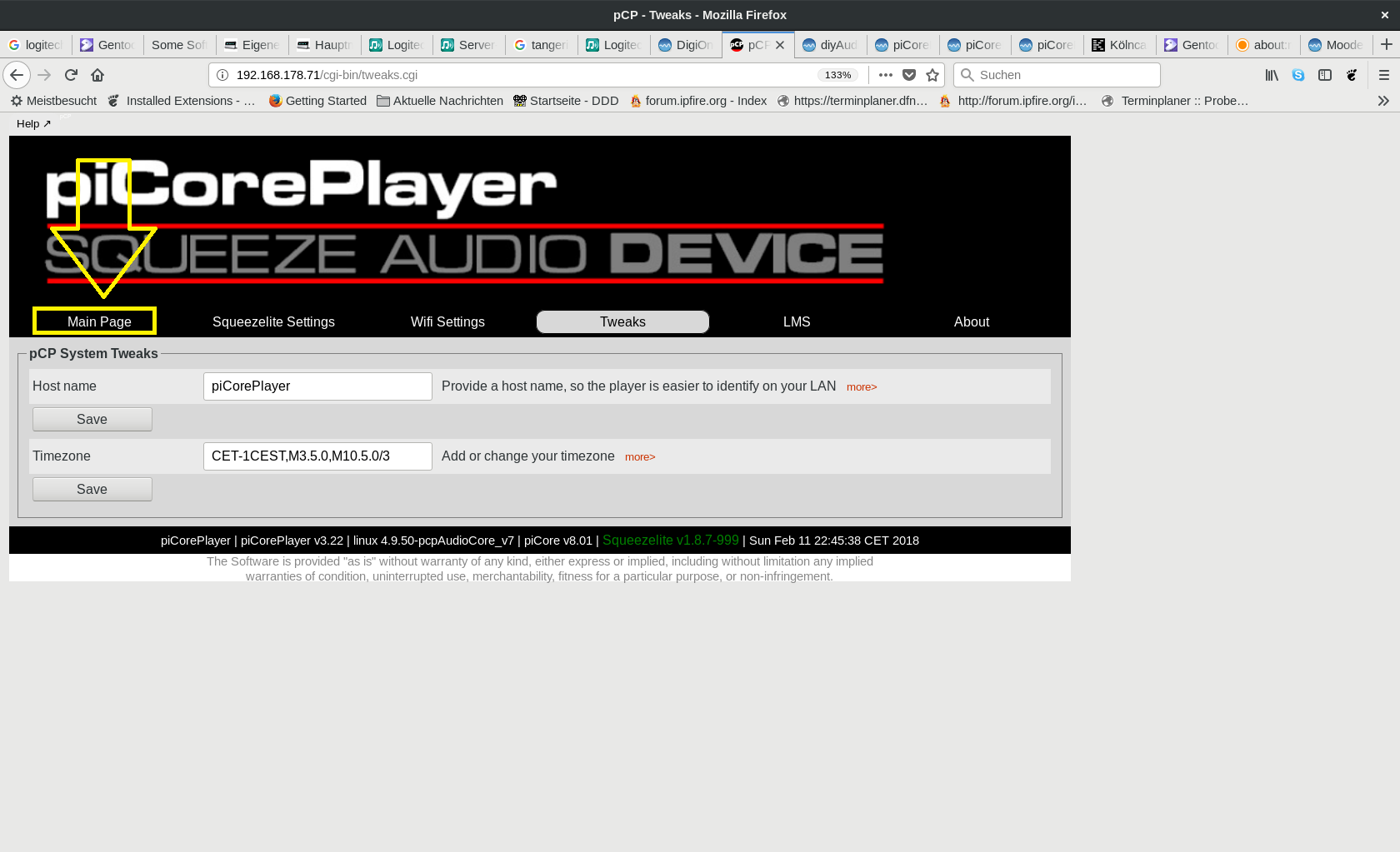

As can be seen from my screenshot, it does *not* show up.
I‘ve found the workaround to manually enter the adress /cgi-bin/main.cgi in my browser.
It‘s working as expected now.
You need to follow the advice provided by Greg. Select the "main" page, on this page choose "advanced" (tab at the bottom of the page)
Does the [ Main Page ] button not work?
It looked ok so far, but didn‘t display those ‚basic | normal | advanced | beta‘ - tabs. I looked in ~/www and tried several of the cgi-scripts until i got those tabs
Now it works as advertised, even after reboots
Or... just click on the [ Main Page ] button.
No, as i said, that didn‘t do it...
